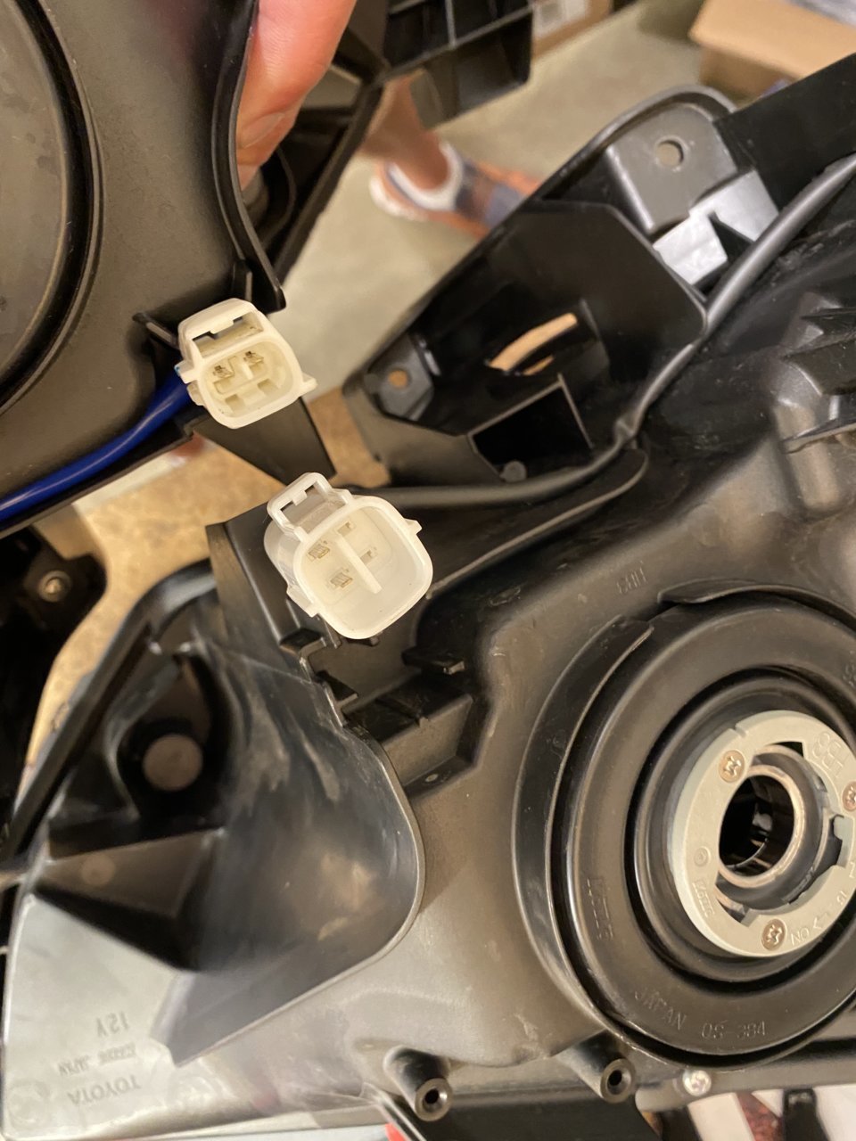

    Pretty sure they are a direct swap, at least for the low beam LED only units. I can check this evening. The T4R halogen low beam has an aux harness to connect to the bulb plug, since the bulb is fully enclosed inside the assembly. The harness then wraps under the assembly to a non-bulb style connector at the base of the assembly. I believe the low beam connector is the same regardless of halogen or LED. Unknown on the LED high beam units, since the halogen high beams have a standard 9005 connector directly to the bulb, which seems like it may be changed for the LED high beam.

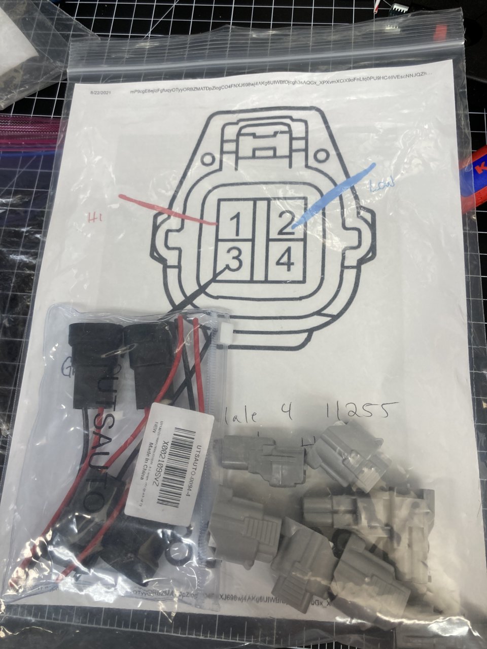

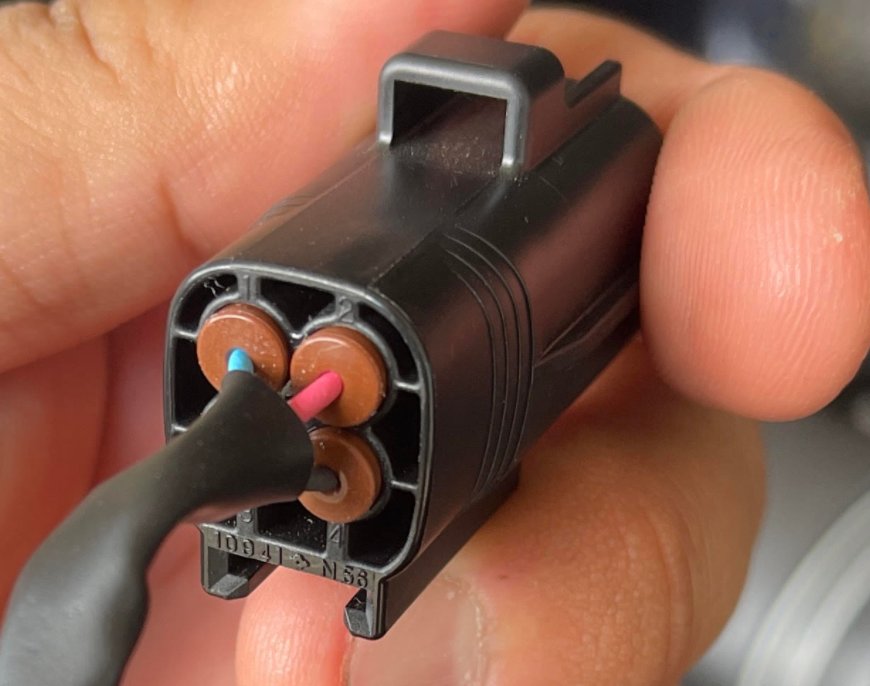

    From what I understand of trying to get this conversion harness going for the full LED T4R, vehicle harness high beam input via 9005 male, vehicle harness low beam input via the connector I don't have (also would be male, female shows as part number 11255) and then the headlights themselves are fed to a male 10941 (which happens to be a match to the 3rd gen Tacoma license plate intercept) via female which would be 10942. Now, none of this is tested and working yet so consider it 100% speculation at this point.

    Well, the halogen and LED low beam connectors are not the same on the 4Runner. The LED unit uses a larger connector with what I would speculate optionally has 4 pins to support an LED high beam, even though my units just have 2 pins (non led high beam). The halogen low beam connector only supports 2 pins.
    T4R halogen low beam plug top, LED plug bottom:

    @Spike Spiegel as of today I now believe I am in possession of 4 of each connector needed to transform T4R to OEM LED.
