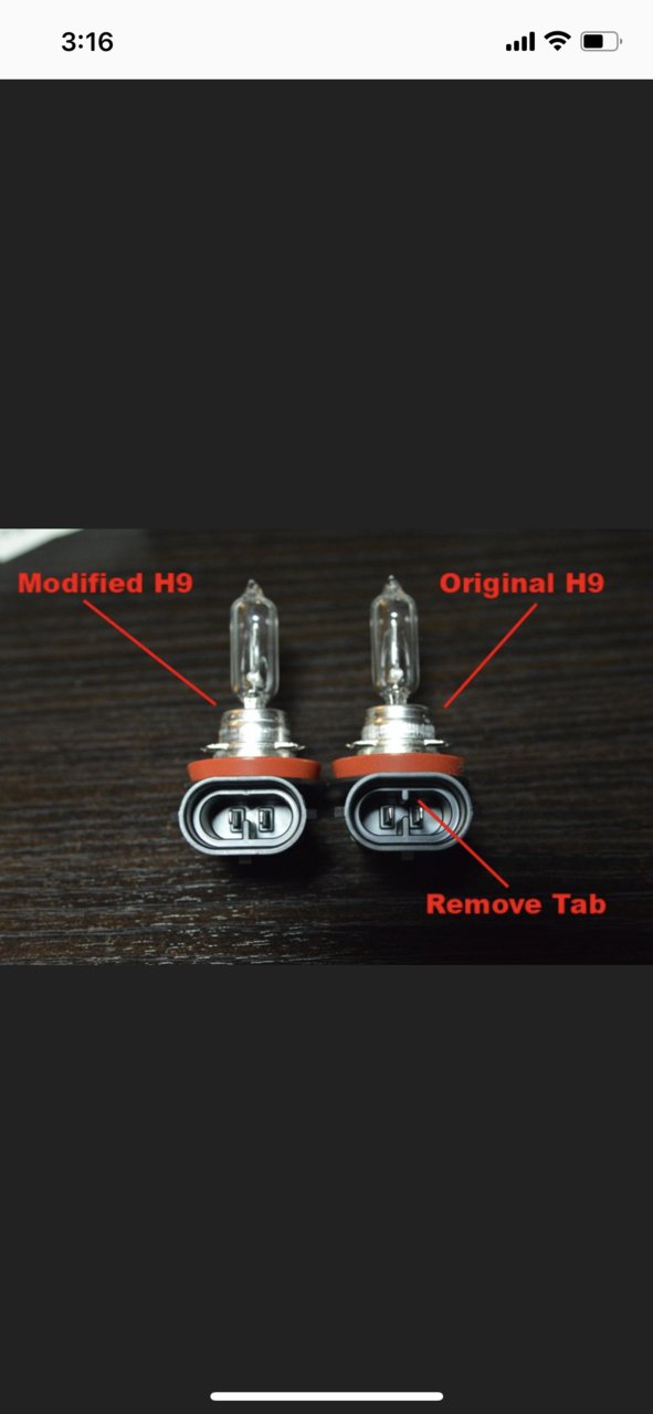

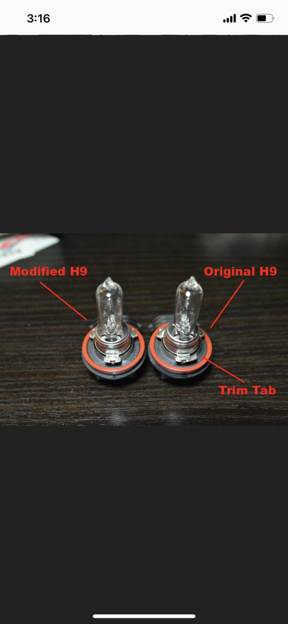

    I've been thinking of upgrading my head lights from the stock ones on my 2021 SR5.
    Driving around at night in the woods up here has been pretty iffy without high beams on the whole time. The fog lights help a bit, but I'd like to get some new bulbs.
    I'd like to stick with Halogen, and should I "match" up high beam or fog lights with any new bulbs I get? I'm not sure if that's been discussed in the thread yet - there are 250 pages so maybe I missed it!
    It's important to me that my different lights don't come out looking like wildly different colors or something.
    Can anyone recommend a good new higher performance low beam bulb that would fit in alongside the stock high beam and fog lights?
    Or is it not that important that all of the lights match up?

  18. Sep 19, 2021 at 3:39 PM

    Tom
    2021 Cement Tacoma SR5 DCLB
    Hmmm I dunno, I'm not a rocket scientist...lol
    Thanks though that's helpful, I was looking for a simple picture like that.

    Using the OEM high beam bulb (Philips H9) as a low beam bulb is the best performing option. They will of course then match. However there really isn't need to match the high beam color, even the slightly whiter performance bulbs are not going to be different enough in color to be distracting to the driver compared to the OEM high beam and it isn't like people will see the difference in color on the exterior of the truck. Modifications to the H9 were posted earlier, though the exterior metal color trimming is not required, but certainly makes install easier. And the internal plastic tab trimming can be worked around by removing the inner green plastic piece in your OEM wiring plug, allowing for H11 or H9. If looking for H11 plug and play, Tungsram Platinums or Tungsram Nighthawk Xenon +120 are the way to go.
