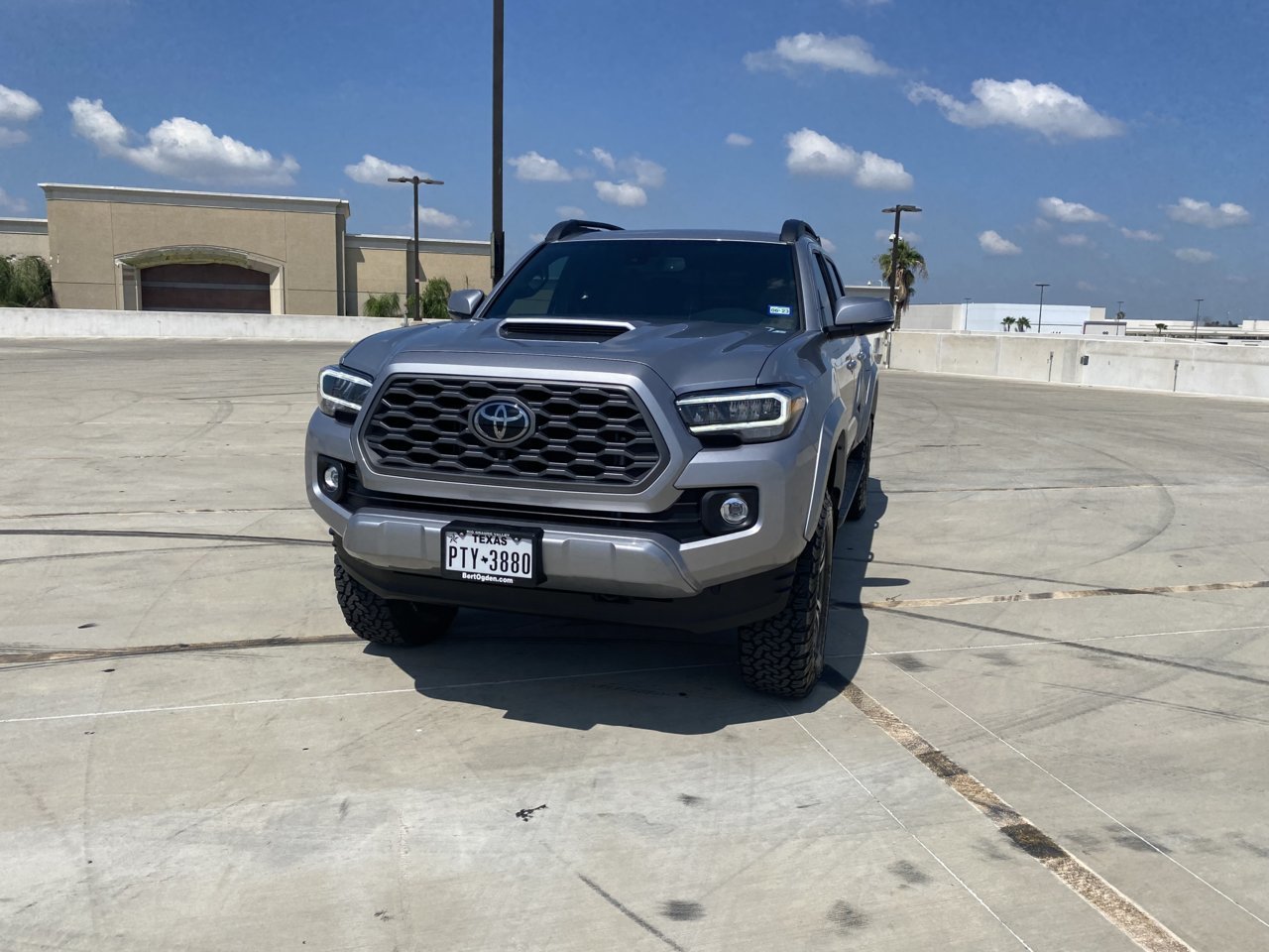

    Those are OEM LED Fogs but I removed the film today

    I realize, but if wanting yellow a proper SAE selective yellow unit will be far better than 6000k LED with laminex and even the Sport SS3s significantly outperform the OEM LED fogs.

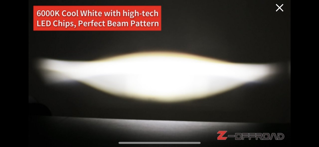

    Well I want the easy/cheap way and installed Innovited H11 HID kit (headlights) and Z-OFF-ROAD LED fogs. $100 all in and less than 1 hour of my time. The headlight output is (subjectively) twice as bright and the beam cutoff was retained. Very happy. I would have done full bore TRD LED housings but the figuring out how to make it work, given my SR5 doesn’t have factory LED daytime running lights, I chose the easy route.

    LOL, nevermind. Those are not compliant at all and more misleading Amazon China hot garbage. A fog needs a clear flat horizontal cut off. To aim those high enough to be useful would blind others, or you aim them down far enough they are useless to the sides, which is a fogs primary purpose. Either way the compliance claims are fraudulent and this is not a legal product, it is a very poorly designed garbage one that is easily outperformed by the stock fogs.

    Understood. I appreciate the feedback, and I did not know that about projectors (that the light could produce glare above the cutoff point). I did read this thread a bit (a lot, but we are on page 256….), and gave up. I will continue to read and determine what would be a better headlight setup. I did swap to H9’s prior to this, but the result was negligible. After being used to factory LED headlamps, halogens just seem like a candle taped to the front of the bumper. The foglights are not aimed high at all, the cutoff is not very visible while driving (low).
    Yes, I agree they are (likely, ok, truly) garbage (as far as quality). However, I needed to be able to see, and am driving in an area where there are virtually no cars with halogen headlamps (we are all blinding each other), there are multiple street lamps etc… I’ve gotten flashed a few times in my wife’s CTT, never (yet) in the truck. I probably would not have made this change if I drove out in less lit areas.
