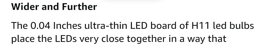

    Have to be careful to not fall for clever marketing. That LED isn’t 1mm thin, their PCB board is 1mm thin, with the LEDs stacked on either side of the board. The distance between emitter faces could easily be 3mm wide. The focus on thinner designs is certainly the right direction but it doesn’t give much confidence when the width of a sub-component is advertised vs the critical width of the finished component. Also zero chance of that product meeting it’s specs of 50w and 5000 lumens per bulb. And facepalm, did they really use a mirror finish on the bulb? ‍:facepalm:

    Sealight, which is very popular on Amazon does the same thing. I ordered a set last year and measured the emitters at 3.1mm. To be fair though they explicitly state "led board" in their listing.

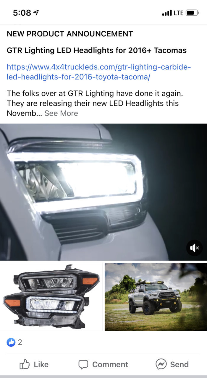

    Looks like GTR, aka Headlight Revolution, aka The Driven Lighting Group (same as Morimoto) is launching their own headlight line.
    https://lightwerkz.net/products/toy...MIxqnV6KGU8wIVgRx9Ch3dtwSiEAQYASABEgKsFPD_BwE

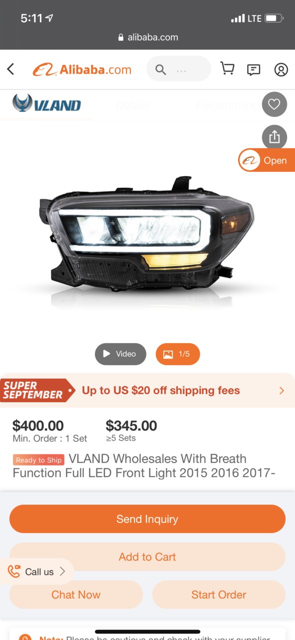

    Except they appear to be cheap Chinese Vland units sold at a big markup, like AlphaRex. They look similar to OEM, but OEM use 5 low beam emitters and 2 high beam, these use 3 and 1 respectively.
    https://m.alibaba.com/product/16001...a2499298462eb04b6763307ad05aT.jpg_200x200.jpg
    Edit: ^strange this link seems to change daily, almost as if it is designed not be be saved/shared.
    These specific Vland units were already tried on this forum and performance was terrible. I’ll dig up the link.
