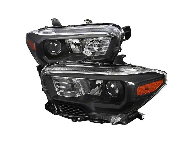

    Does anyone have any experience with these projector headlight replacements with a black housing? They’re said to improve lighting with standard bulbs. I like the look of the black housing but I don’t want to downgrade my stock ones just to get a black housing.
    https://www.extremeterrain.com/tacoma-projector-headlights-black-2lhp-tac16jm-go.html
    Quote from sales page:
    Increased Function and Style. Improve your Tacoma’s front end style while also increasing illumination with these Black Projector Headlights. These headlights feature a factory-inspired design with a modern all-black housing style to give your truck a sportier front end. Moreover, these headlight assemblies utilize specially designed projector lenses. These lenses produce more focused beams of light, helping improve vision when driving at night or in low light conditions.
    OE Style Lighting. These headlights are designed to reuse your truck’s factory halogen bulbs for both the high and low beams. This helps prevent any compatibility issues you may encounter when using different bulbs.

    Guaranteed to be a performance loss from stock, don’t fall for the marketing pitch. Price alone should be a great hint. If wanting a more blacked out appearance while retaining stock performance, check out the early 3rd Gen halogen TRD Pro assemblies.

    That’s exactly what I was afraid of. Thanks for the heads up. I’ll look into those early TRD pro assemblies.

    Hit up @no vtec 4me if you desire BHLM halogen assemblies for 3rd gen. Personally I'd go OEM LED but if you desire a darkened look, he has a pair of mine which can be sold to you for a reasonable price if you so desire.
