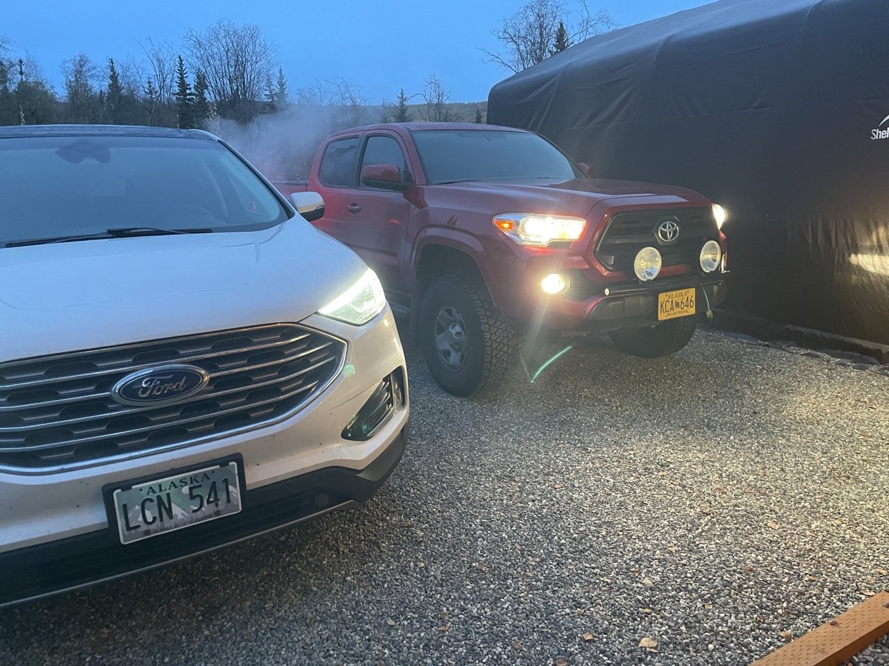

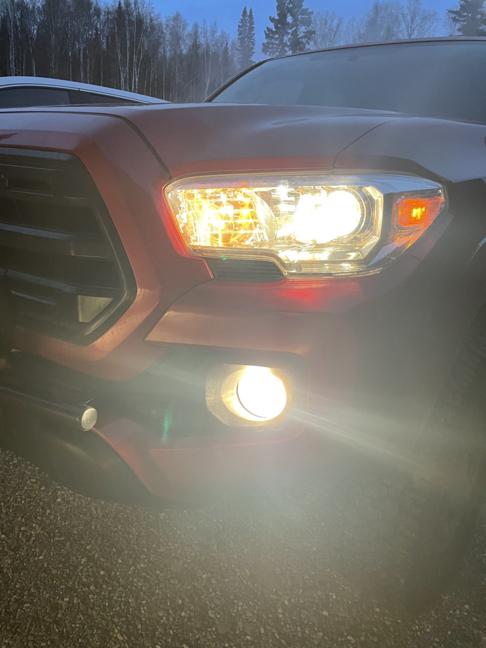

    Some color output shots of the tungsram platinum h11 lows and fogs; my wife’s Ford edge has LED headlights and side markers just the markers are on.
    97AF7A18-13FF-4A88-A2F1-93C06FB7D8E5.jpg 785C8AC5-7634-4982-A1DE-FCED37835582.jpg
    crashnburn80[OP] likes this.

    #254922
    723
    To be a bit more clear, Morimoto is a U.S. based marketing company with a Japanese sounding name, to impart the notion of quality, offering mostly poor to mediocre quality Chinese parts for the gullible, often using testing facilities they own to give them the approvals they want to tout in their marketing. There's a rhythm there, isn't there, sort of a downward spiral.
    Too Stroked and crashnburn80[OP] like this.
  11. Sep 30, 2021 at 9:31 AM
    #5191
    Sasquatchian
    Sasquatchian Well-Known Member
    May 30, 2018
    #254922
    723
    Great example of why most comparative photos don't really compare much. If you had exposure with detail in all the lights in the image, then you'd have one type of comparable reference but when all the "whites" in the image are blown out to 255Red, 255Green and 255Blue, they all appear to be the same color - specular white. Speculars are generally small areas of totally clipped, blown out details that would have had color and tonality if they hadn't been clipped. Next time shoot raw files using manual exposure with the exposure set to maintain detail - shoot for around a 245R, 245G and 245B for a neutral white with detail and let everything else fall where it may. And yes, there are inexpensive apps like Halide and Manual Camera to let you do that with any smart phone. Also let you manually focus as well if you want or need to.
