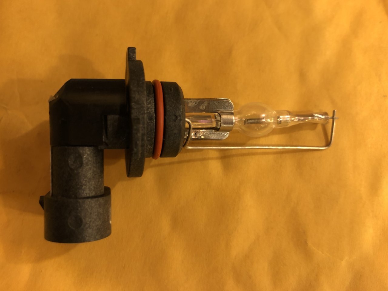

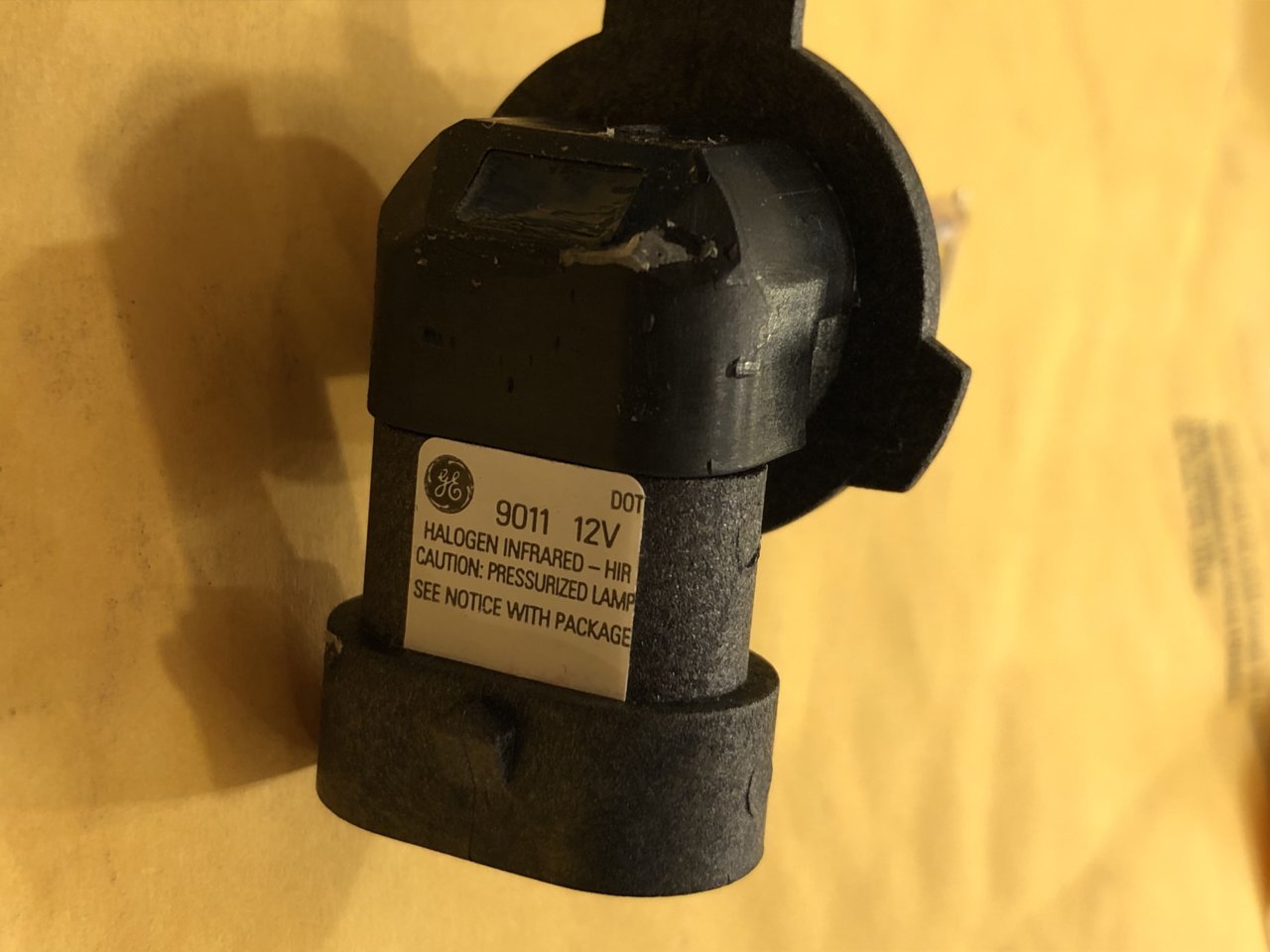

    Does bulb shape play any role? The Toshiba’s look is so distinctive.

    The earlier bulbs seemed to favor a domed bowl around the filament. Here is one of the first HIRs by GE I used to have. Note the domed globe around the filament. I'd speculate this was to optimally reflect the IR back directly at the filament, which may not occur from all angles with a parallel reflective surface in a standard style bulb. However the data shows the new Korean Osram design performance is superior.
    F6CCC8E8-75DB-4959-A8AF-4E1C9AC6D0A5_1_201_a.jpg 2DD5F77C-BA58-4F9C-B991-183AB6983AA2_1_201_a.jpg
