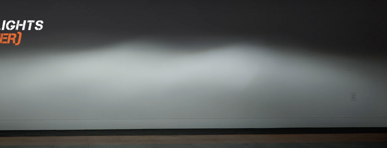

    I feel the brain cells dying off in mass watching that video. That cheap Chinese Vland pattern is a train wreck, and while those may look like OEM, they are not even close. OEM had 5 low beam emitters, the Vlands have 3. OEM has 2 high beam emitters, Vland has 1. OEM has ultra high precision optics with precise cut offs, perfect intensity at the pattern cut off and appropriate uplight, it is an outstanding headlight.
    OEM LED low beam
    "Carbide" aka cheap Chinese Vland low beam... I'm at a loss for how to describe something this bad. Like seriously W. T. F. is this?
    That isn't a correct headlight pattern in the slightest. Headlights are not supposed to look like a wave pattern. They try to brush it off in the video like "it is because it is a reflector". Are you joking?! Do you see the precision cut off of Toyota's OEM reflector? No it isn't because it is a reflector, it is because the product is shit. It is just astounding he is trying to sell people on this with a straight face. And those lux numbers, highly suspect. Being that HR also tried to sell the 2nd Gen Morimotos as 500% brighter based on their lux numbers compared to stock, when they were actually only 60% brighter, aka the same as a halogen bulb upgrade. But here is a member that installed those exact Vland units before TRS/HR/GTR bought them out. Post #44. Needless to say it isn't good. Also interesting to note, apparently the branding deal includes a design exclusivity clause, so those units will very quickly dry up off of China alibaba where you can order them direct for less.
    Headlight Revolution is part of the Driven Lighting Group companies, which include TRS and Morimoto. The umbrella was recently sold to Wheel Pros. Here is how Wheel Pros breaks down the brands, they classify HR's brand contribution as a "Youtube Influencer". Cringe. If someone wanted to send me one I'd gladly review it, but I'm not wasting money on this garbage.
