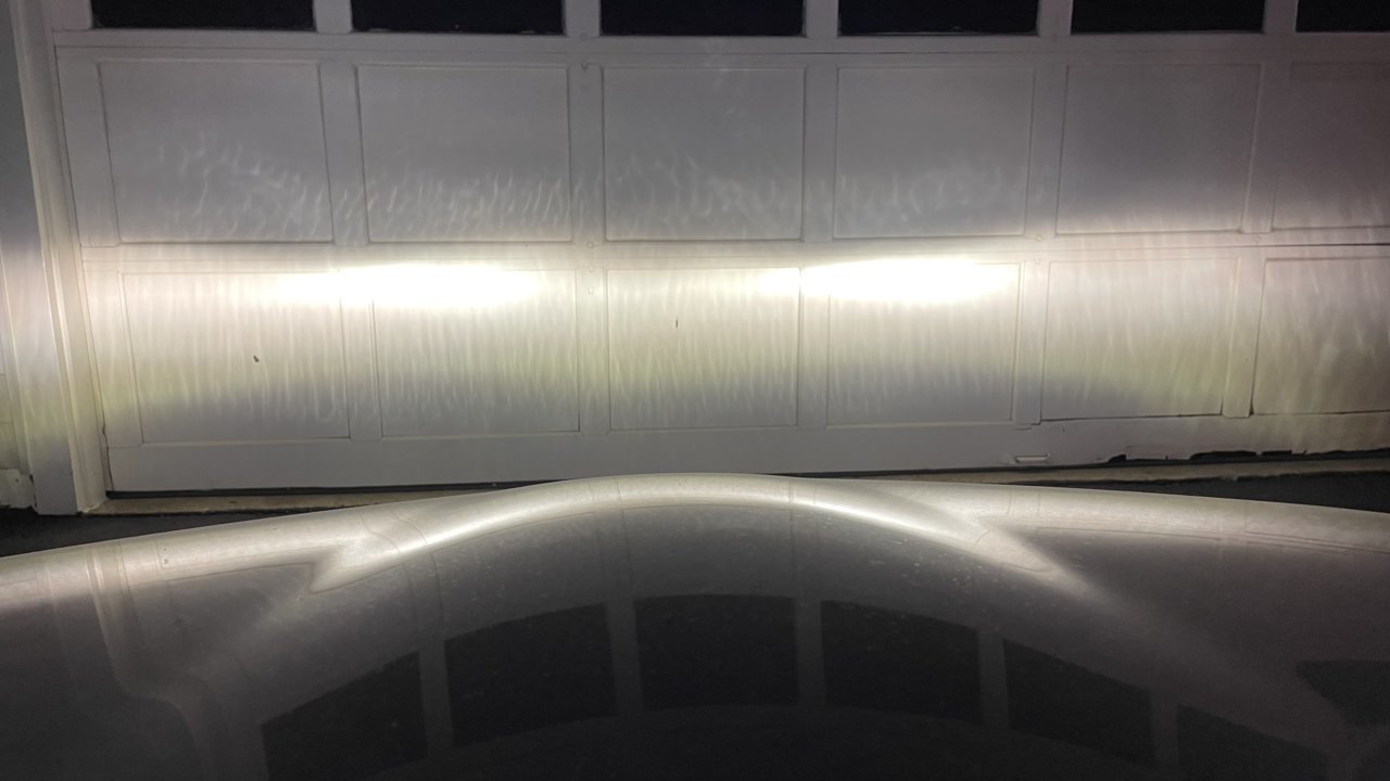

    I'm glad you posted! I was trying to find a photo to show everyone I wasn't crazy. :rofl:
    Do you have a shot at night showing the cutoff? Like against a wall or something?
    Toy_Runner and crashnburn80[OP] like this.

    I don’t have one currently, but can try to get one against the garage door tonight.

    Ok here is one. This is only ~6ft from the garage door but I think shows the beam pattern. Definitely don’t get the sharp cutoff line like projectors give.
    klavender1 and crashnburn80[OP] like this.

    So what you're saying is... we can thabk Lexus for singlehandedly bringing the ricer/euro fanboi the idea they can just stick a HID burner in any ole headlamp and call it good...
    Gahhh/s
    Not sure what your camera setting were, but the uplight doesn't look horrible, despite all the reflective surfaces on the lower portions of the reflector bowls. Lenses look a little milky, are they original?

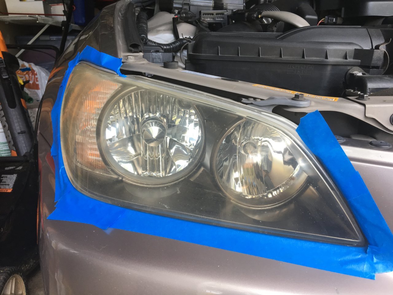

    Yeah lenses are original. They got pretty oxidized and I’ve tried polishing them (previous picture with the painters tape). They’ve also got clear lamin-x on them now which might be causing them to look a little milky.

    Personally I’d avoid films and use a UV protectant coating after polishing, even though it is a maintenance solution.
