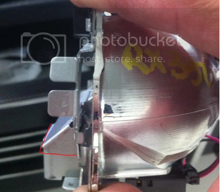

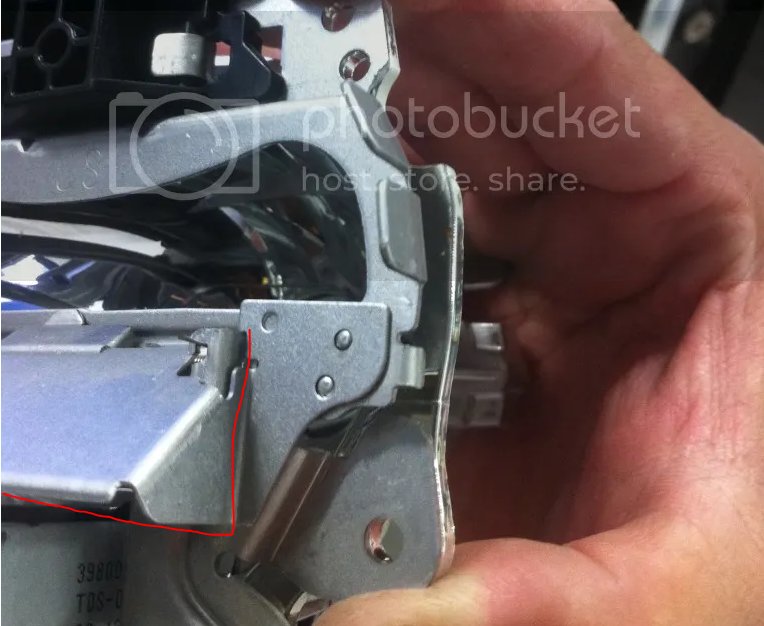

    Judging off this comment I would say he probably removed the "squirrel finder" so there would be little to no up lighting. Some people remove it to give a sharper cutoff for more aesthetics, but obviously it does hurt performance.
    This is the squirrel finder (outlined in red) on an RX350 AFS projector for reference so people know what the discussion is. NOT my picture, grabbed off the interwebs. Essentially it reflects a small amount of light upwards to illuminate signs and animals eyes above the cutoff of light. This is incorporated on ALL OEM projectors, not all are designed exactly like this but it is the same basic principle. Some aftermarket projectors also use a squirrel finder as well, but not all.

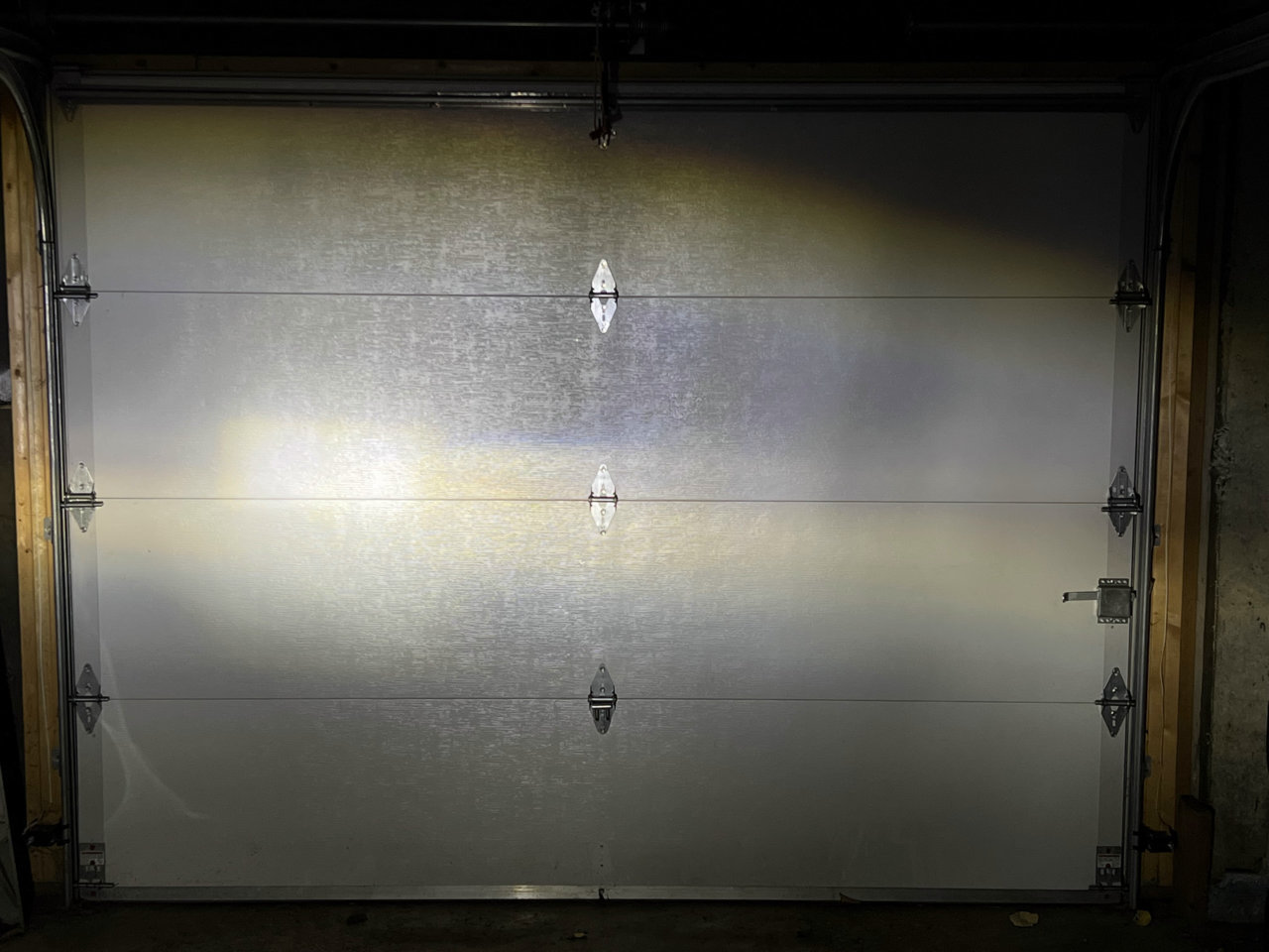

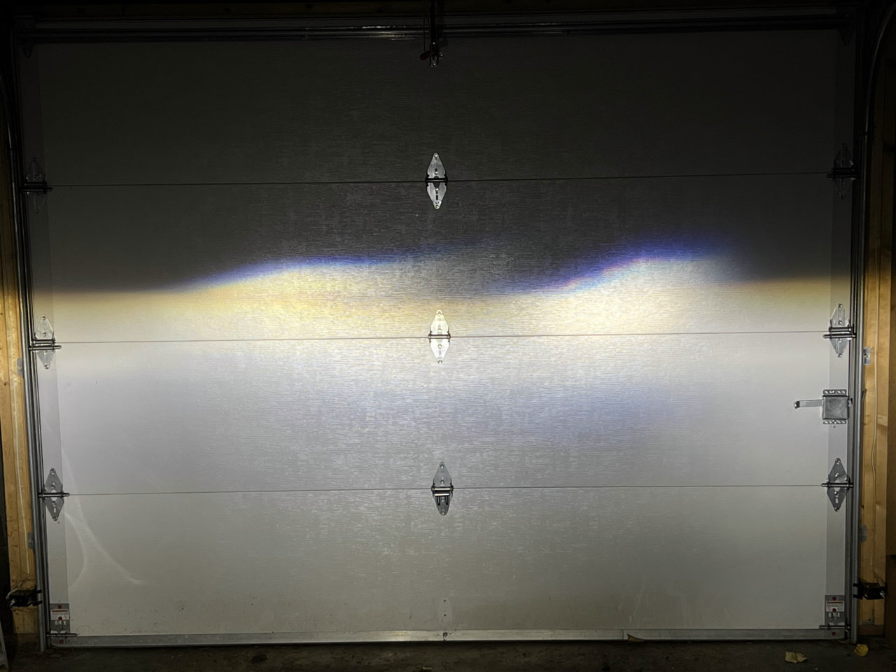

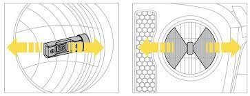

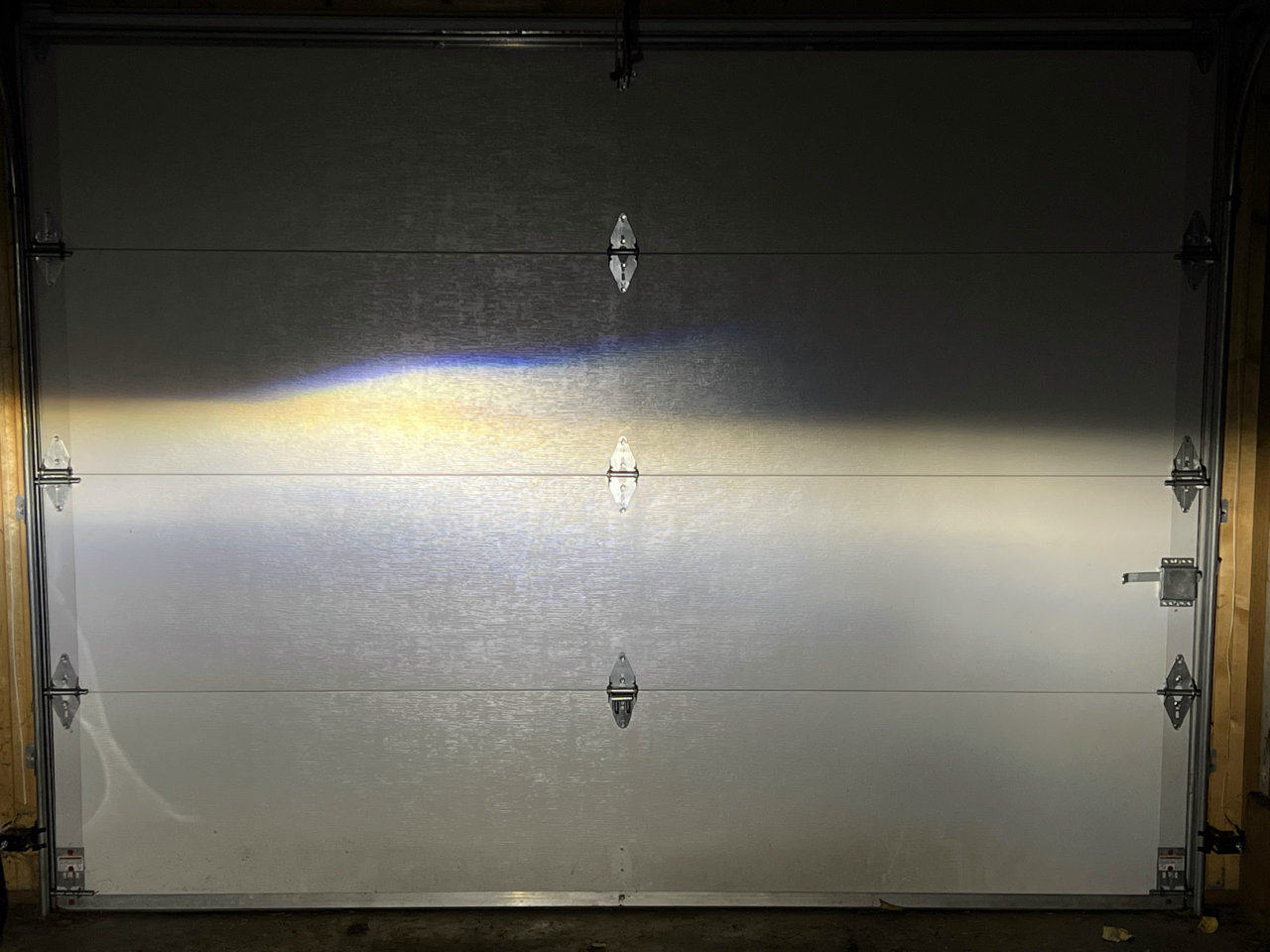

    I've captured this in 2nd Gen headlights. There is significant gaps in output out of the bi-directional LED that fails to illuminate many of the headlight flutes causing irregular output.
    Take a look at the resulting pattern examples run in a late model 2nd Gen Tacoma light (each running one headlight):
    Philips X-tremeUltinon Gen1 H4 LED
    Philips X-tremeUltinon Gen2 H4 LED
    Stock standard OEM Osram H4 (yes this is one headlight)
    There is no question that using a bi-directional LED in a halogen reflector housing designed for an omni-directional halogen light sources has some significant pattern distribution issues. The patterns look nothing like stock.

    Thats awesome that you were able to get photographic confirmation of this!! What people don't seem to understand is that this same distribution is a factor in projectors too, just it can't be seen behind the lens. I am going to save this post as a visual reference when informing people about lighting, usually family and friends. Thanks again Crash!!

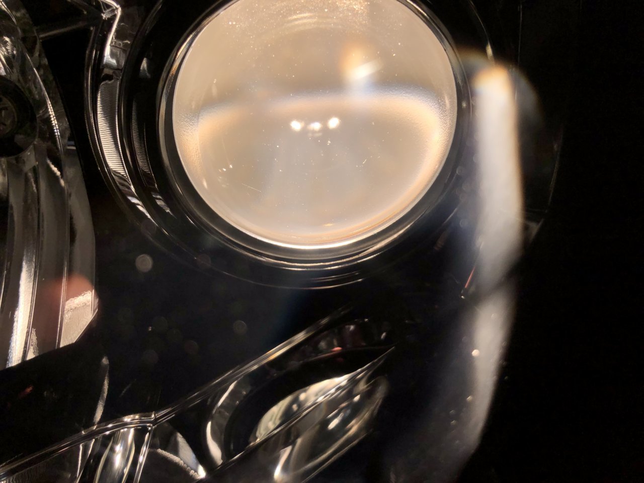

    Oh no you can see it on projectors too. Ill try to take a picture of mine tonight, you can see the light on the plastic lens and there is a very distinct hourglass shape where there is no light.

    Much harder to photograph, but yes. Here is a copy/paste from the original post (the halogen reflector image is in there too).
    You can see the halogen filament on center, with reflections off the rear of the projector concentrating the light into a focused hot spot. And recall smaller light sources create better focus for higher intensity.
    Compared to the LED, there is no center focus at all. It is difficult to say if those even reflect off the back of the projector since they are side firing, but for focus you should have light in the very center of the housing, and it is absent. Affect on the beam is predictable.

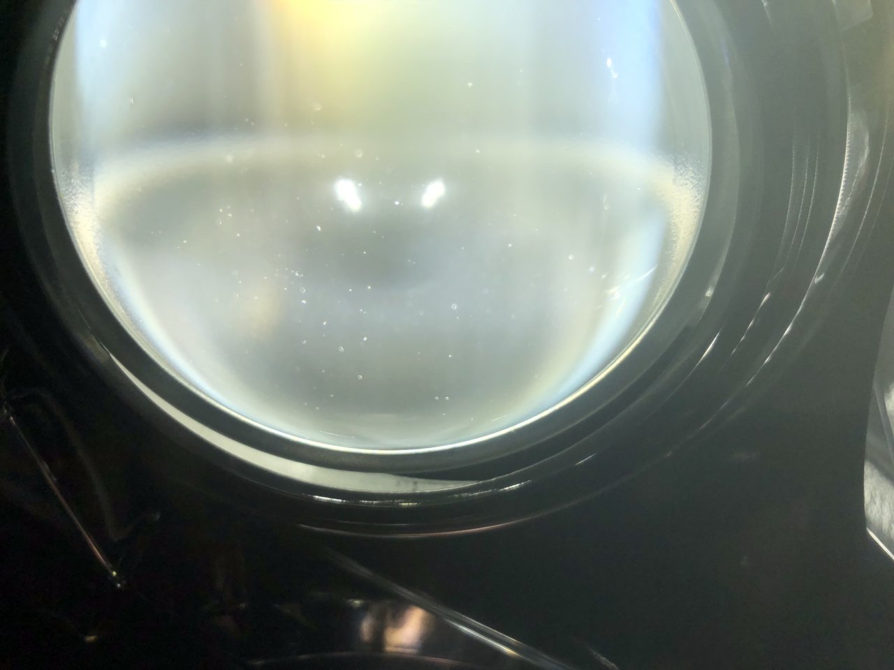

    My lenses (the outer shell) is pitted from sand, so they have a slight haze. I can see the hourglass shape on them.
    I have the huriko or whatever they are called LED bulbs and hate them. THey look super bright, but they do not throw light very well. Im working on going back to HID with a rx350 swap this winter.

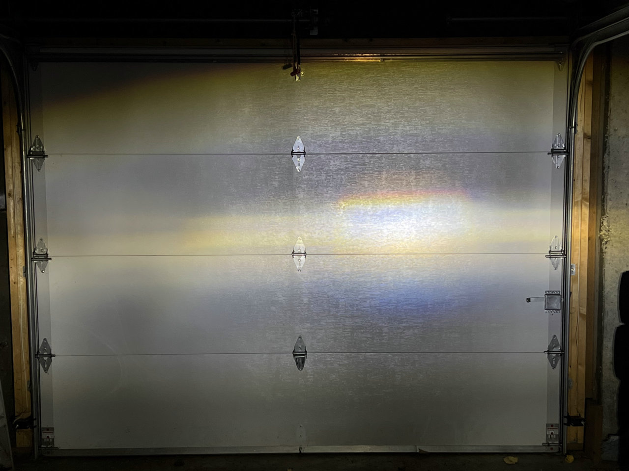

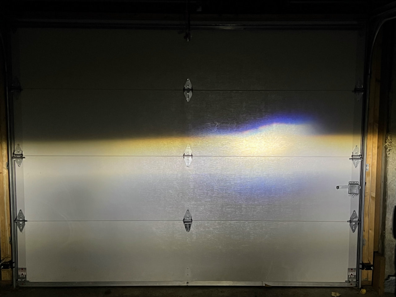

    I finally got around taking a picture of the led headlights to show off the crap pattern it shows on the lens.

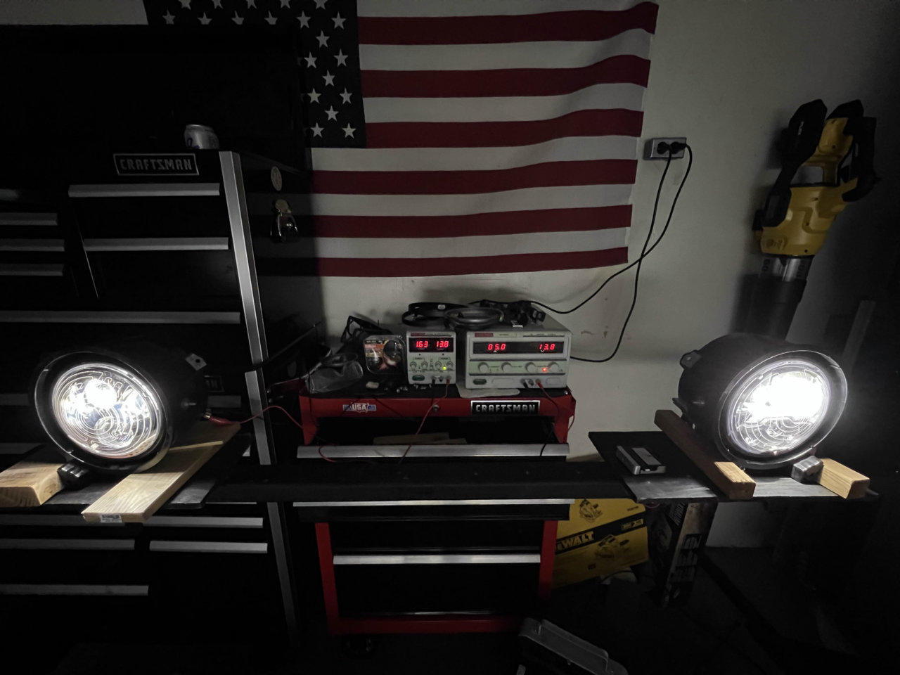

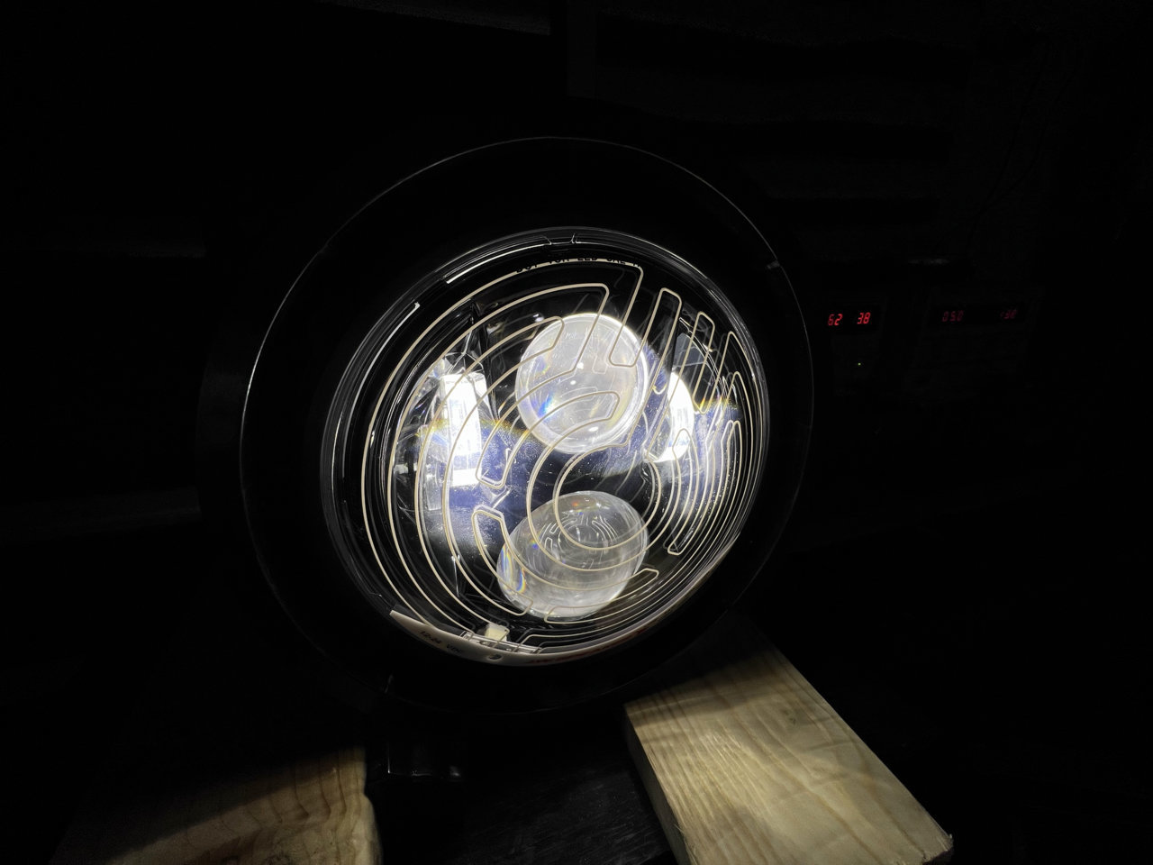

    Cross-posted from my build thread.

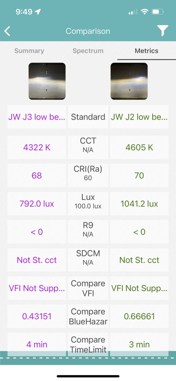

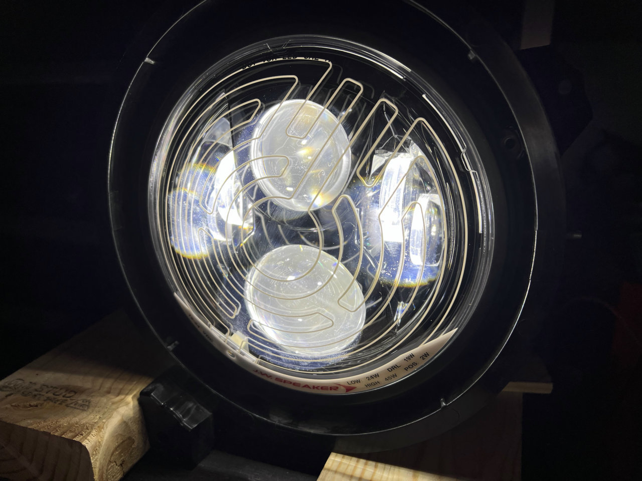

    JW Speaker 7" round heated J2 vs heated J3 headlights
    J2 left vs J3 right
    Comparing the J3 vs J2 patterns side-by-side, it is easy to see the J2s offer better hot spot and superior output intensity despite the J3s being the premium model. The J3s hot spot is not very focused/well defined. The side-by-side comparison does conceal some other differences though.
    Single J2s
    vs single J3

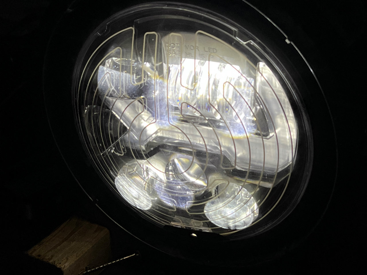

    The J3s have more light above the pattern cut off (glare) than the J2s, but also have more light and a more uniform light distribution below the main pattern for foreground light. The J2s have a more focused region of output in the upper portion of the beam pattern near the cut off with darker regions in the lower pattern (foreground light) that the J3s do a better job of seamlessly filling.
    Low beam J2 uses a single large projector and 2 large semi-circle optics for the low beam
    The J3 uses 1 small projector, 2 small and 3 medium semi-circle optics for the low beam, plus the J DRL.
    On the J3s the projector is responsible for the hot spot and ECE sloped style cut off, while the multi-semi-circle optics fill in the rest of the pattern.
    Low beam output intensity
    The J3s are rated at 1320 actual lumen output vs the J2s 750actual lumens. Despite the J2s lower output, they come in at ~31% higher output intensity on low beam by my measured numbers. JWs specs state the J2s should be ~41% higher in peak Cd.
    J2 high beam
    J3 high beam
    The J2 and J3 have very similar high beam patterns, extending the hot spot above the cut off and having a more traditional projector down road focused high beam that lacks the flood feature often seen in OEM high beam assemblies. The J3s do look to do a slightly better job in filling in the pattern with more light outside the hotspot region.

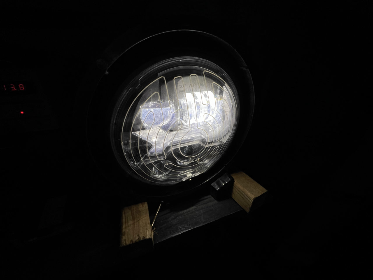

    Both the J2s and J3s use 'Dual Burn' meaning the low beam optics are left on with the high beam optics. On the J2s the high beam activates the lower projector and the 2 smaller semi-circle side optics. J2 high beam pictured.
    On the J3s, the high beam uses 3 small projectors at the bottom of the assembly. If you look closely at the J3 high beam output shot, you can actually see striations in the pattern due to the 3 projectors vs the J2s single projector. [Likely not visible on small screen mobile]. J3 high beam pictured.

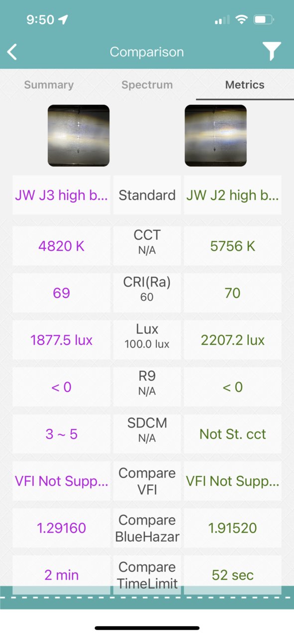

    High beam output intensity
    My numbers show the J2 high beam being ~17.6% higher in peak output intensity. According to JW speaker specs, the J3s should be about ~27% higher in output intensity. I don't have a great explanation for this discrepancy. 2 points I would consider
    1) For high beam in a combination automotive headlamp assembly, I don't use the typical 15-20 minute run time for a stable high beam measurement sine high beam use is usually much shorter than that.
    2) My J3 lamp had a defective heater. I had one lamp where the heater didn't work at all, and it turns out this second lamp wouldn't turn the heater off. At first I thought the garage may be too cool, so I heated it to 67 degrees for repeated testing. Even at 67 degrees the J3 heater would turn on and trip my smaller power supply. If you look at the first image in this post, you can see the J3 pulling 5A off the large power supply, while the J2 pulled 1.63. This was because the J3s heater would not turn off. In theory I wouldn't anticipate this affecting output results, but just calling out al the details.
    It is worth noting that the J3s offer many more features including integrated turn signal, off-road cornering light, off-road light boost and a light show feature. However the later 3 are bluetooth controlled via phone. While the boost and cornering light features would be readily welcomed, I find I don't use them because I'm not pulling out my phone when I want to see better while driving so I don't consider them a deciding factor for my use.
    After a year of driving with the J3s and feeling somewhat underwhelmed, I'm looking forward to street testing the J2s.
