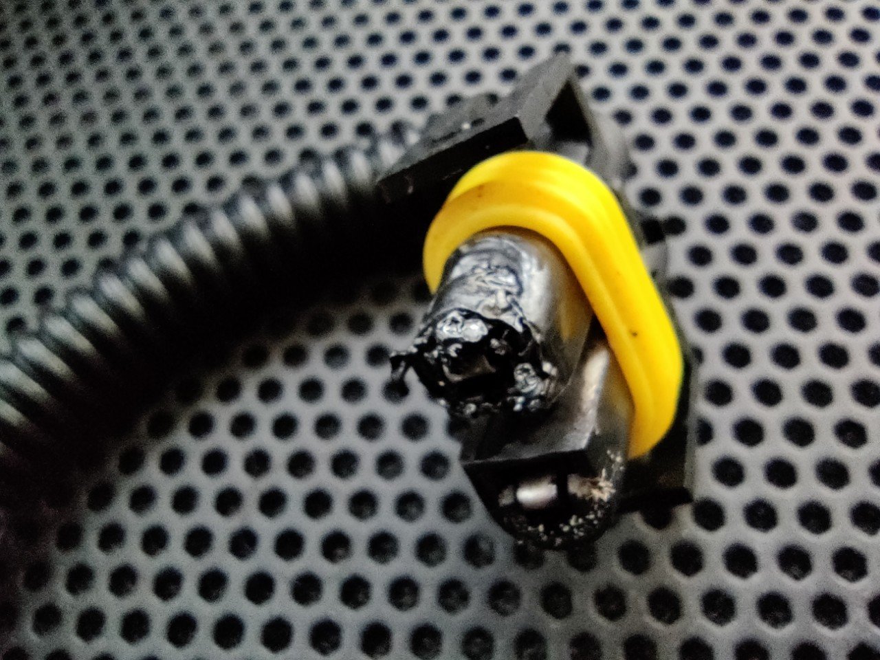

    Popped in one of the sets of Nighthawk Platinums I bought since I lost another H9/H11 adapter today.

    Can't you just remove the green piece on the factory connector and it plugs right up?

    The 4Runner doesn't have that piece. It's different because the 4Runner's connector is sealed behind a dust cap.

    Ah ok! Didn't realize this was on a 4Runner. It's weird that Toyota didn't just do the same thing across the board. Even my 2005 GX has that green connector piece. Pretty easy to trim the bulb itself though.

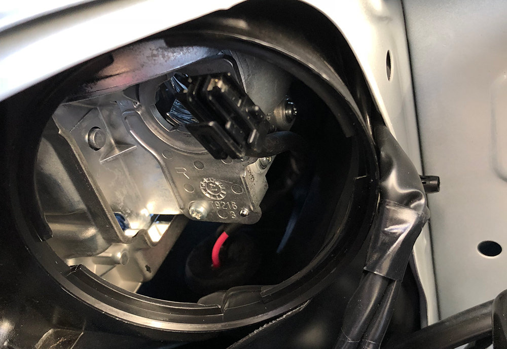

    Maybe one day I'll try to get in there and trim the connector, but there's not a lot of room to work with unless I remove the headlamps.

    Just trim the bulb. You really don't need to trim the metal tab. You can just put the bulb in at an angle.

    If I ever get out from under my backlog I could maybe offer some short H9 adapter harnesses. I owe a dozen things first though so it’ll likely be a while. And not sure if the female H9’s I do have will not have similar trouble.

    Thanks for the offer. I'm trying out the Nighthawk H11's right now. I'm not sure why the adapters burn up. Maybe cheap plastic :notsure:

    Nokya Wire Harness H9 NoK9117 Head Light Bulb Socket Female Male High Beam Plug
    Link is toast b/c I bought it a long time ago, but it was a Nokya. Seemed longer than ideal length to me.
