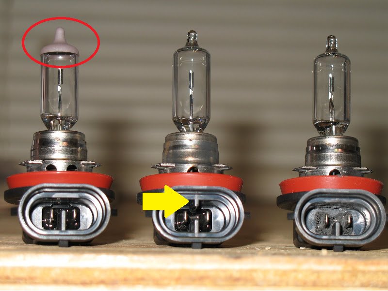

    So I just did the H11 fog light swap. The original H16 fogs were poor performing. I did put H9 bulbs in however. What specifically does the glare cap do on the H11 vs the non-capped H9?

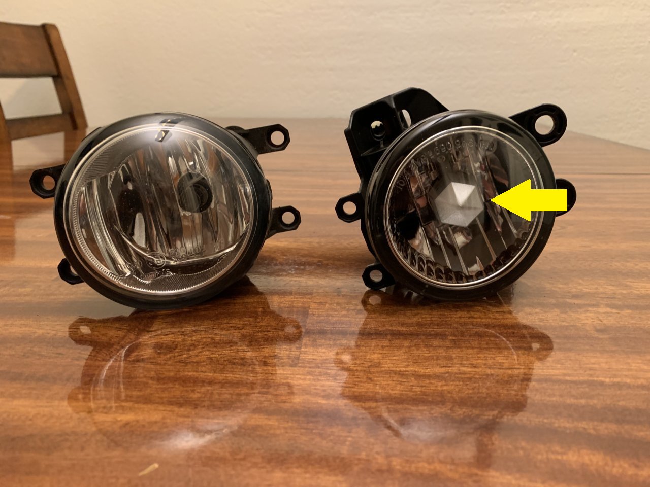

    The "glare cap" is designed to reduce glare when the light housing does not have a built in glare cap. The OEM Tacoma fog lights (H16 and H11) do NOT have built in glare caps. If an H9 is used in either housing you will have a lot more glare (ie oncoming traffic distraction). I tested it myself just to see and there is a considerable amount of glare with the H9 in comparison to an H11, I didn't take any pictures though. Essentially the reason the H9 causes glare in this type of housing is because there is nothing blocking light coming from the filament in a directly forward direction. Whereas the H11 will block that with the painted on glare cap.
    I haven't seen a direct output comparison of the OEM H16 fog light housing with an H11 bulb compared to the OEM H11 fog light housing using the same bulb. But the OEM H11 is known as the wide angle fog light, so I would assume it is overall a higher performing fog light if the bulb choice was equal.
    In this picture from left to right is an H11 (glare cap circled in red), H9 (arrow to tab that requires trimming) and H9 with the tab trimmed for use with an H11 plug.
    This picture (courtesy of Crash from his "ultimate fog light test") is a Tacoma H11 Fog light (left) and Subaru Outback Fog light (right). The yellow arrow indicates the built in glare glare cap I am referring to.

    Great reply, thanks!
    To summarize; glare capped fog bulb is designed as a courtesy to reduce glare for oncoming traffic?

    To my knowledge that is the main and only purpose. Some people have tried using specific high temp glass paint to make their own glare cap, but I don't know how successful it has been. Nor do I think it's worth the price and effort, at least for an H9 compared to high performance H11's that come within a few percent of the H9 performacne.

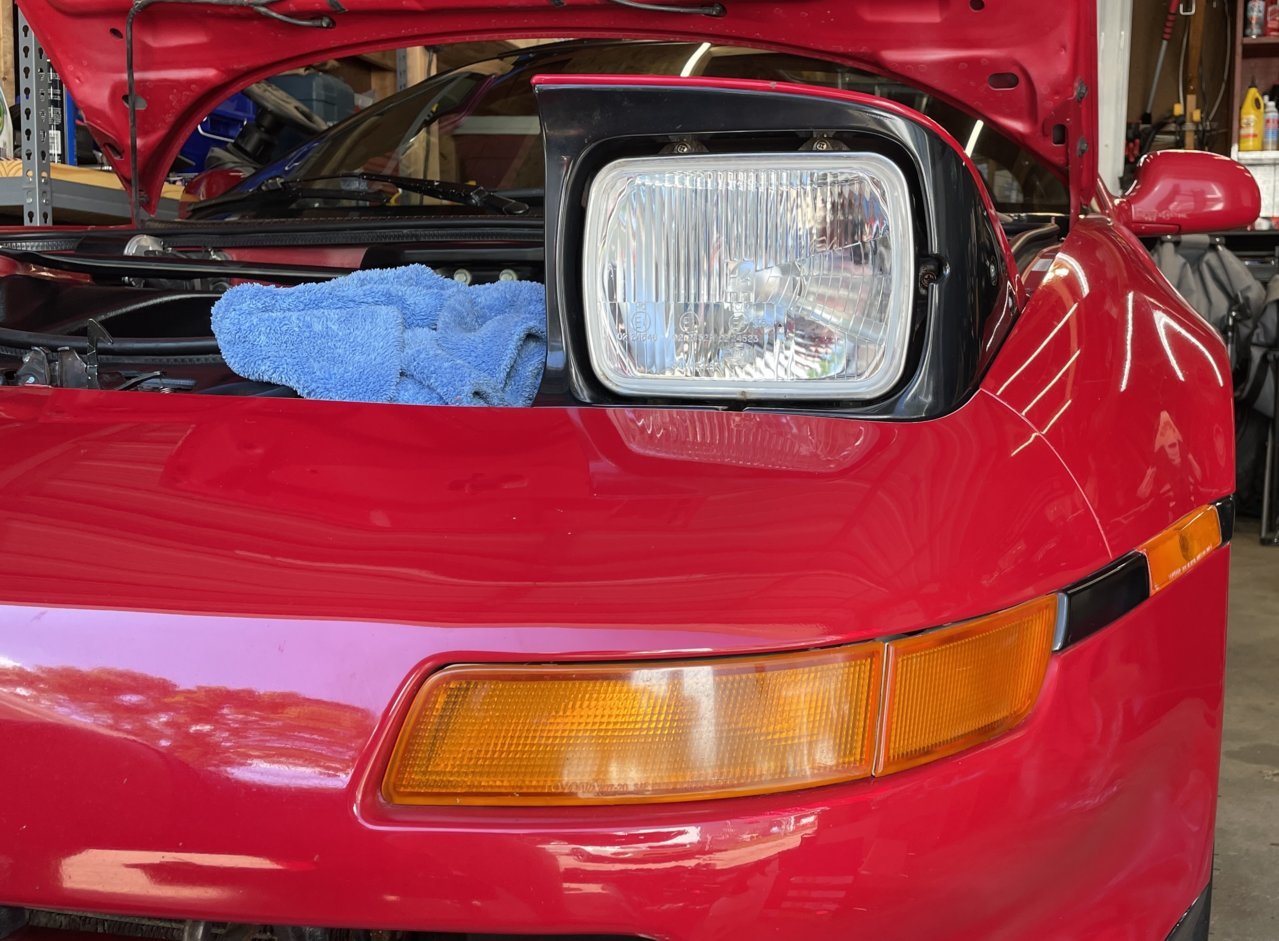

    I am VERY curious how the 5x7 will stack up in performance compared to Hella ECE with a good bulb for my MR2!! I don't care for the busy style of most LED housings. It really looks out of place on many vehicles that use sealed beams and especially on cars with pop up headlights it makes draws your focus on what is out of place. Maybe I'm just getting old though. haha

    @joncure Yes, and it helps reduce glare coming back to the driver that’s reflected off of snow, rain, and fog. I ran h9’s in my fogs for half a season. While the light output was fantastic to the sides, the excessive glare made them blinding and unusable in rain, fog, and snow. I currently have tungsram platinum h11’s in my fogs and in today’s blowing flurries on my way to work they were great, with great light to the sides and little upward glare. H9’s in the fogs looked like using high beams in terms of glare and reflection off of precipitation.

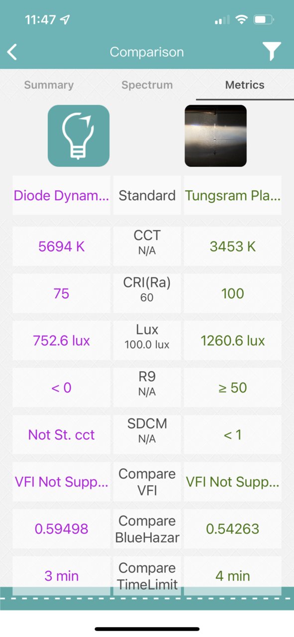

    I just purchased a 2022 TRD Sport and am trying to figure out what to do with the headlights.
    I have a new set of Diode Dynamics SL1 H11’s just sitting in a drawer. Are these worth using? If I stick with H11 halogen just use H11 Tungsram Platinum ?

    A glare capped bulb is a requirement for the housing to prevent glare to oncoming drivers, but to also maintain pattern cut off for your fogs to actually work in fog rather than acting as an ineffective high beam.
    I've tried using the high temp paint route. It was pointed out that the paint will off gas, coat the reflector and reduce the performance. You need proper high temp bulb glare cap coating material. I've found it, but it is not cheap at all. I also experimented with the Subi fogs using glare caps, but the pattern wasn't as wide as desired.

    The Diode Dynamics SL1 is a poor performing product, it fails to even match the performance of the stock H11 bulb. It does produce misleading foreground light, which people often think means the product is better, even though that actually makes it worse. Full SL1 review posted here.
    SL1 vs Tungsram Platinum
