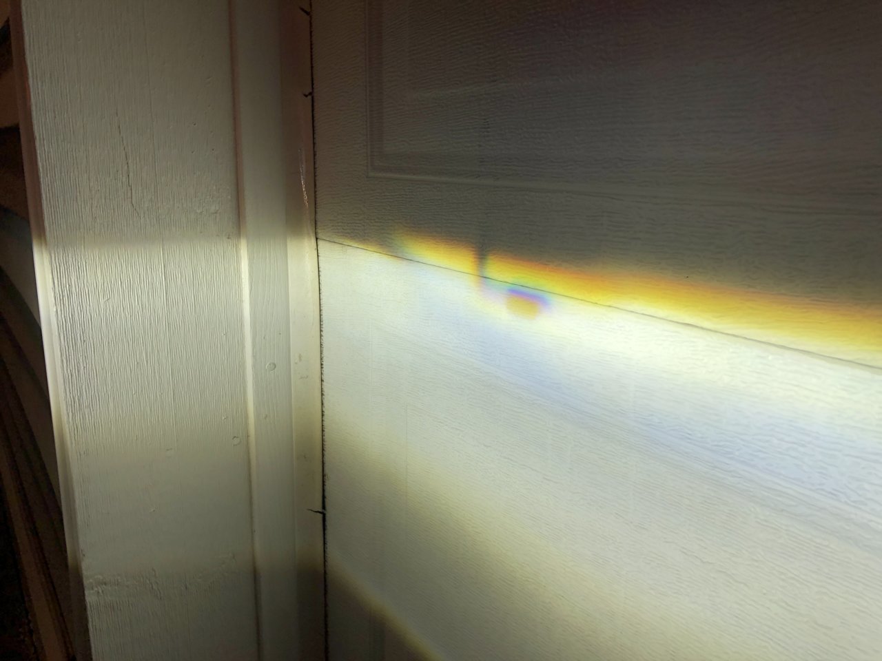

    Stumbled upon this today, I had never seen matrix LEDs in action before :drool:

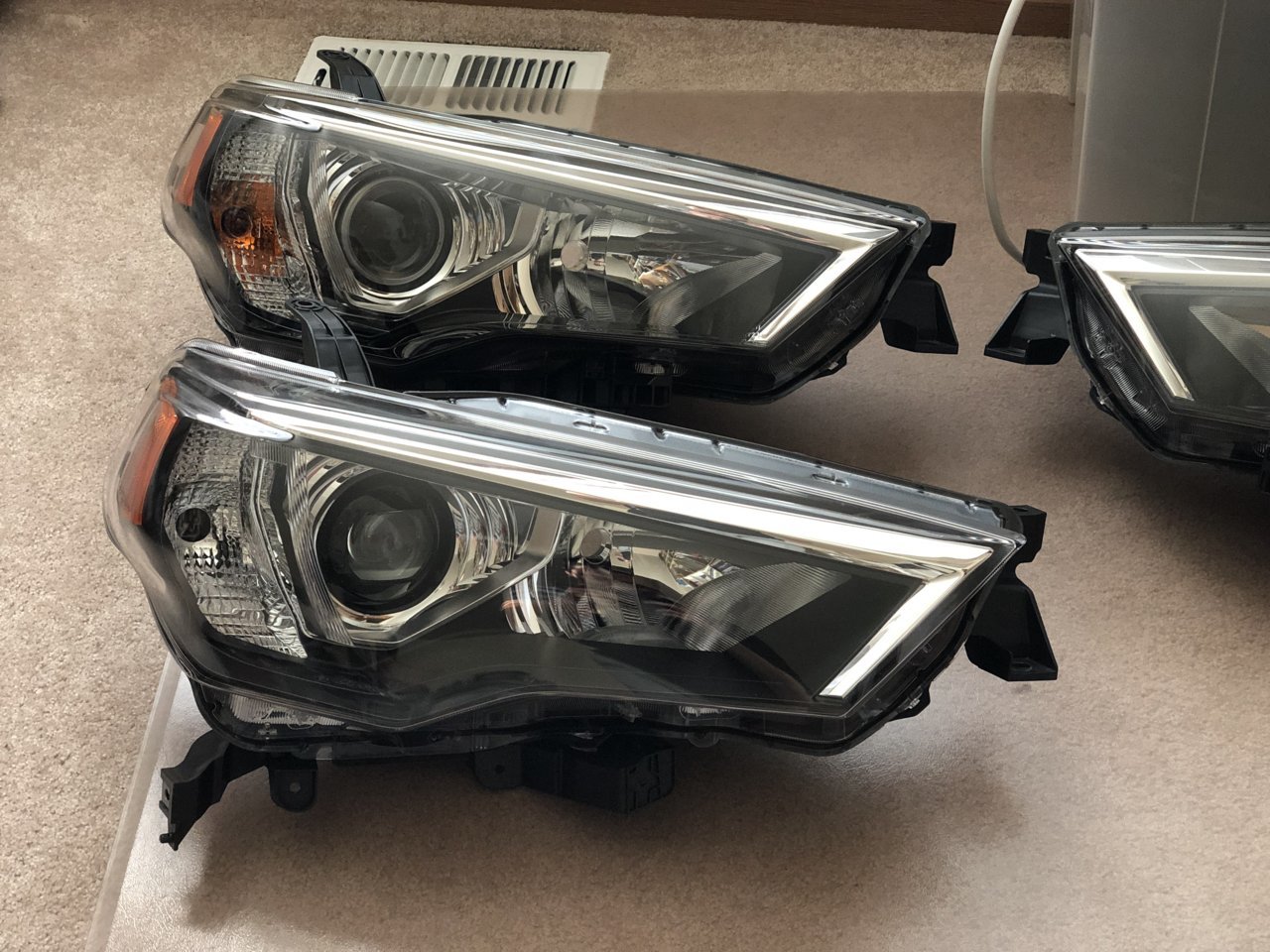

    @Spike Spiegel just picked up all my 4Runner lights.
    Spike Spiegel likes this.

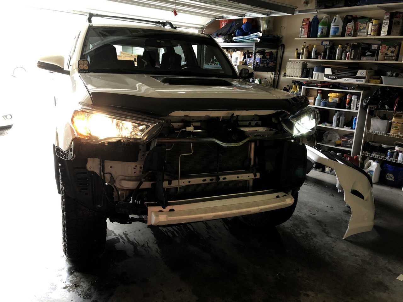

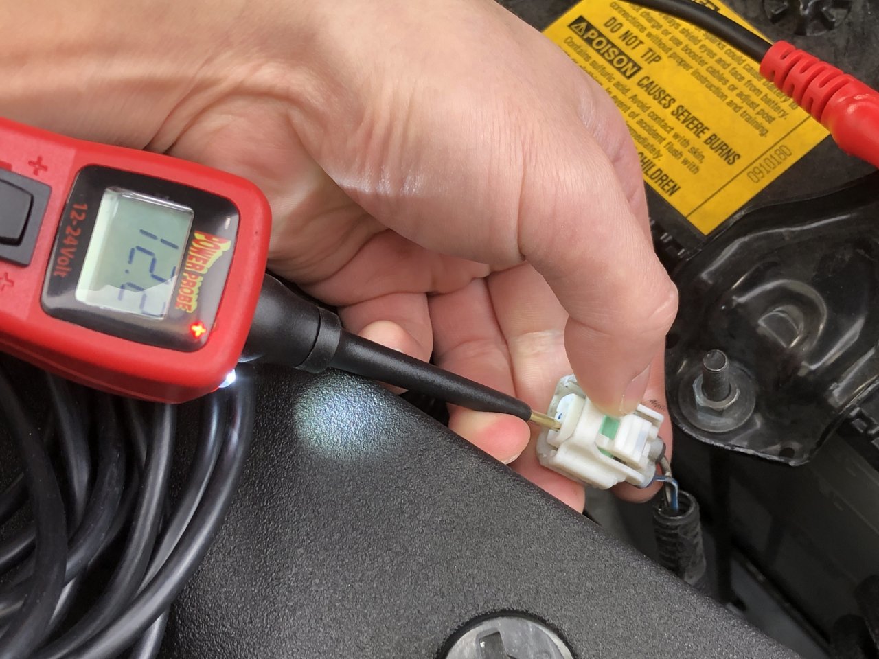

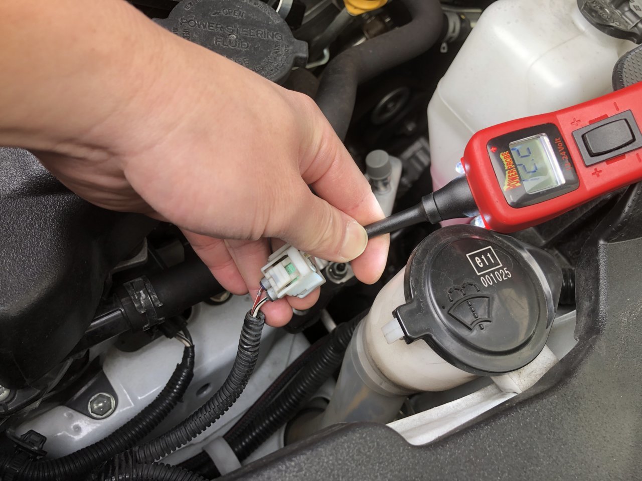

    So, ok, the assemblies you have @Spike Spiegel, they aren't LED for high beams too, just the low beams? B/c the massive headache was with the full LED assembly for both high and low and I couldn't get a straight answer for the pinouts. I'll add a photo of what I sent the dude, he said he had to hack it to get it going and per the video you posted it looks like power and ground on the low beam are reverse polarity, but then he goes on to say "maybe you have to swap it" so like, wtf right?
    The male in mine definitely looks 100% reversed but then the 4 position does too based on what I see in that video.
    I could send you the whole shebang de-pinned and let you own that part? Do you for sure not need any HB3/9005 male connector feeding in, it's really just the low beams?
    For now based on what the dude told me (which seems totally wrong based on that video) I have
    2 position male connector, terminal 1 is power, 2 is ground (video makes it look very much like that should be swapped)
    4 position female connector, terminal 1 is high beam power, terminal 2 is ground, terminal 4 is low beam power (video makes it look like 2 should be low beam + and 4 should be low beam -)
    TLDR: If you want the female and male connectors with 2 plugs and 2 jumpers x 2 sides, and you own the pinout, that I can do. Or I can just send you what I have pre-built which looks 100% wrong but I'm thinking you'd prefer no 9005.

  13. Nov 22, 2021 at 8:00 AM
    #5433
    Spike Spiegel
    Spike Spiegel Well-Known Member
    Oct 27, 2019
    #309219
    180
    2019 Super White Toyota 4Runner TRD Off-road Premium
    Eibach Pro Truck Lift, JBA High Caster UCA’s, Falken Wildpeak 275/70/17, Spidertrax Spacers
    Just low beam is LED
  14. Nov 22, 2021 at 8:29 AM
    #5434
    daveeasa
    daveeasa FBC Harness Solutions
    May 14, 2020
    #328079
    7,483
    David
    PNW
    2016 Tacoma OR DCSB 6MT, 2005 RC 5MT PreRunner, 2002 Tundra SR5 RCLB 4x4
    So the de-pin and re-pin in the video is a cool idea. As the terminals are the same.
    A conversion harness is also very possible just extra bulk and lack of clarity on the terminal positions for the 4 pin

  16. Nov 26, 2021 at 3:12 PM
    #5436
    Spike Spiegel
    Oct 27, 2019
    #309219
    180

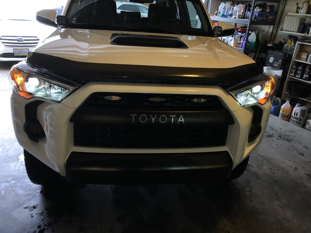

    Polarity was reversed as mentioned in the video. Thanks again @Too Stroked !!!
    We'll see how these fare in the snow this weekend after applying two coats of CarPro UK 3.0 ceramic coating on them.

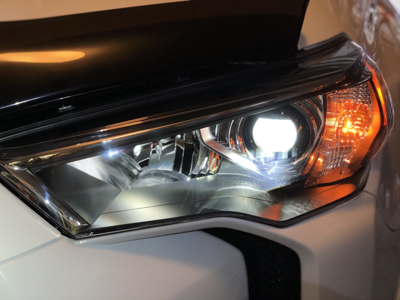

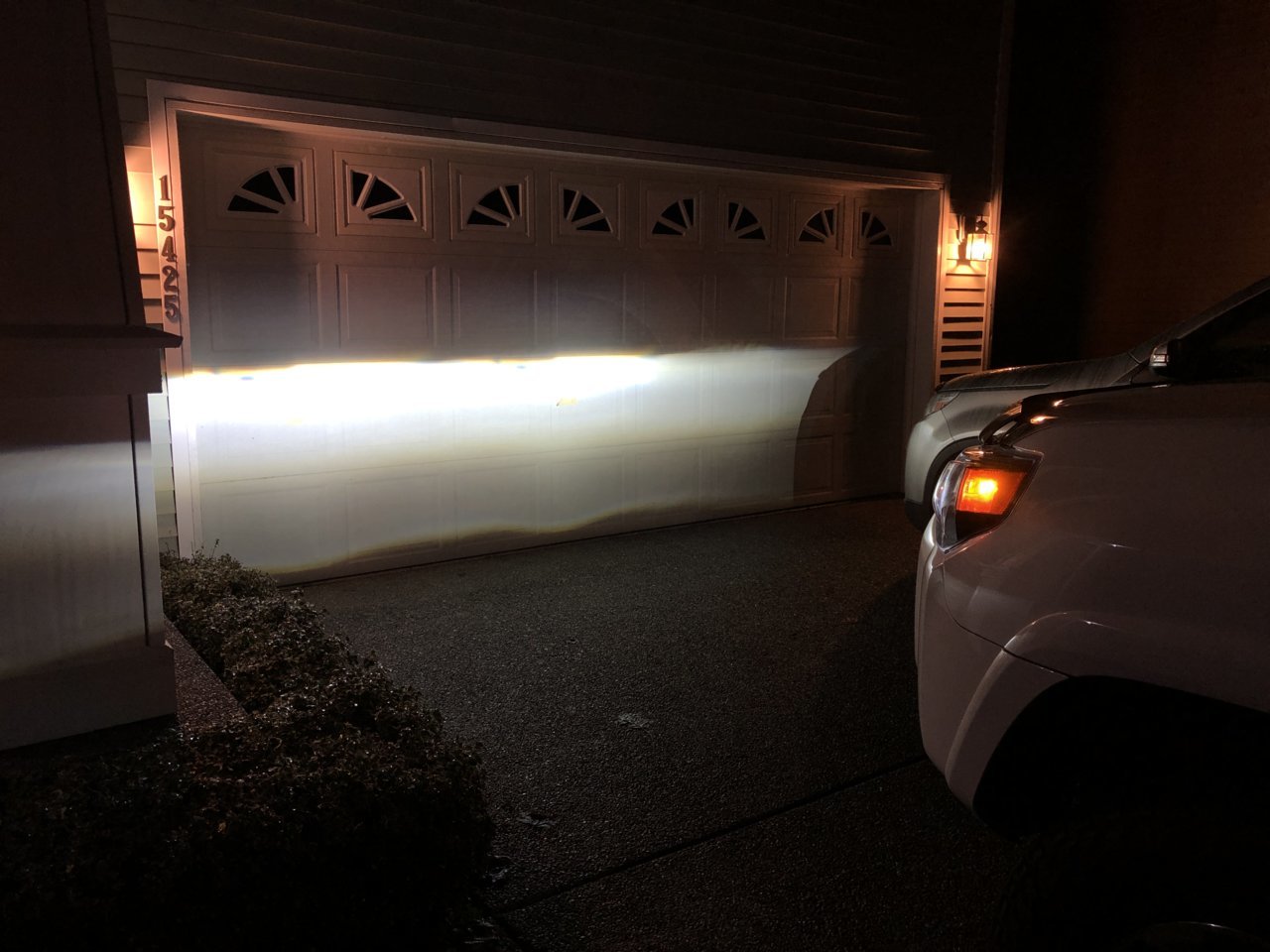

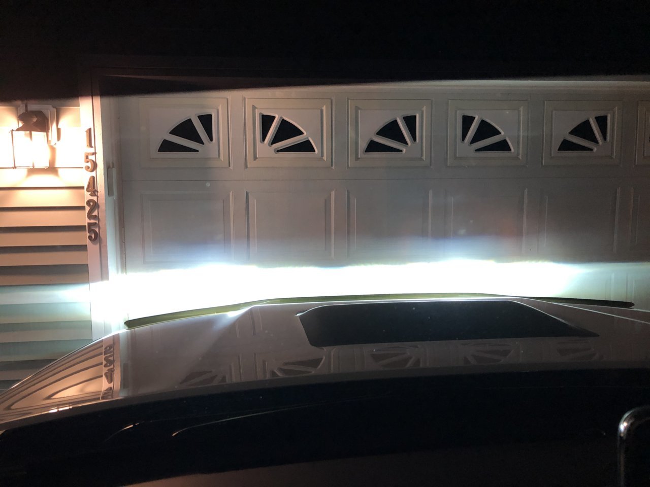

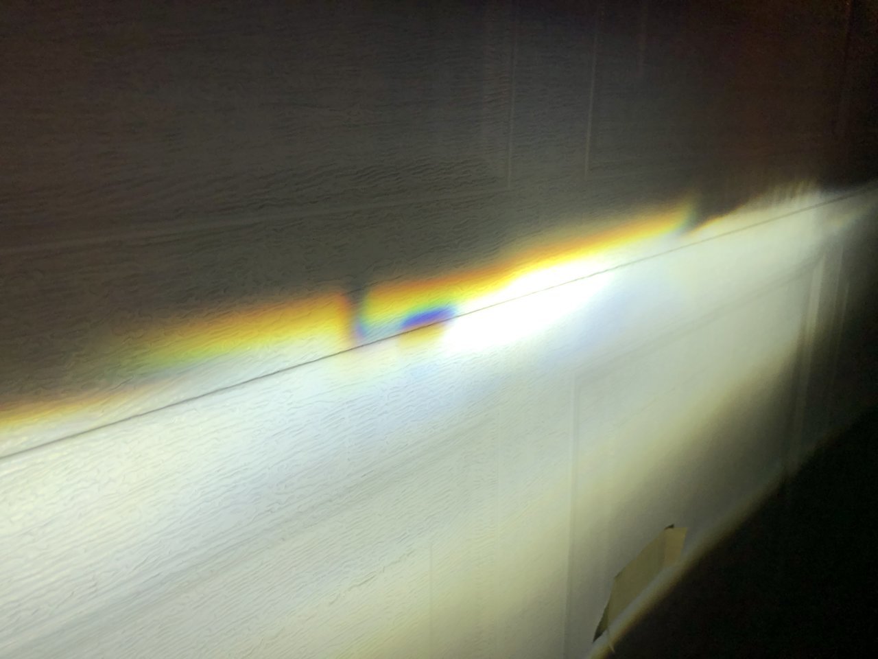

    Driving back from Costco it was immediately apparent these are miles better as @crashnburn80 has demonstrated.
    The headlights are a tad brighter than this picture is showing. The SS3 MAX fogs no longer make my low beam disappear. I am legitimately shocked. (Even when I ran HID's they would get blown out)
    Quick question, do I measure the height of the foglight beam from the center of light emitted or the sides? They seem to be the highest point as the fogs tend to bow up a little bit.
    Noticed the little black spot grew into this little guy after pulling up closer to the garage door. Wonder what it's from
    Alright that's enough 4Runner intrusion for now until I get a hold of some SS5's and mount them somewhere.

  20. Nov 26, 2021 at 7:33 PM
    #5440
    mynameistory
    mynameistory My member is well known
    Jul 3, 2012
    #81862
    1,046
    Tory
    Redondo Beach, CA
    4Runner
    I think I've noticed that too. Wonder if it's pattern or mounting.
    The guys on the swap thread have all noticed that too. Some kind of artifact in the pattern, don't know if it was intentional by the vendor or not.
