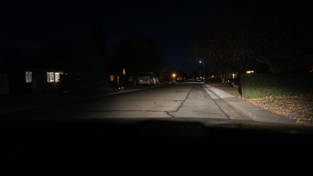

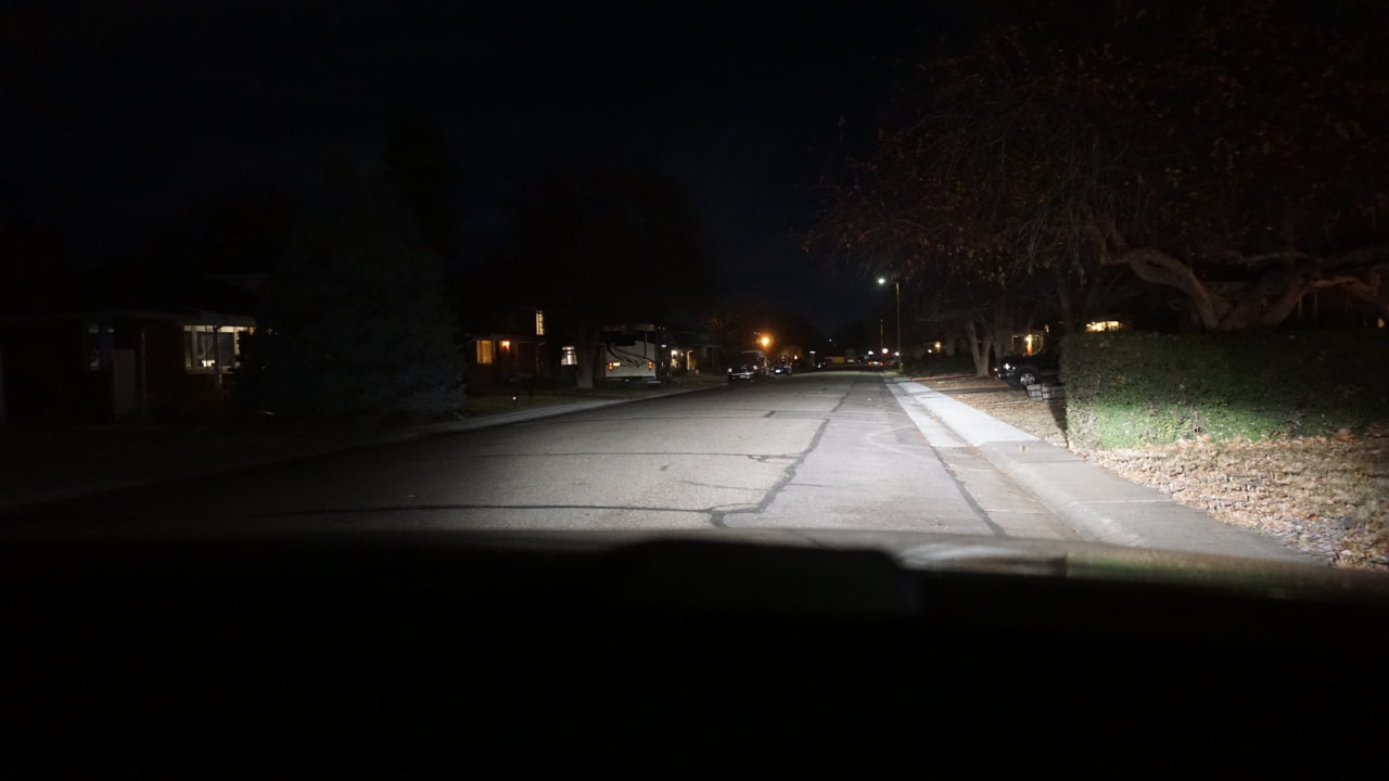

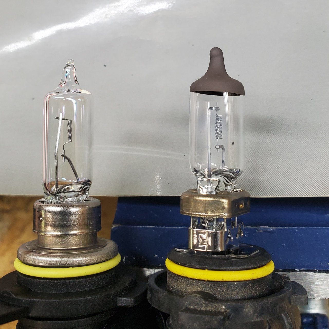

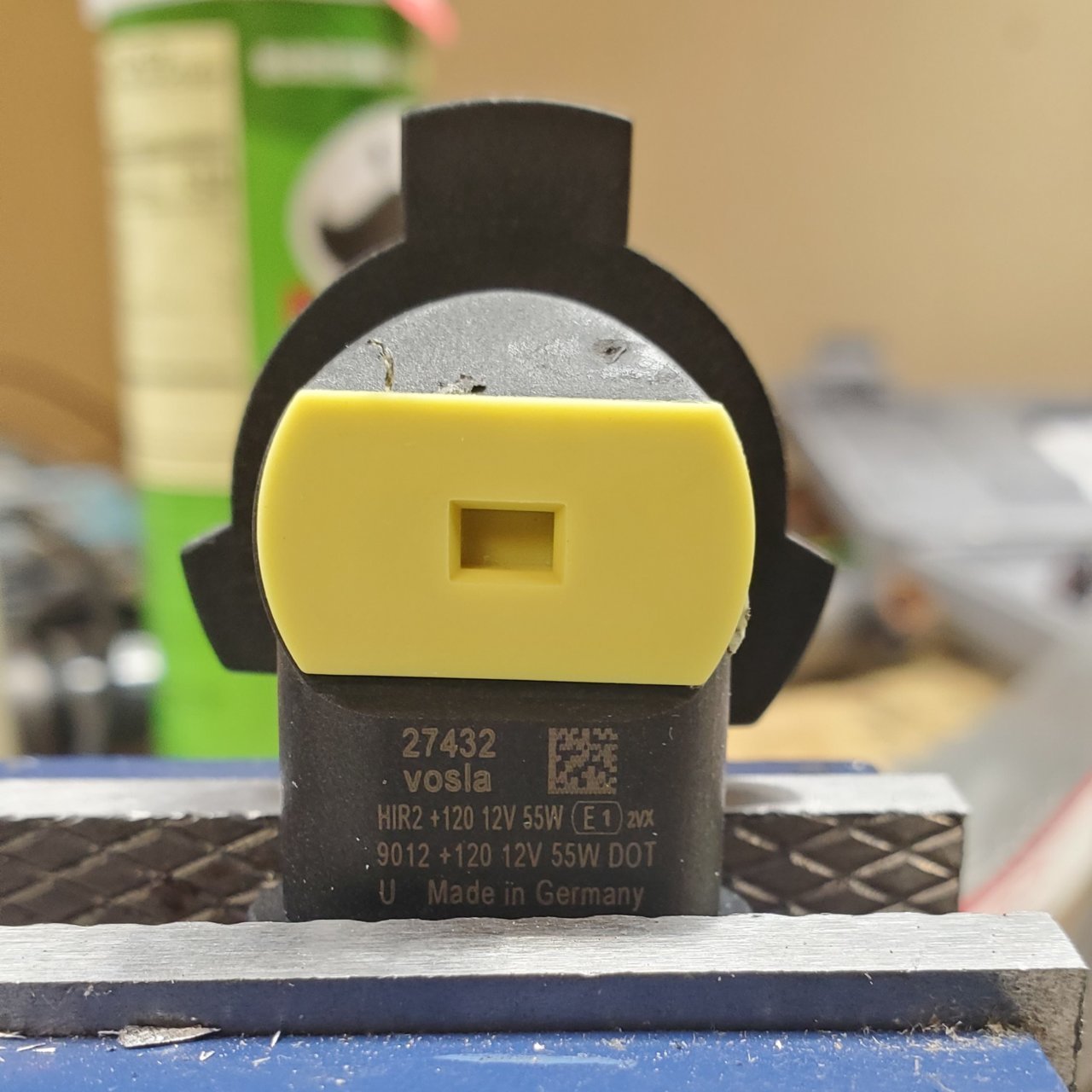

    Not a Tacoma, but based on this thread I replaced the 9006 bulbs with Volsa 9012 HIR2 +120 in the lady's Rav4. I can confirm that the eBay link crash provided several pages back got these bulbs:
    Comparing to the 9006. Smaller filament is obvious, slight rainbow coating on the 9012 is less apparent in photo:
    And here are the output shots with fixed exposure.
    9006:
    9012 HIR2 +120:
    The difference is outstanding. I used to insist on taking the truck anytime I knew there was going to be night driving, not anymore. Thanks for the recommendations based on real science.

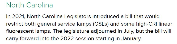

    #5498
    brandon78lusch
    brandon78lusch Well-Known Member
    Oct 22, 2019
    #308678
    4,029
    Brandon
    East Carolina University
    2019 TRD Sport DCSB, 1978 Pontiac Firebird Trans Am
    I was looking at the vehicle lighting laws for each state and I came across this for North Carolina. I thought a general service lamp was any reflector style housing, which is anything from a halogen hand-held flashlight to a halogen reflector headlight. Can anyone explain whether this only applies to aftermarket modifications which alters light output, or if this is restricting halogen reflector headlights on cars?
