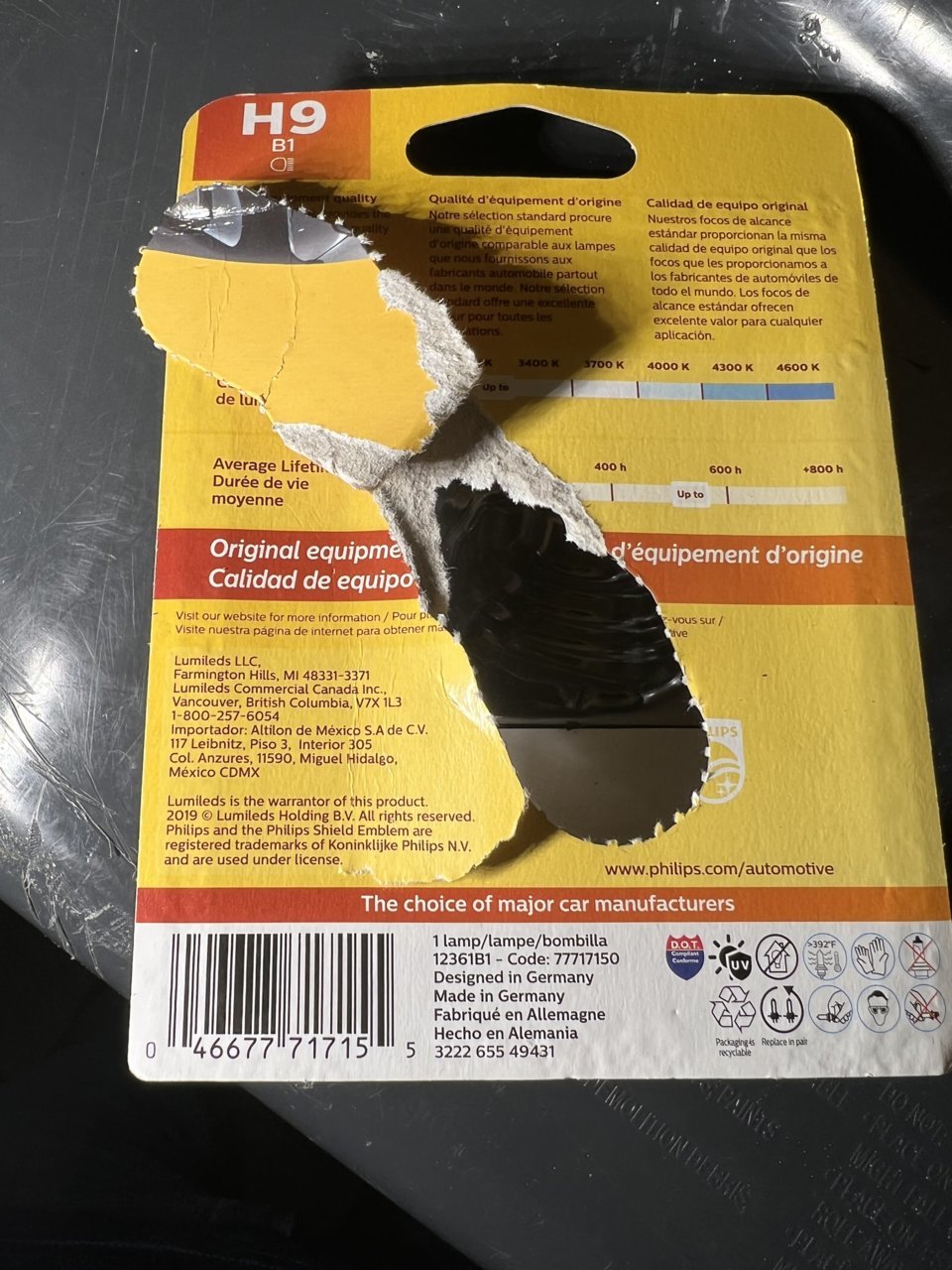

    This thread is a wealth of info, so thanks OP for taking the time to do all this. I ordered 4 H9s using your link and they are all made in Germany. Put the two spares in my center console. It was pretty simple to modify the base with some cutters and a sharp knife.
