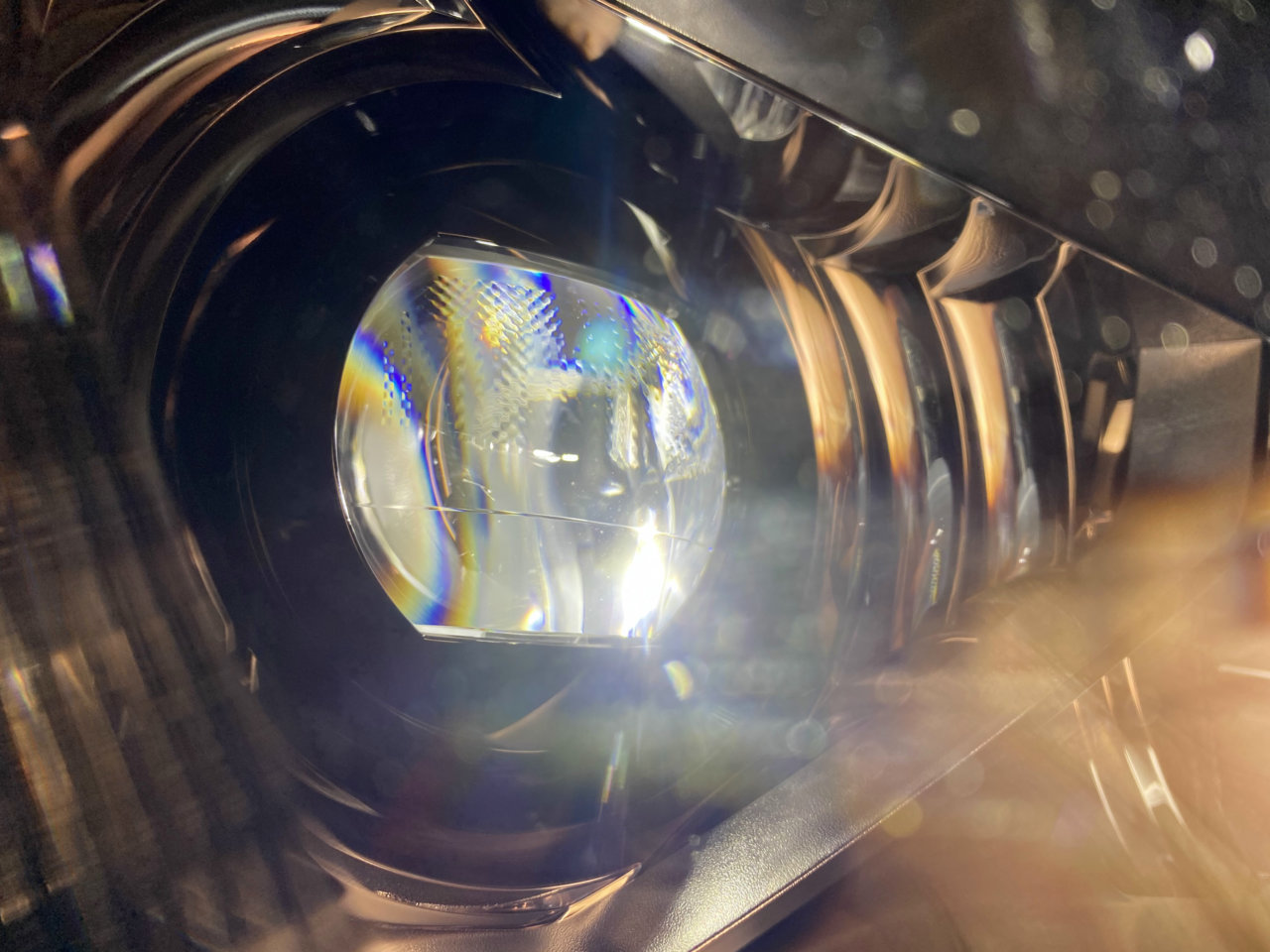

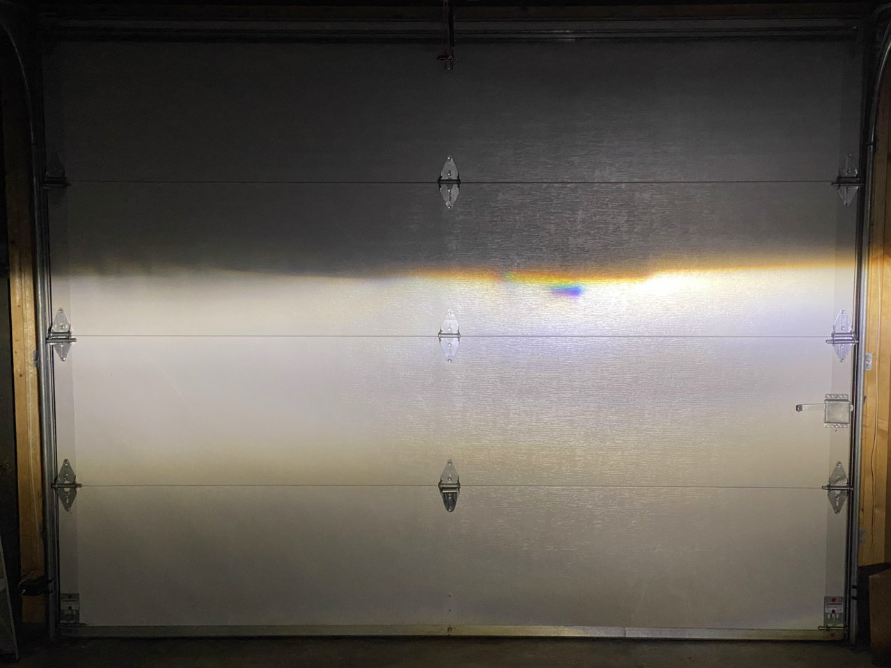

    My wife's 2019 Forester with the steering responsive LED projector low beams doesn't appear to have an uplight, at least I don't notice one on the garage wall when pulling in. I don't often drive it at night, so I can't recall if I can see the light reflecting on road signs. My Tacoma has a very clear and distinct "box" of uplight.
    Is uplight mandated by North American regulators?

    My gf has a 2019 Forester as well. Definitely has upward gradient off of the hotspot.

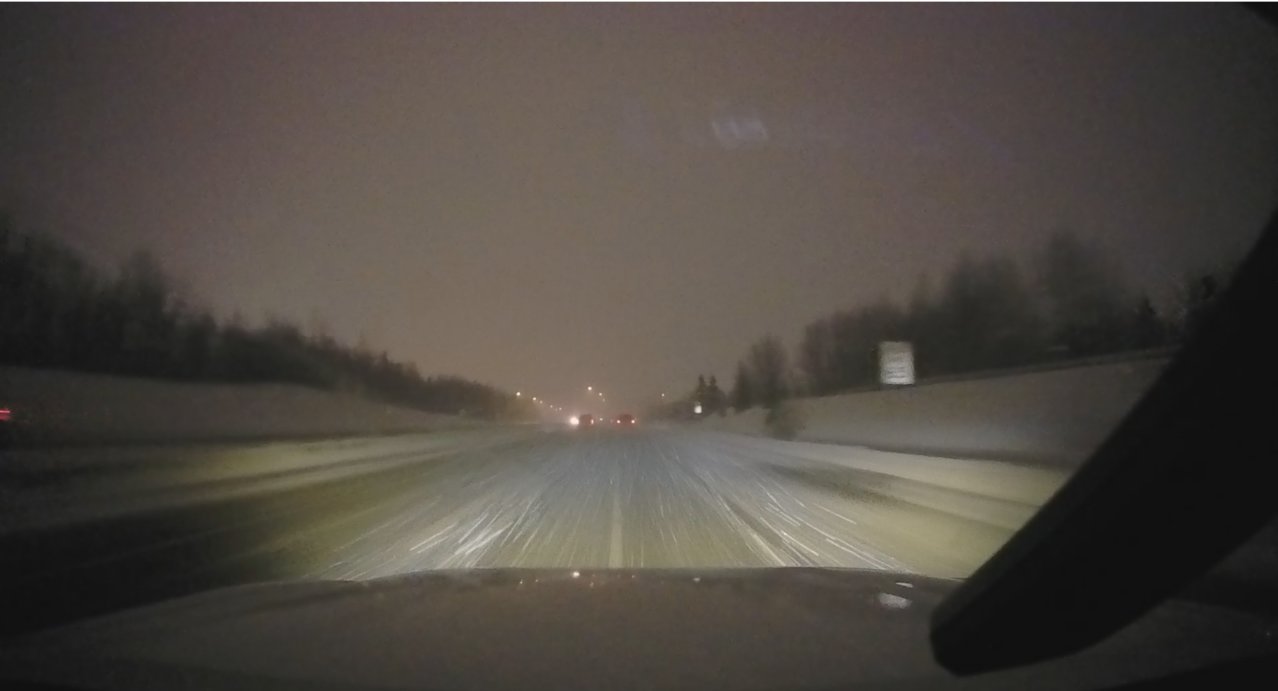

    Just wanted share this to remind people that 6000k lights suck when they reflect off the snow.. also I need to reposition my dash cam...

  6. Jan 25, 2022 at 5:28 PM
    #5546
    justdoit
    justdoit Well-Known Member
    Nov 28, 2015
    #170886
    687
    Colorado Springs
    22' 4x4 AC TRD Off-Road
    6k is way to high, try 4300
    907rx7[QUOTED] likes this.

    Yep, I have a winter set of bulbs and realized today that I never swapped them this year.

    Uplight is required. Without it the headlights would be unable to illuminate signs in dark areas. The 3rd Gen projector headlights have a very pronounced uplight pattern that is easily distinguishable, especially after a bulb upgrade. Part of this is because the very defined box effect from the projector. On other vehicles the uplight can be less defined around the edges of the illuminated region, more of a softer distributed uplight, but it is still there.
    Can confirm, I've seen it in person.
