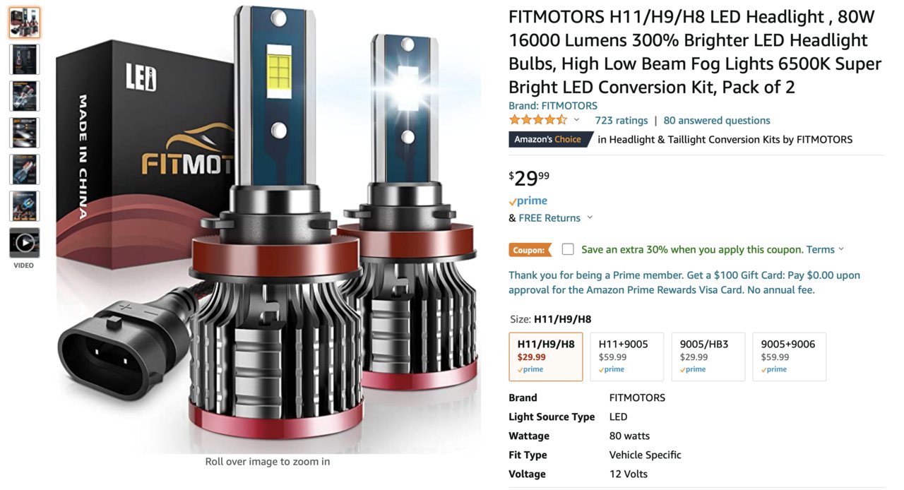

    Cheap fitmotors led bulbs

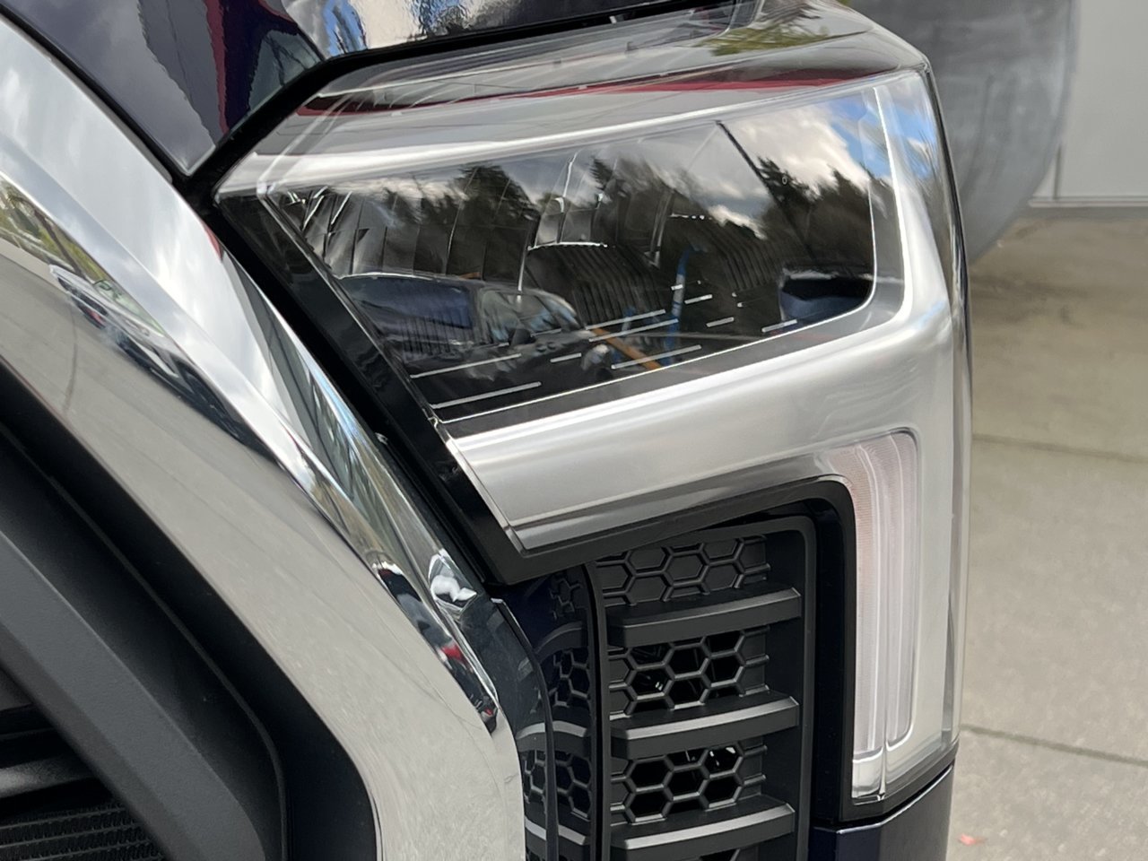

    Little hard to see, but the new Tundra LED headlights use up-firing emitters into a reflector, which is the opposite of the Tacomas down firing emitter architecture. Haven’t tried them, but noticed it at the dealership today.

    I hope you read the thread, and then realize what you have done. No they are not 80w. They are a massive downgrade from stock. They in no way replicate a halogen in the slightest. You've bought snake oil, and then are likely visually mislead by a short range flood light.

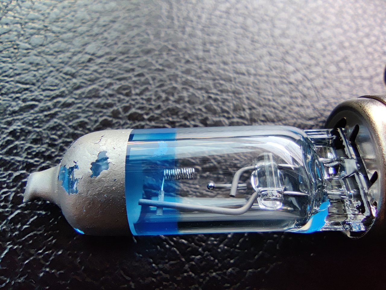

    One of my Nighthawk Platinum bulbs blew in exactly 5 months. Luckily I ordered two sets.
    Is it normal for the bulb cap to flake off?

    Seems to be hit and miss. I've had various 9003/h4and 9006/9012 bulb caps flake, and some not.
