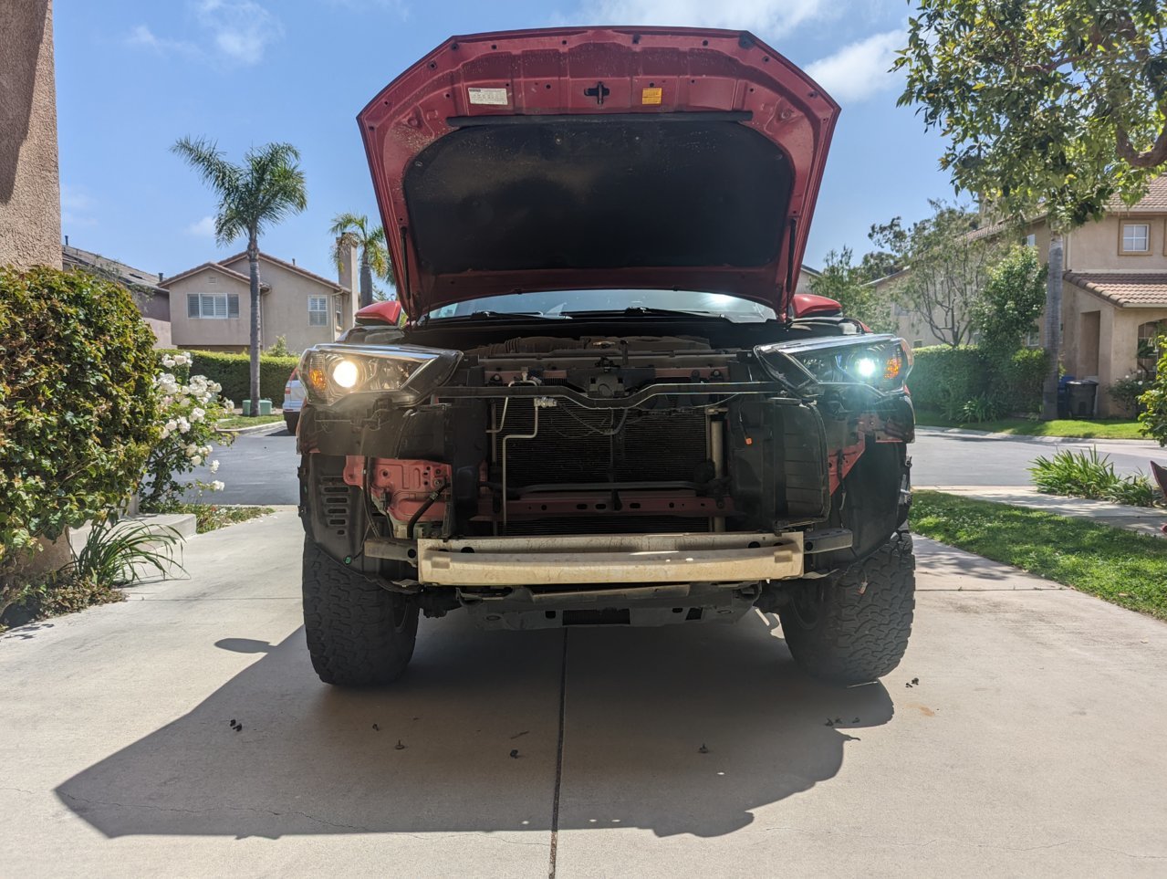

    To answer this part of your question, people are referring to the stock LED headlights that come in higher trim trucks- that is, the entire headlight housings, not just the bulbs.
    If you perform a bulb swap, the recommendations above are correct. If you want "stock LED", you'll need to procure a set of OEM headlights, as you can't swap bits back and forth between them. The whole things need to be exchanged.
    That is what I am up to today- with a little help from @daveeasa :thumbsup:

    The 4runner OEM LEDs are nice! You go with the hybrid lamp and high beam HIR bulb upgrade?

    It's going to get a bit weirder than hybrid- these are 2022 bi-LED headlights from someone with a Pro that "upgraded" to Alpharex headlights :rolleyes:
    This might be spilling the beans a bit early, but Dave created custom headlight adapters for these new 4-pin connectors. 3 pins are populated on the headlight- power to the lamp, power to the shutter, and a common ground for both.
    So here's the plan:
    • Stock high beam wiring in the older truck, connected as normal to function as high beams and PWM dimming for DRL mode (the new bi-LED trucks use series wiring to dim these at 6V each and they are no longer used for high-beam duty). However, the reflector assembly is exactly the same, so hooray for better performing halogen reflectors.
    • Of course, upgrading to Korean Osram 9011 HIR bulbs as recommended here. I have one in hand and waiting for the FLAPS to restock.
    • Stock low-beam wiring adapted to new stock LED headlights.
    • Extra wire lead hanging out of the connector (thanks Dave) for the shutters, waiting to be hooked up to a 12V trigger...
    The goal is QUAD factory high beams :cool::cool::cool:
