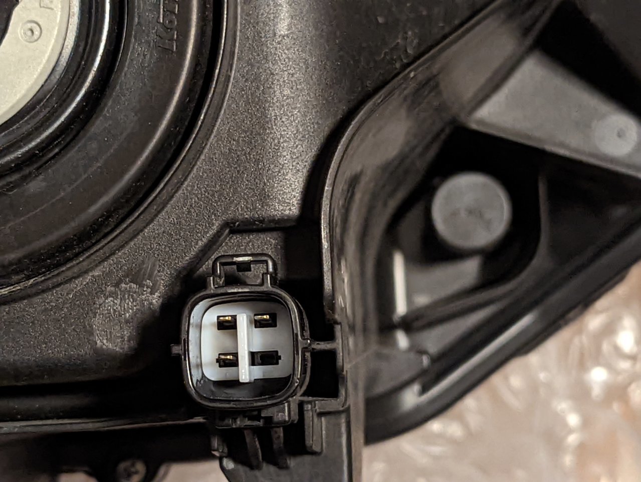

    Hit up @daveeasa to collaborate. He also may decide to make them a regular item in his store. Heed my warning below though.
    That's the general consensus in the 4Runner forums as well. The bi-LED high beams are focused and create a decent beam throw right above the low beam cutoff, but the overall intensity and flood of the original halogen reflectors is much more usable.
    The introduction of LED headlights in the 2021 model was such a strange product mix. Halogen high beams and LED projectors in the majority of trims, with the bi-LED projectors (and halogen DRL only) for the Pro and Limited trims. For 2022 forward they have decided to equip all 4Runners with the bi-LED model. The good news for retrofitting older trucks is that you don't have to activate the shutters if you don't want to, and use them only as regular low beams. Provided that you are using the correct adapter connectors, this will make stock headlight assemblies a lot easier to come by in the used marketplace (from those that are "upgrading" to the Chinesium stuff).
    Warning: you will need to figure out a way to prevent your DRL mode from pinging the shutters. Older 5th gen 4Runners use PWM to dim the high beams for DRL duty. If you are using a trigger from the high-beam circuit (like an add-a-fuse), you must not directly connect it to the custom connector. Otherwise, when you turn on DRLs you will rapidly signal the shutters at a high frequency, which may wear them out or destroy them.
    For now, I am connecting them using my existing switch for my Diode Dynamics driving pods. This way I can isolate them from DRL mode (though if I forget to turn the switch off I am still exposed to PWM).
    Eventually, my plan is to create capacitor filters to use inline with the relay trigger. This should prevent exposure of PWM voltage to relays or the shutters. Just gotta get around to it.

    OEM 4Runner headlights and backlit SS3 maxes. The bi-LED models still have those goofy dark spot artifacts at the cutoff, I wonder what the reasoning was on leaving those in.
    I'm also wondering if Toyota has the same projectors in both low and bi-LED 2021 headlight models, and decided to omit the shutter wire/connector on the "cheaper" trucks? It would be funny if someone pulled apart their headlights and found an inactive shutter inside.
    These things do have a ton of swing though. Very obvious real world improvement. I miss the warmer tones of the halogen headlights though, oddly.

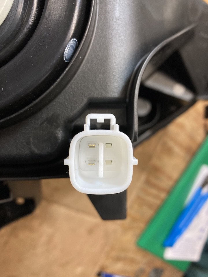

    The connectors look exactly the same for both 4Runner LED headlight models, the low only is populated with 2 pins and the bi-LED has 3. It would be funny if the only thing separating the two models is a wire for the shutter.

    Made a harness with single pin weatherpack connectors to the shutter leads. However, I made the old mistake of measuring once and cutting twice, so it wasn't long enough to reach the passenger headlight. Will need to try again another day, and I think I'm running short on wire loom so I need to restock that as well.
    But! I was able to test it on the driver side. Can confirm that it does work to open the shutter! I'm halfway there to quad high beams. Gotta head to a different AutoZone for the second 9011 bulb though.
