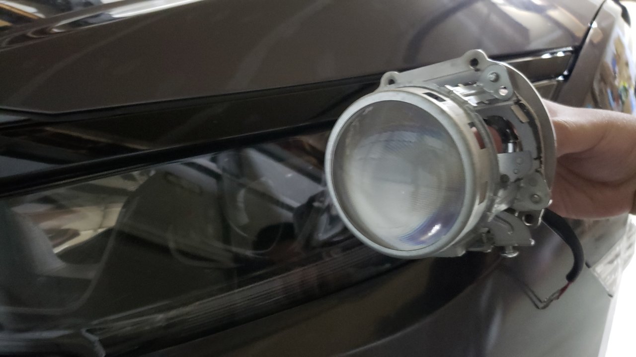

    Happend to me three times! Though the first two were O'Reilly's. And while I lurk this thread, I couldn't stand losing the 9011 on my car if I choose to change my assemblies to factory LEDs. So, while not my final decision, I ended up buying these to hoard:
    RX350 projectors...

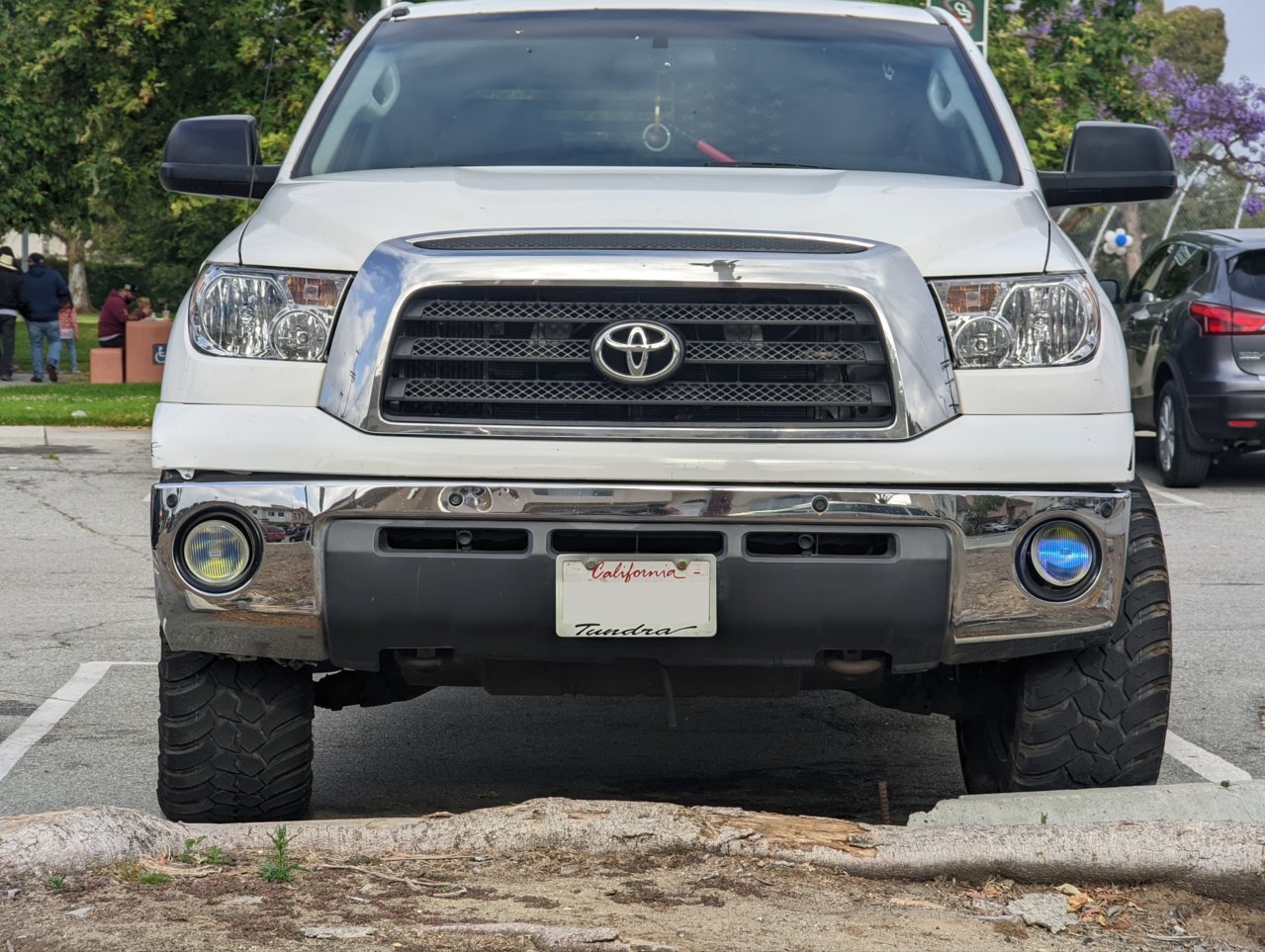

    Speaking of which, check out this guy's "annoy oncoming traffic" mod.

    and the owner can sleep tight with that club on the wheel.

    Sure, but it won't stop someone intent on fucking with him lol. They can always just take a bat to that fog light and anything else they don't like :/

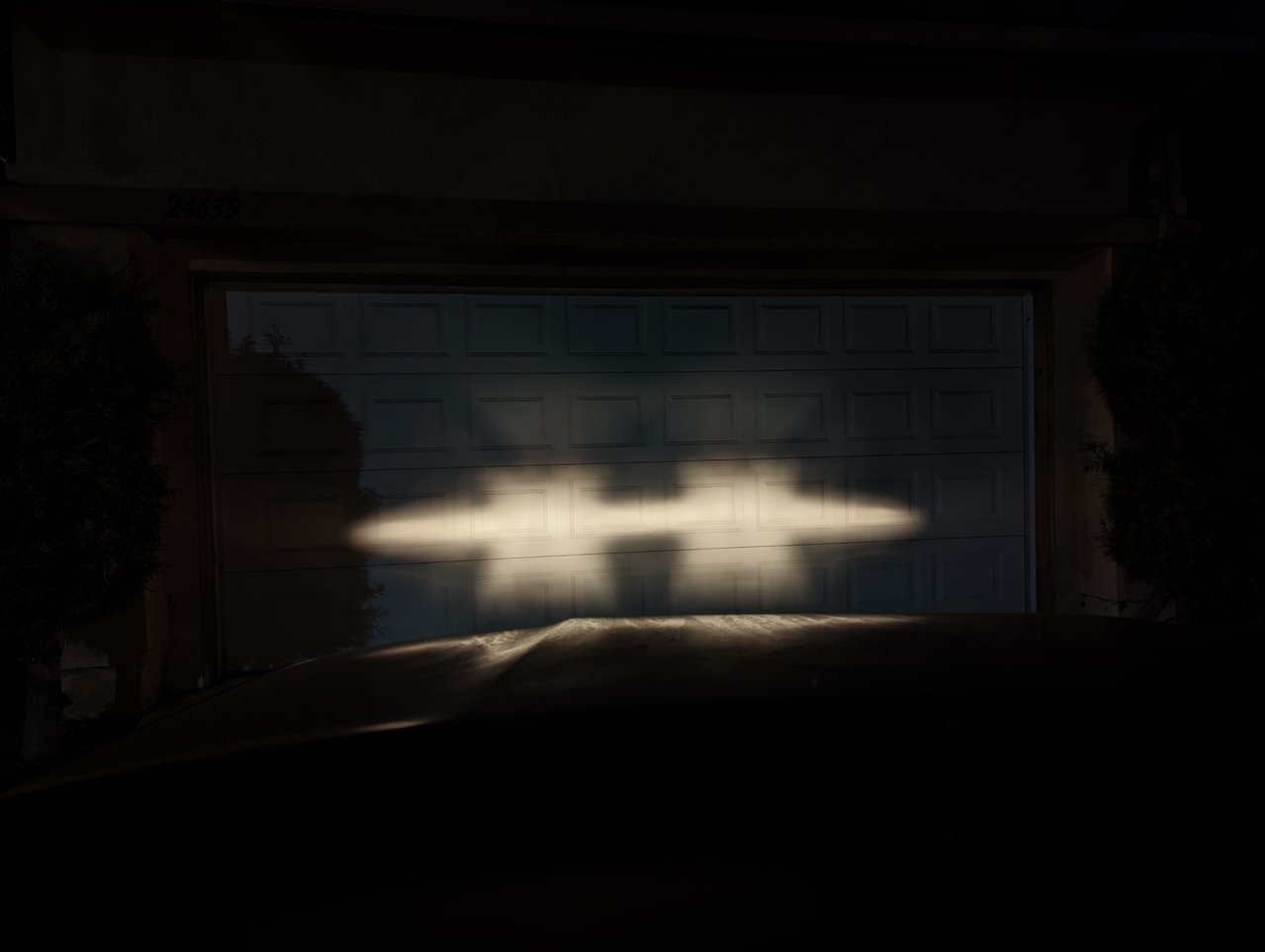

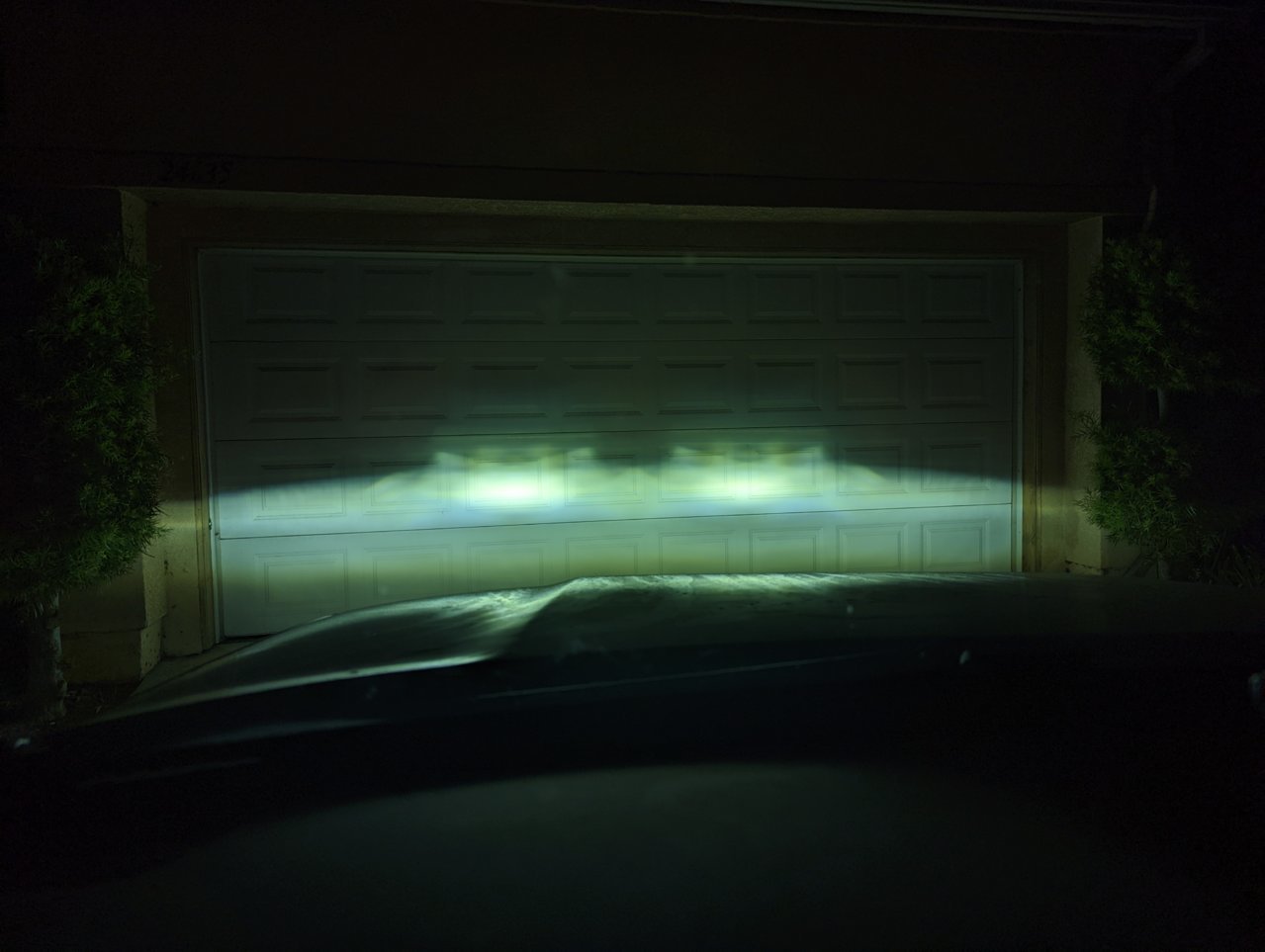

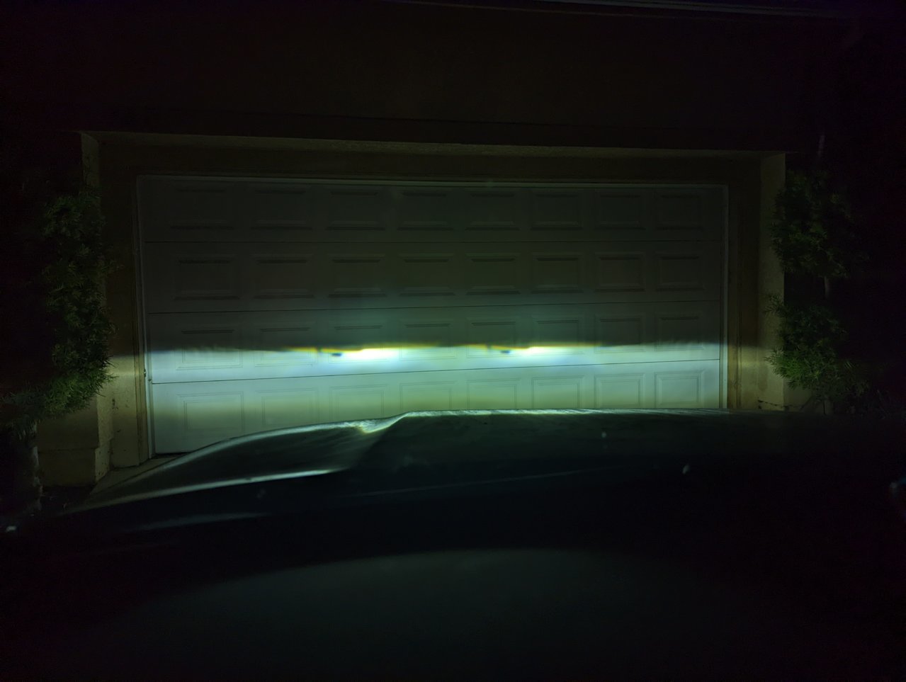

    4Runner LED projector vs halogen reflector high beams. The color and exposure is off on these photos, as they're just quick shots in auto (with Google tuning the shots as it sees fit). The LED isn't really this blue/green.
    LED low beams
    LED high beams
    Halogen high beams (actually, this is just DRL mode with a longer auto exposure). But useful for showing the beam pattern.
    Both high-beams on
    You can see that the LED projector high beam just adds a punch right at the existing low beam hotspots, while the halogen pattern has "boxes" that spread out to create more flood light for improved foreground and peripheral illumination.
