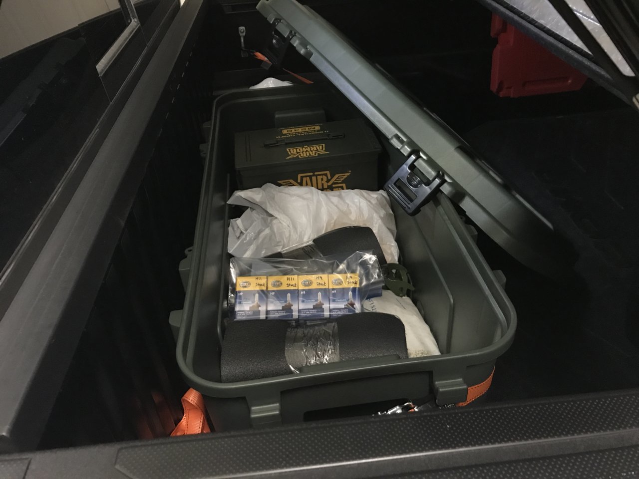

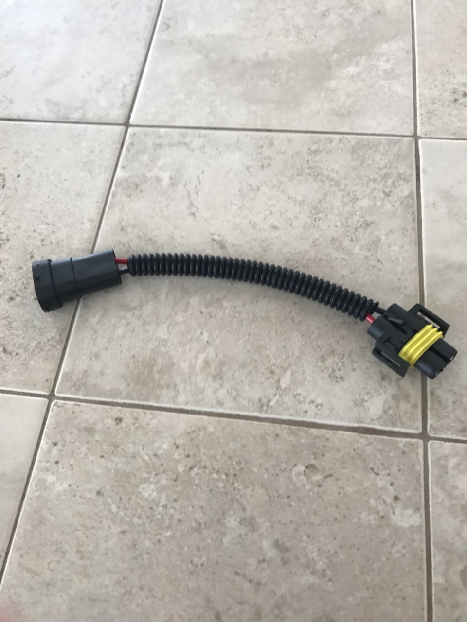

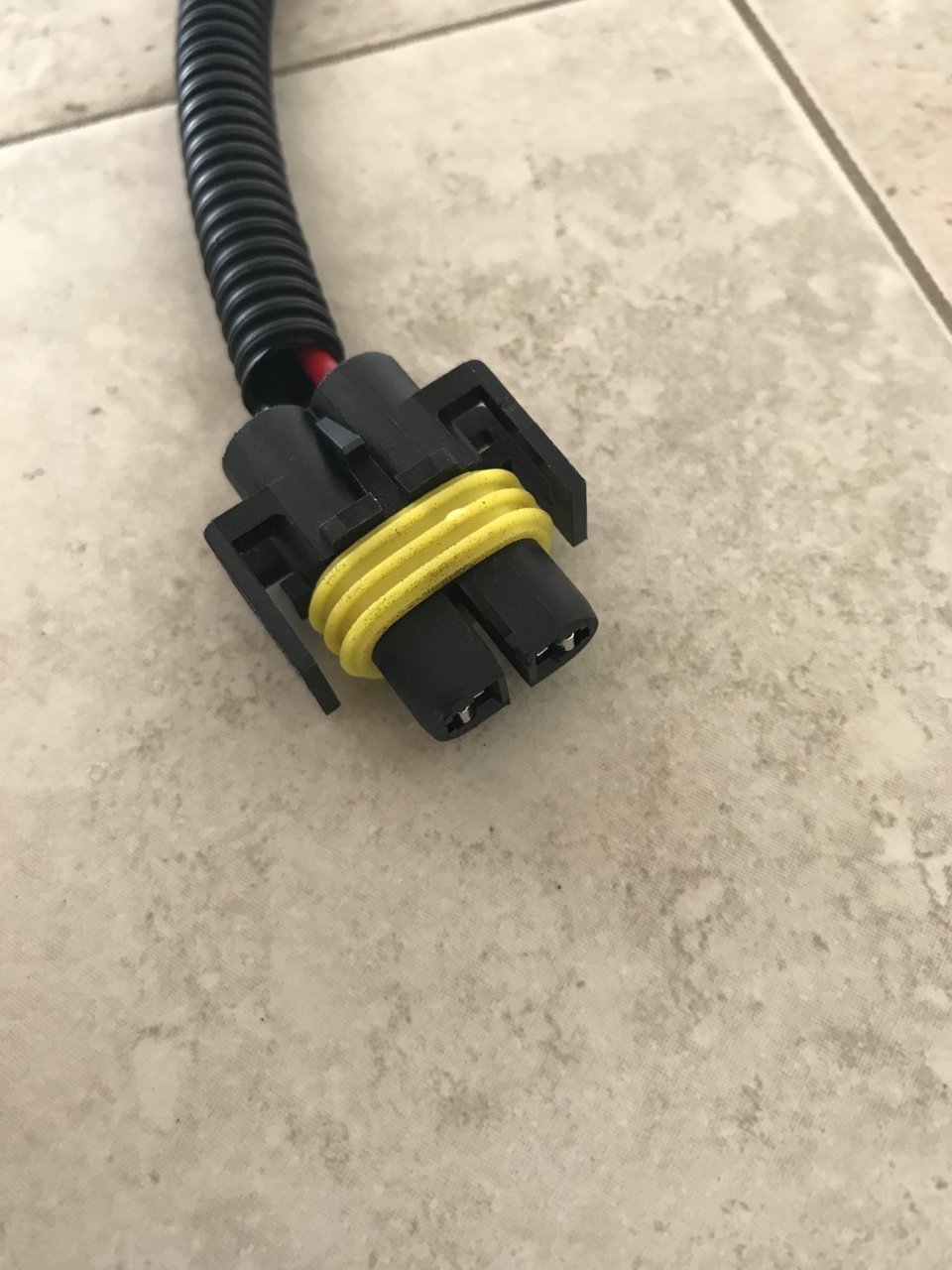

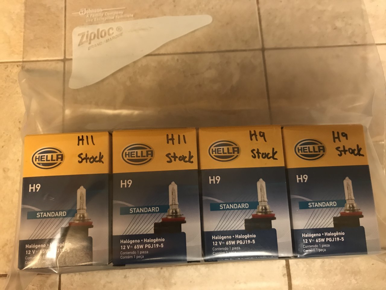

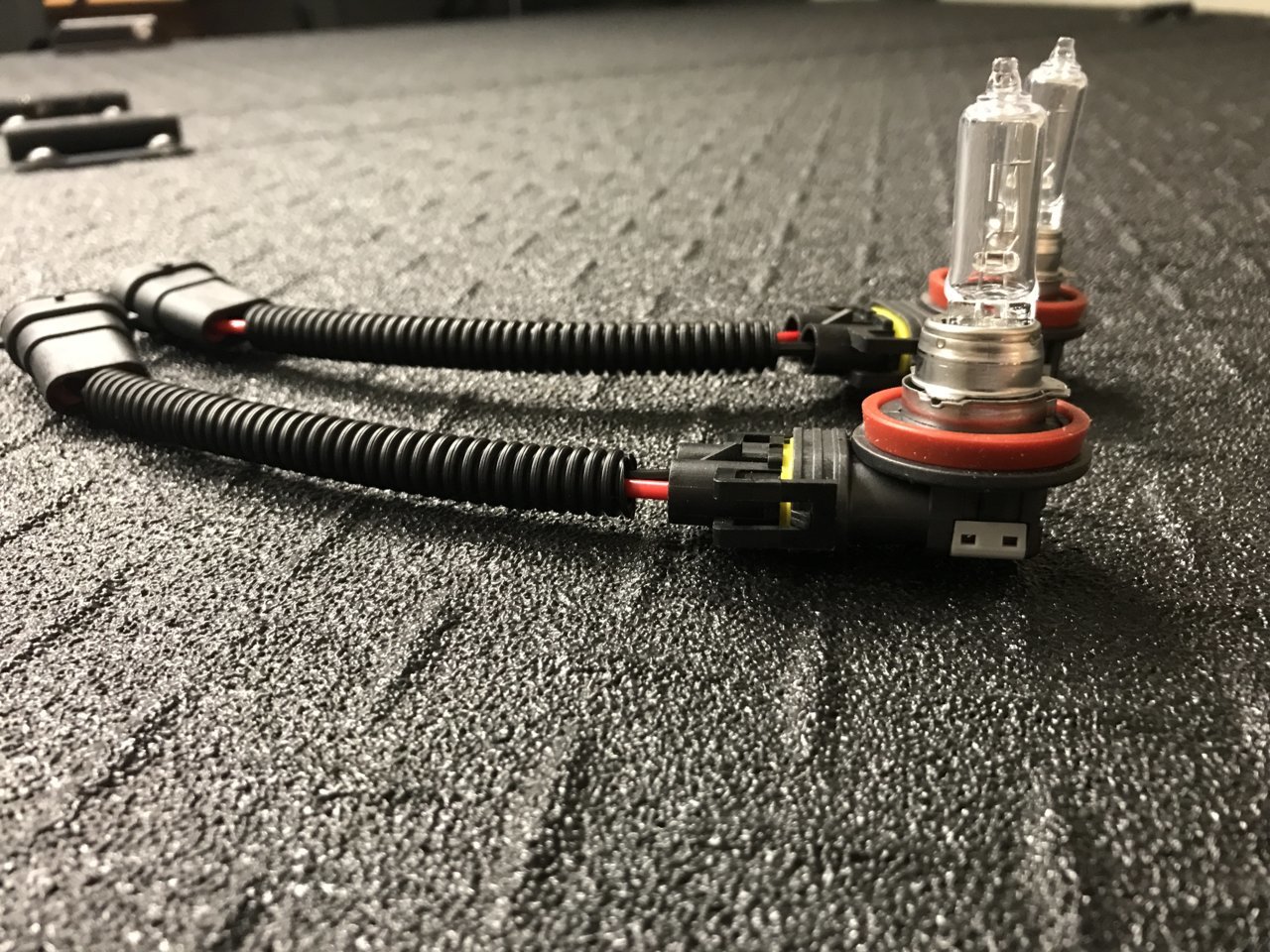

    Finally received my Hella H9s from rallylights. Ordered mid February and received them today; however, not their fault as they've been swamped with tacomaworld orders. They had to be dropshipped from Hella. I ordered the harness on ebay and took a dremel right down the middle. Installed tonight and I'm excited to see the difference on the road! Put the stock bulbs in the boxes from Hella and put them in my tub in the bed in case the hella's burn out on the road. Super appreciative of you crashnburn, this thread is amazing!!

    I thought the point of the harness was to make the hella bulbs plug right in with no modifications

    Yeah, you just dremel the plastic away down the middle on the harness and they're plug and play. You can see the H9s plugged into the harness in my 3rd pic.

    The harness you’re thinking of isn’t made yet. The harness he posted is the way to go if you’re not wanting to wait for Rally to make it.

    Ahhh okay.
    Oh okay, I guess I misunderstood how the harness was set up. Simple enough tho to just dremel it

    That is correct. Still waiting on the H11->H9 HD plug and play harness. But Headlight Services said they would make it.

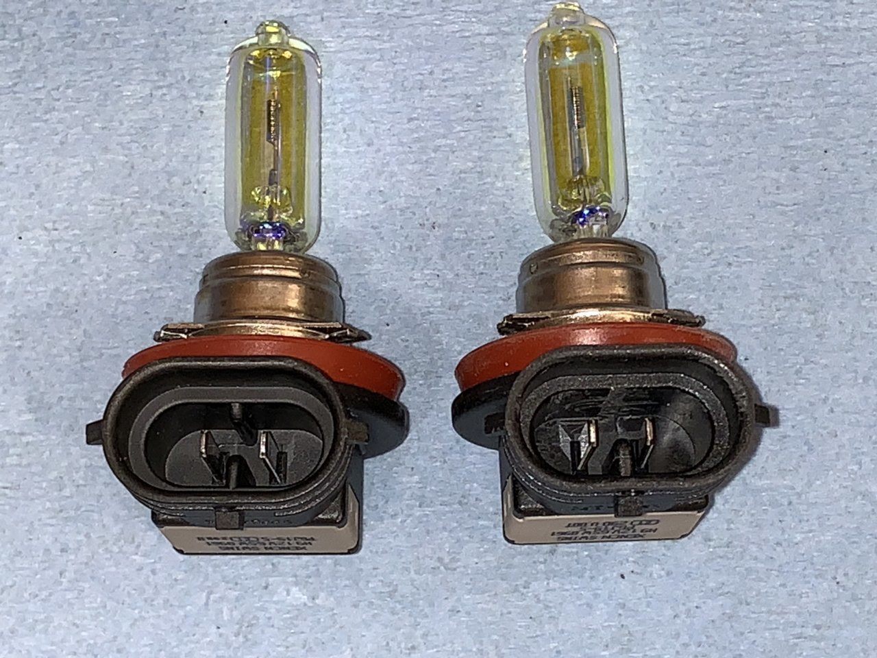

    Good thing you did your research ahead of time. The Hella Osram Hypers are easily the best bang for the buck, referenced in post #2 of this thread. You will need to trim an internal plastic tab with a small knife for plug and play.

    Yep, use a small knife and remove the internal top tab of the bulb as shown below. If not wanting to do that the GE +130 H11s are an excellent option. I realize the Rigids came on the Pro, I was just pointing out there are much higher performing options available than what Toyota included on the truck, if you were interested in upgrading.
