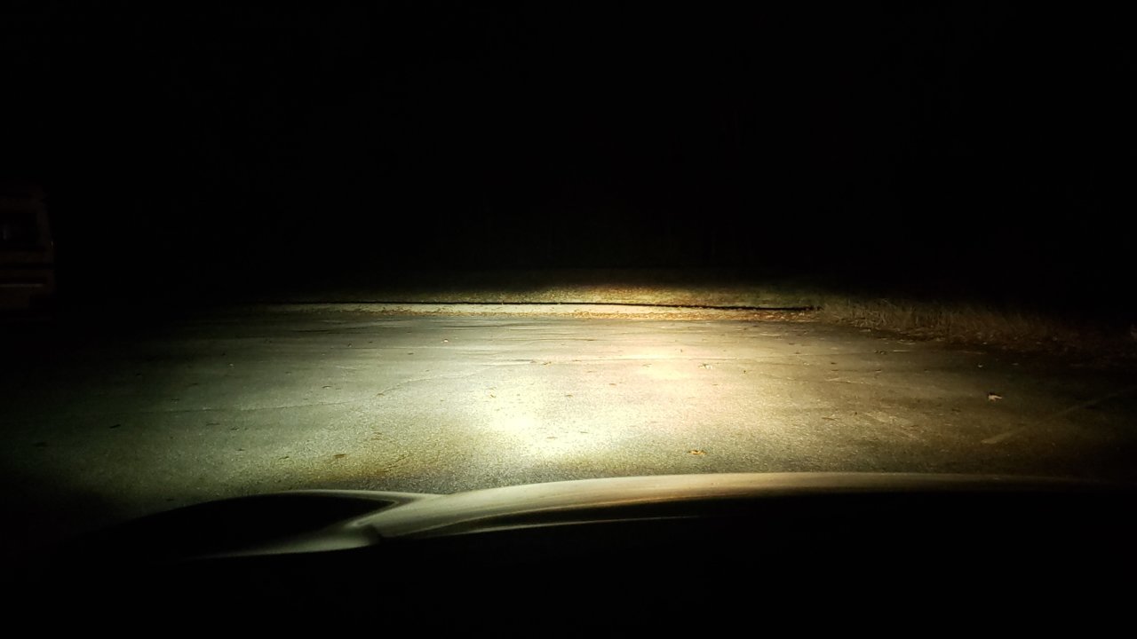

    Just to add my limited knowledge. Not all halogen assemblies take to PnP LED bulbs well. From the Jalopnik article linked to the Civic's assemblies,
    “...Occasionally it’s possible to happen upon a combination of one of these ‘LED bulbs’ and a particular headlamp that works acceptably.” (For example, DiodeDynamics has a particular ‘LED H11’ Stern recalled being successful in a particular Ford truck headlamp housing)."
    As shown in the 3rd gen Tacoma, a "well-engineered" LED can beat a stock long-life halogen. However, the same LED bulb preforms worse on the 16-21 Civic. A high-performance halogen still works best in both assemblies. Unfortunately that doesn't stop uninformed consumers from using PnP LEDs. It's very easy to succumb to marketing claims and the long service life (especially on cars where the only way to change the headlight bulb is to remove the bumper cover). The added foreground, combined with the additional glare, trick consumers to a false sense of security. In reality, they lose vital distance.
    Though not a great photograph, here's a comparison between an H11 LED and the stock halogen on the Civic.

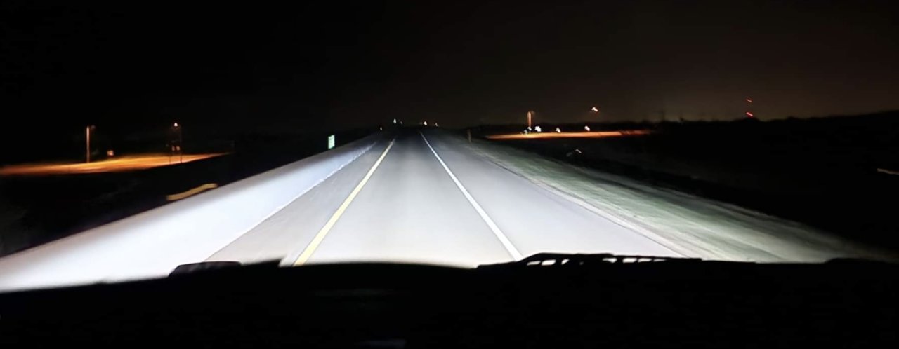

    Even the output shots on your website are predictably horrible. You have massive increases in foreground light with clear loss in distance light. This leads people to think the product is better but you've actually completely altered the headlight pattern. Foreground light should be minimized while distance light is maximized. You have effectively made the vehicle lighting less safe while also misleading the driver to believe it is safer.
    If you stuck to performance halogens, not only would the light shine further giving serious lighting performance advantage, you wouldn't blow out your night vision with massive amounts of foreground light. If you want to send me a product to compare I'll gladly share how it stacks up. But everything on your website and product design looks like the run-of-the-mill stereotypical LED product that fails to acknowledge precision optical engineering as the number one contributor to actual product performance. In that category for LED, so far no-one does it better than Morimoto. But even the best LEDs are easily beat out by far less expensive halogens from Tungsram and Philips.

    So I bought a couple sets of the Phillips X-tremeVision 9008XVB2 bulbs for my Father's 2019 F-250 almost 2 years ago. He complained the light output was awful and couldn't see well at night. After installing these bulbs, he said the output was better. I hadn't driven the truck at night with the original LL bulbs, but even with these better bulbs, the light output is still awful.
    Maybe I'm used to my 4Runner's OEM LEDs, but despite the F-250 having quad-beam headlamps, I felt like I was driving with only the DRLs on. The beam pattern seems very dim and narrow. Any Ford people here know if Ford has LED assemblies for these trucks? @Pugga

    Unfortunately that generation F150 has awful headlights, given the lowest possible rating by IIHS. There are OEM LED for that Gen, but they are also just as bad, again receiving the worst possible rating from IIHS. The next Gen 150 has substantially better headlights. The F150s short and wide reflectors offer the absolute best case senario for PnP LED, hence why Diode Dynamics used them to try and show an LED could pass compliance. Best bulb would be the Tungsram Platinums, but it will only be a minor incremental improvement over the Philips Xtremes. This is one of the only vehicles I’d consider possibly trying the Morimoto PnP LEDs in the headlights. Diode dynamics claimed compliance with the SL1 and the latest Morimoto 2stroke 3.0 has better focus and optical design than Diode Dynamics SL1, however it is also 25%+ brighter so it could cause excessive glare and other compromises in the pattern typical with PnP LEDs. Another option is to consider the Morimoto headlights, though they are not perfect either. They lack uplight, so your vision is going to be restricted by the sharp cutoff blinding you to not see beyond your low beams. For this vehicle specifically, quality retrofits using OEM components is likely the best route.
