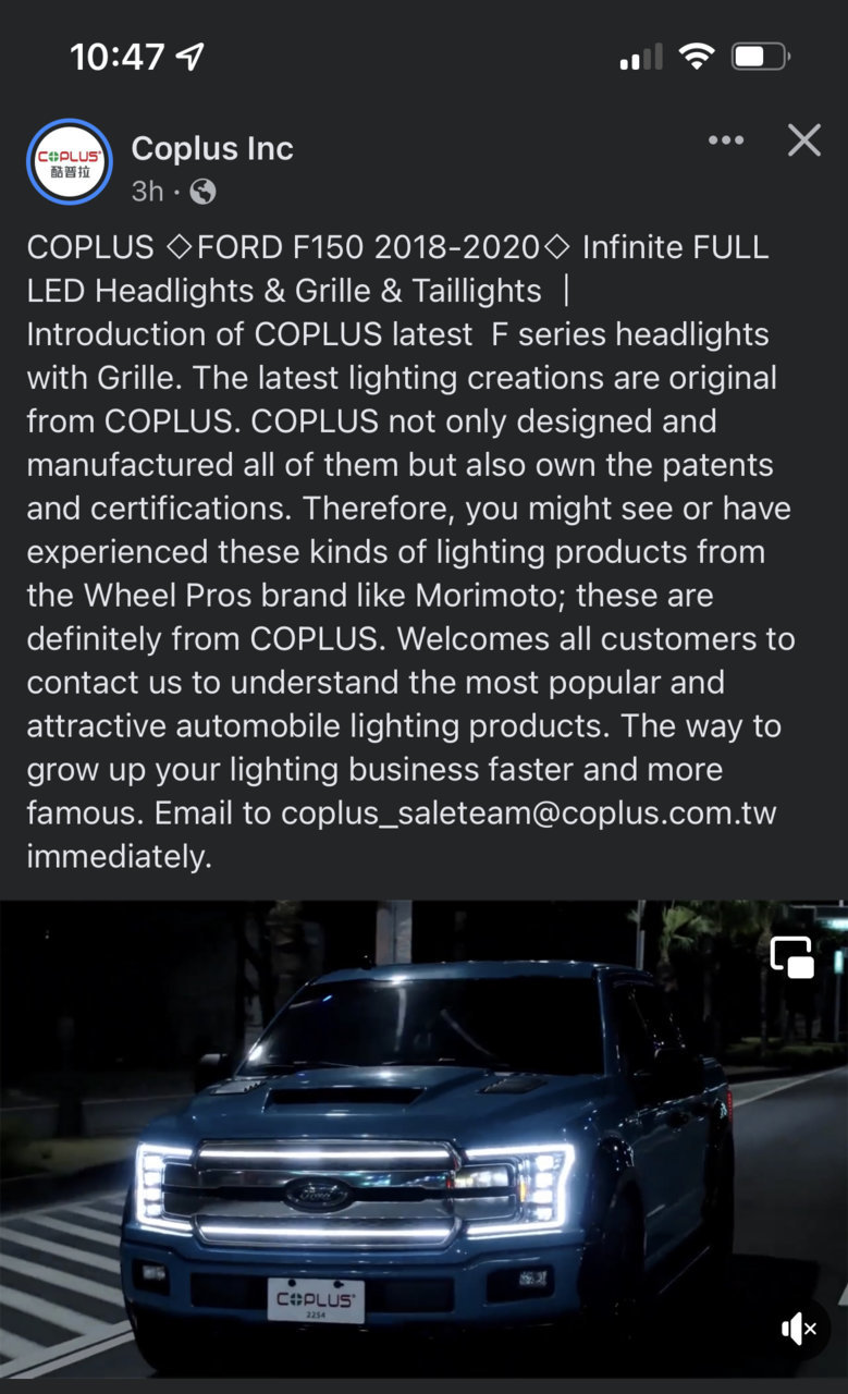

    CoPlus definitely seems to no longer feel the love from Wheel Pros/Morimoto, making it clear Morimoto does not own the XB headlight products anymore and never designed them while aggressively pitching for new distributors to replace Morimoto.
    I'd speculate under Wheel Pros, Morimoto may be shifting to cheaper Chinese manufactures for headlights causing significant quality and performance losses while increasing profit ratios and souring relations with Morimoto's previous exclusive higher end Taiwanese CoPlus headlight supplier. CoPlus, the sole manufacture of Morimoto XB headlights, continues point out they are no longer with Wheel Pros/Morimoto, and looking for business to replace them.

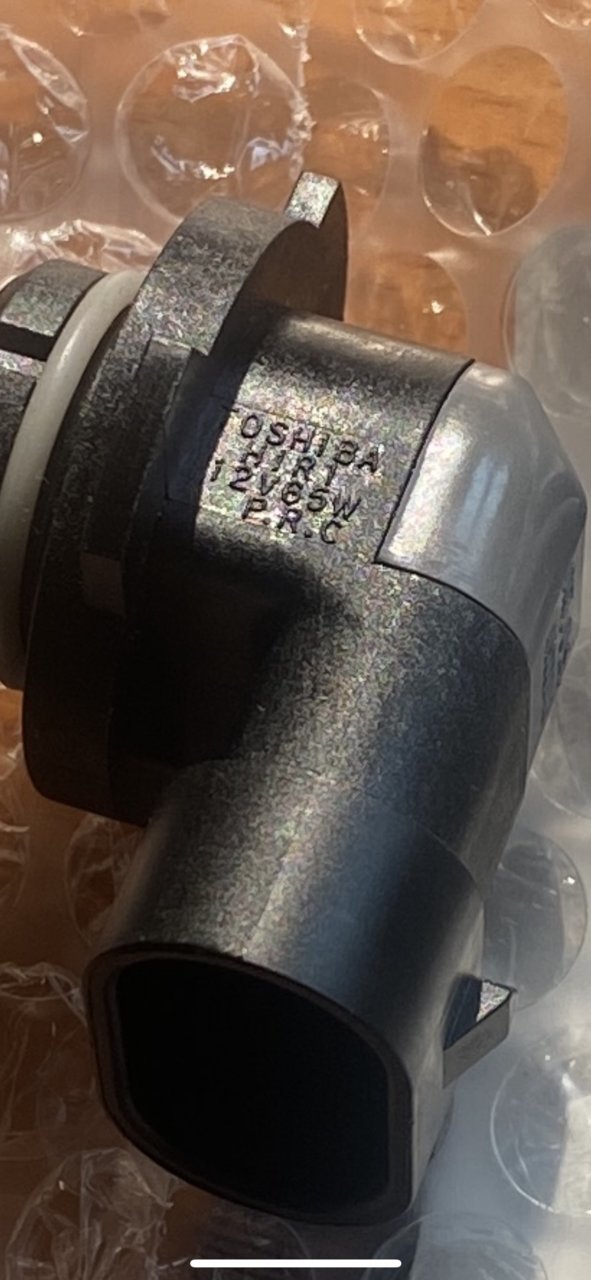

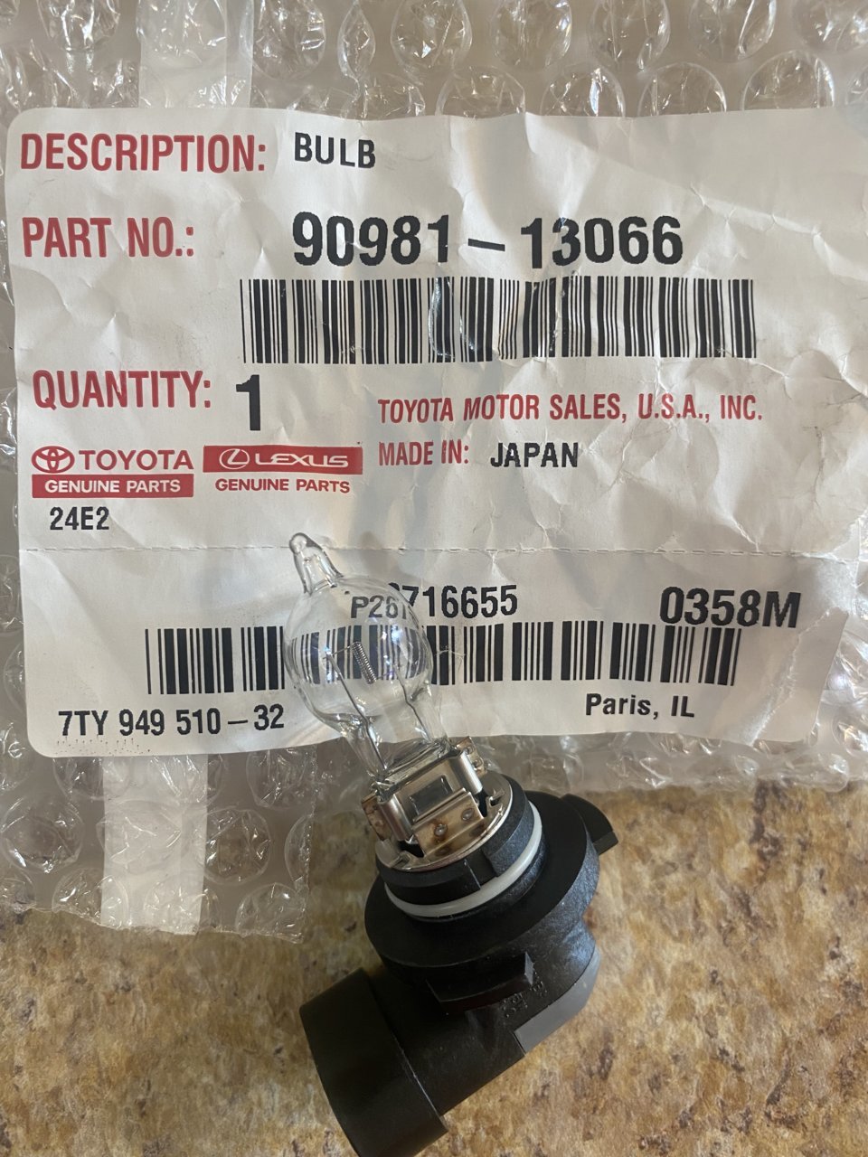

    Bought two sets of Philips 9011 bulbs in May and installed it in the wife's Sienna. One burned out and put in the second set of Philips 9011 last week. I usually like to have a extra set on hand just in case they burn out. Found some Toshiba 9011 bulbs from local Toyota dealer for 28$ plus tax each. Part number is 90981-13066 if you're wondering.

    Hmmm, appear to be HIR too. Interesting.

    Those were available under the ACDelco brand on Amazon, but they superseded the part number with non-HIR bulb versions, I’m not seeing the originals on Amazon anymore. The new Korean Sylvania 9011s are still a little better, but a bit tricky to find since they are not distinguished between from the lower performing German bulb.

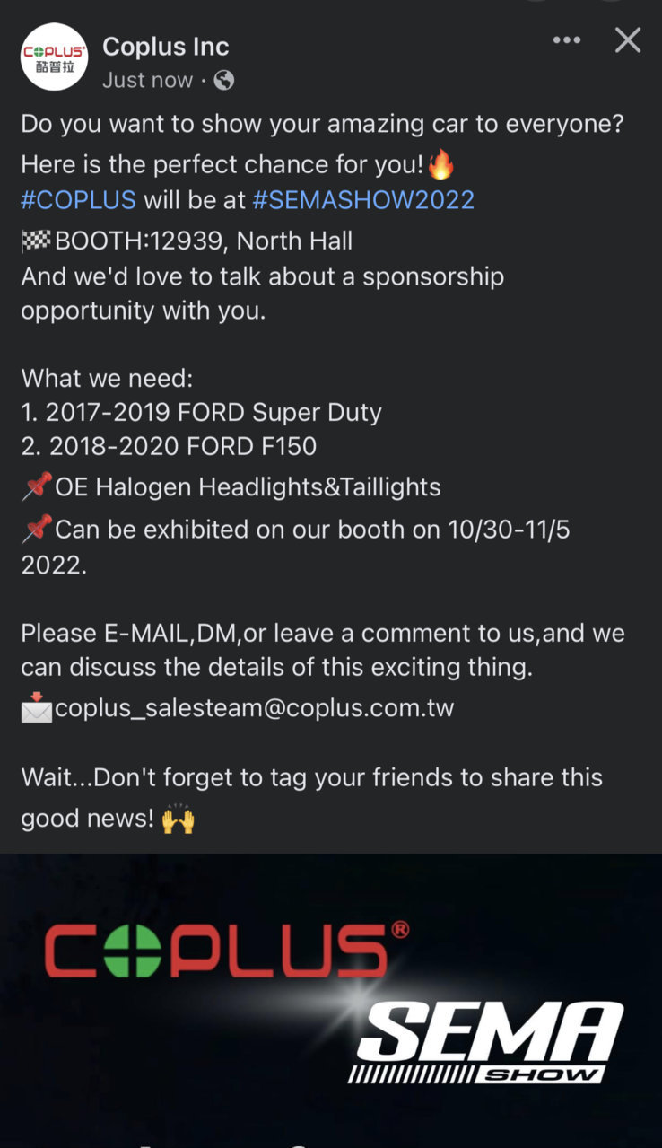

    CoPlus appears to have free F150 LED headlight assembly upgrades to those willing to lend their truck in the Vegas area.
