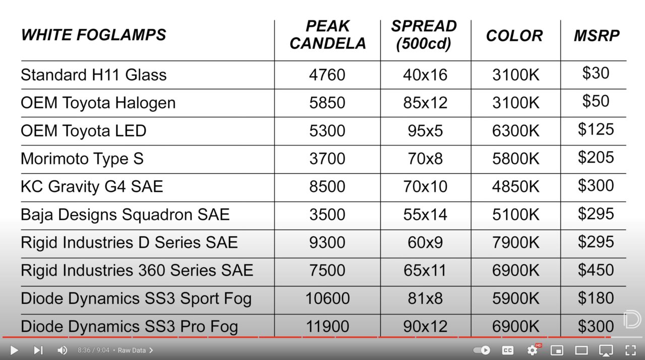

    Little off topic but does anyone have beam pattern of the oem halogen fog lights and oem led fog lights (not the Rigid fogs on the TRD Pro)

    Yes, it is covered in the SAE fog thread. I can provide links in a bit.
    Link?

    Is this the one you were talking about? Post 724 in your thread.
    Do you happen to have the halogen fog output picks as well? I just got done installing the oem LED fogs and it was surprisingly easy, even compared to my old Scion which was already very simple, just more clips and bolts.
    Also, how would you compare the Tacoma OEM LED fogs to the reflector style Lexus LED fogs you compared in that same thread? I kinda prefer the looks of the reflector fogs compared to the sealed beam looking ones on the Tacomas.

    Yes, and see post #1814 for OEM halogens. Admittedly not the best comparison data in terms of pattern.
    You might also check this out from Diode Dynamics:
    Full video
    https://www.youtube.com/watch?v=d5QAUkDtZEo
    Weird how all the products are the same as the SAE thread. Wonder how that happened. :cool:

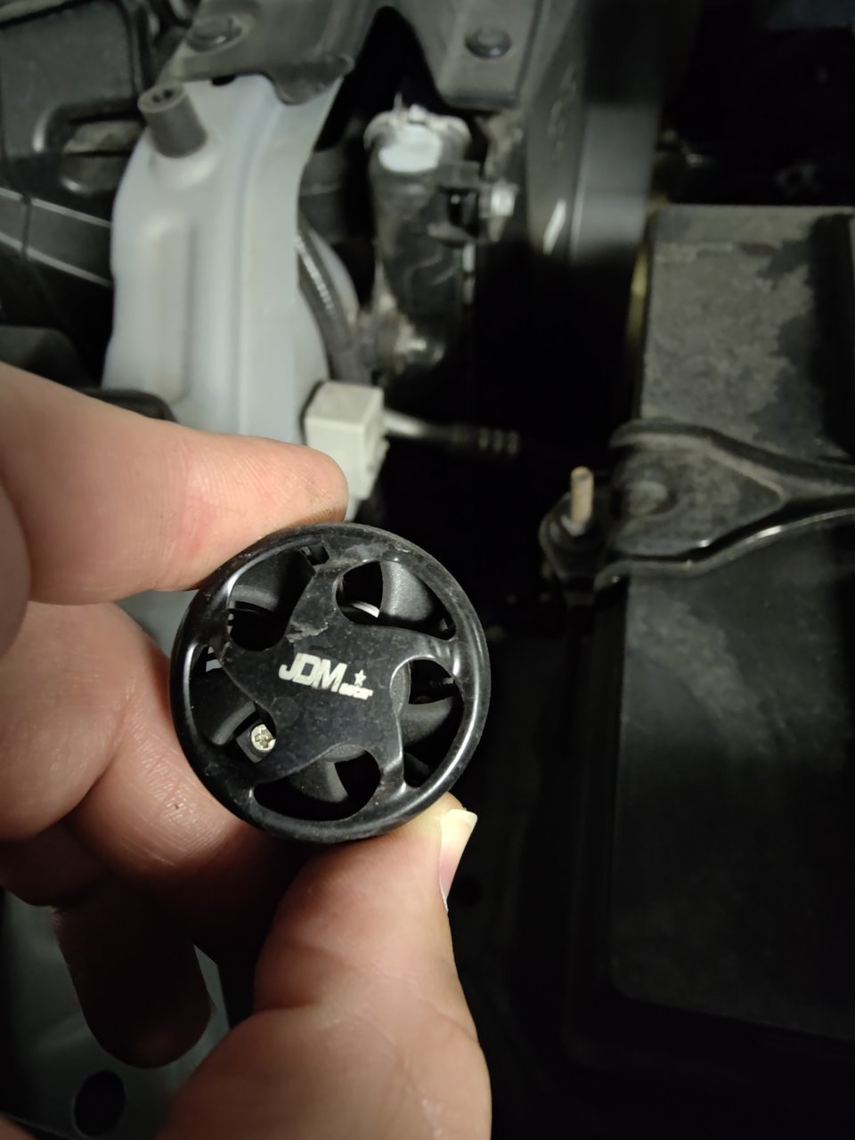

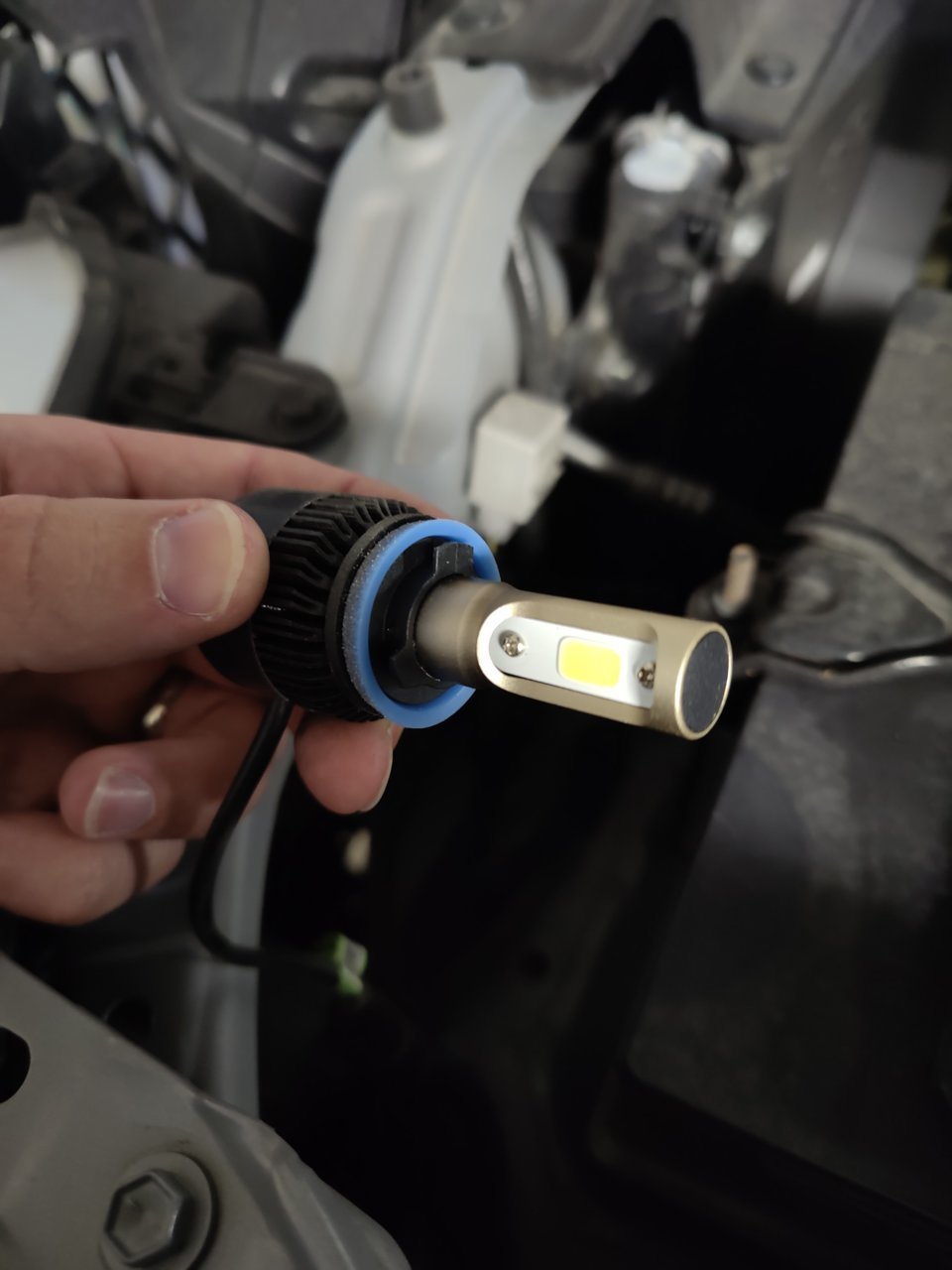

    I was gonna start a new thread but decided this could be useful here. I bought my '19 a little over a year ago with ~9k miles. I'd be curious to know who owned it previously because I wouldn't be surprised if they were on here, given that I've discovered a few "leftover" mods that are popular around here. I imagine there was a lot more done to it, but they probably went "back to stock" before trading it in.
    Anyway, I never gave much thought to the headlights....they worked and changing them just hasn't been anywhere near the top of my priorities. Until they started flickering this week. I've since discovered it has JDM astar LEDs. The driver side flickers almost constantly now, worsening by the day. I haven't been able to track down any cause for it...connections good, corrosion free, etc.
    After reading through many threads, including this one, I've realized that I have incredible foreground lighting, but I use my high beams as often as I can for more distance. Initially I was looking at replacement LEDs. However, I think it's time for an H9 upgrade. I love the color temperature of the LEDs but after reading the science behind it all, it seems like that will be a small trade off.
    I was gonna try to upload a video of the flickering, but it's giving me problems. I'm sure anyone can imagine a flickering LED. Posting a pic of this specific JDM astar.
