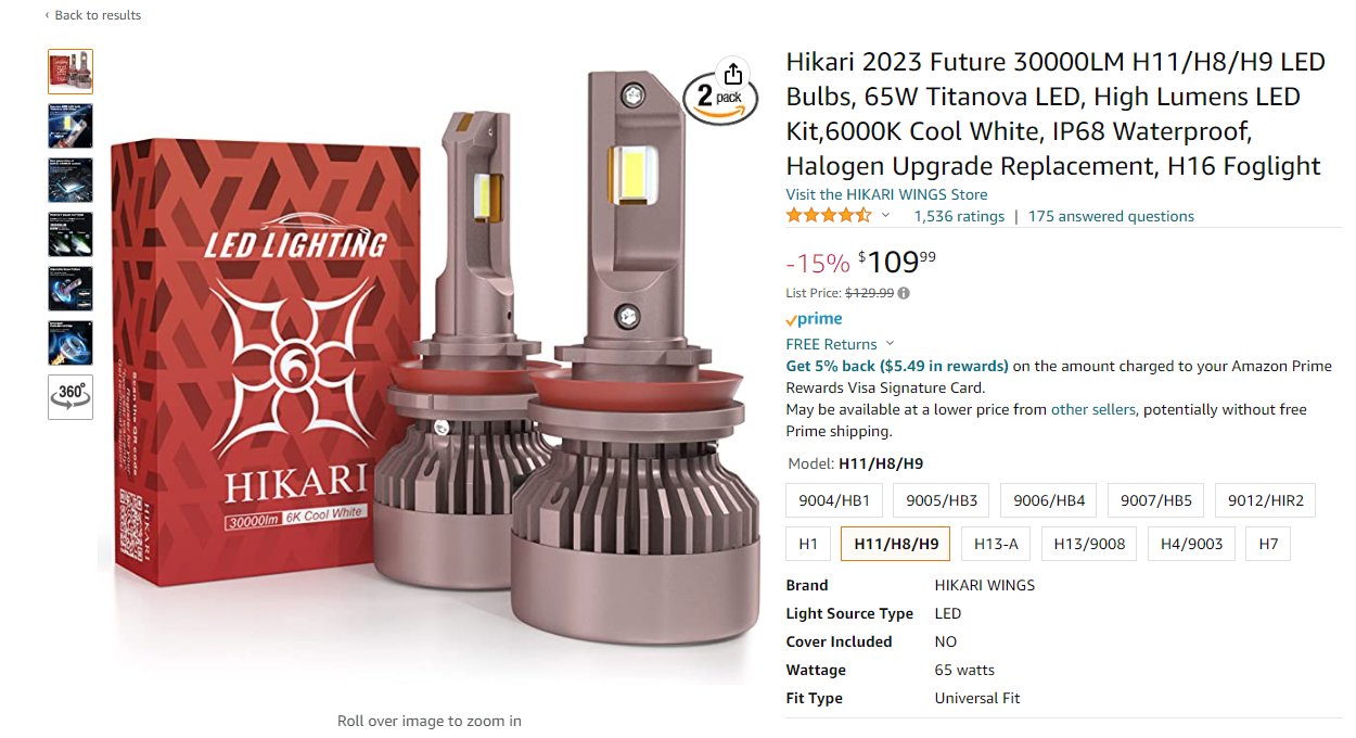

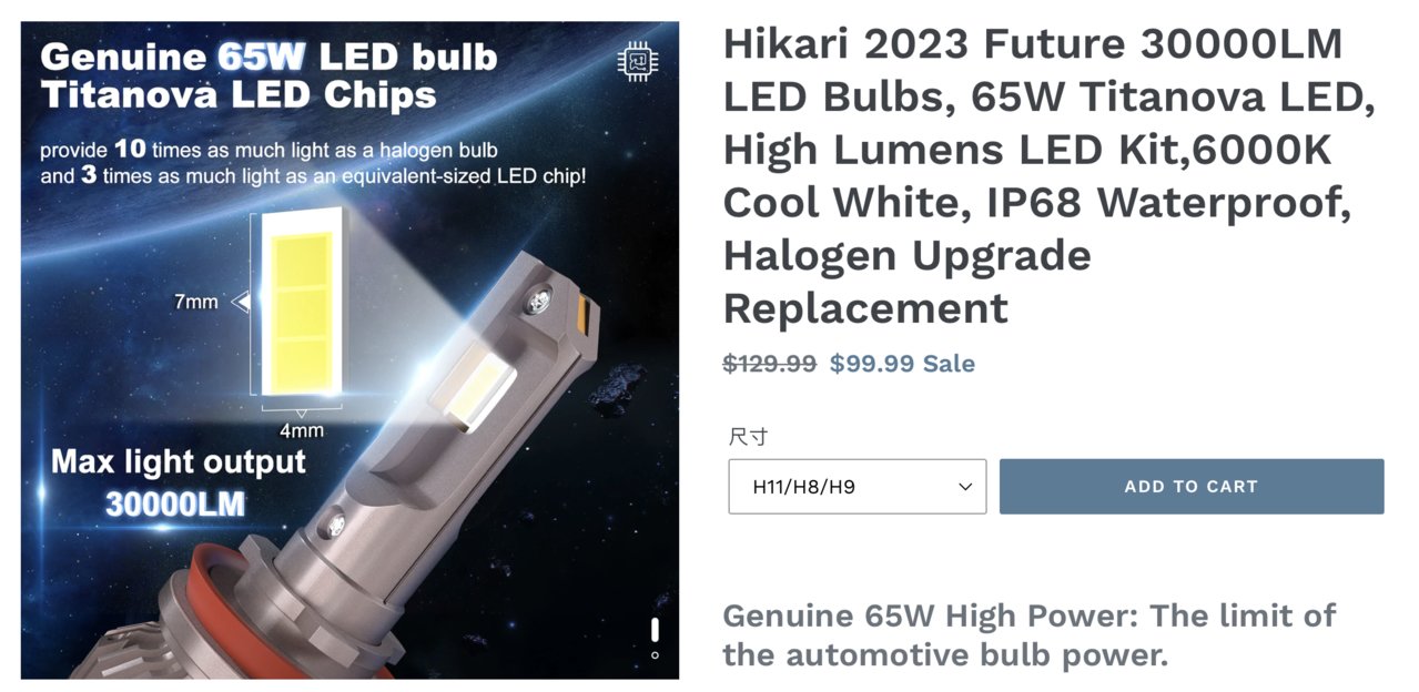

    To replicate a halogen filament the emitter must be 1.42mm around, but for an LED blade design this means 1.42mm tall, as measured below.
    Here is the "Future" Hikari LED. Nearly 3x larger than a halogen filament. Complete pathetic fail. Again they are prioritizing output over focus, just like 99% of the LED companies that have no clue what they are doing, because they are LED experts and not optics experts. Definite pass.
