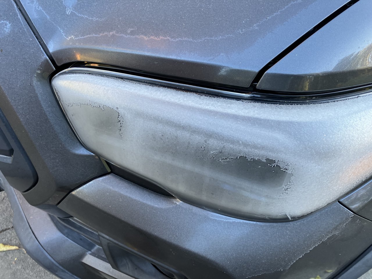

    My commuter is a 2013 VW Passat TDI. The DRL's are burnt out. My arm needs to bend in three places. They're still burnt out.
    Toy_Runner likes this.

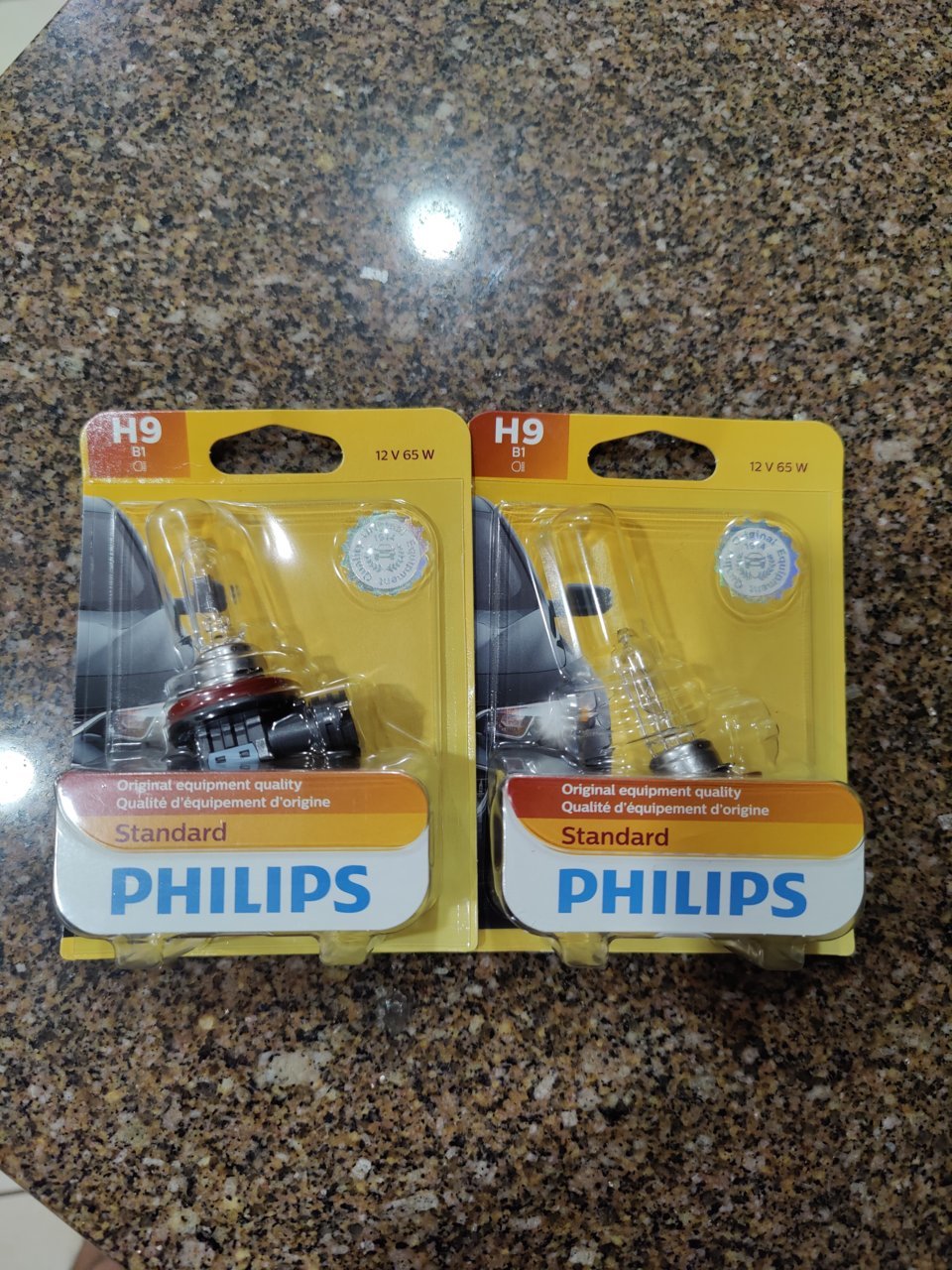

    God this thread is awesome. I just got some philips H9s delivered and installed them, no metal trimming and they fit pretty easily. Huge upgrade and i'm stoked on it. So much so that I may delay this LED purchase indefinitely. My question is - is there any downside to removing the green caps? What purpose do they serve? Feels weird taking them out and just not replacing them with anything
    GrueneGiant and scouterjan like this.
  16. Nov 23, 2022 at 9:32 PM
    #5936
    crashnburn80
    crashnburn80 [OP] Vehicle Design Engineer
    Jun 6, 2015
    #156893
    14,751
    Kirkland, WA
    2003 DCSB TRD OR
    They serve the purpose of making sure you install an H11 bulb into the H11 plug. Remove them, run the H9s and never look back.
