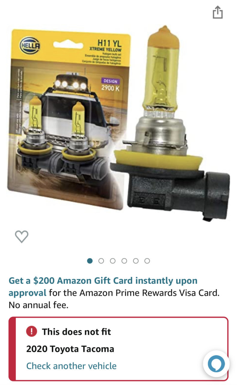

    Is Amazon wrong? I want to run these in my oem fog pods

    For fogs or headlights? Those will not fit your 2020 fogs, only 2016-2019 TRD fogs. They will fit your headlights, though yellow headlights are not legal.

    For fogs. I want a yellow non LED direct replacement

    2020 fogs take H16s. You'll have to find older (2016) fogs; those took H11's.

    H16s are an exceptionally low performing bulb, you will be far better off upgrading the housing rather than trying to improve the performance of the H16 fogs. Even if you do not choose to go with LED, getting a 16-19 OEM TRD H11 fog assembly on the second hand marketplace and using H11 bulbs will provide a huge boost in output while also providing far more bulb tuning options in both white and yellow.
