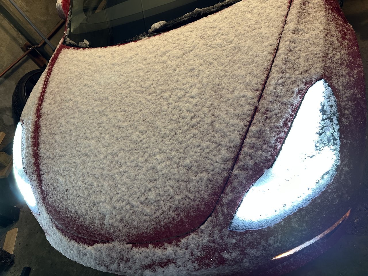

    I know it isn't a Tacoma, but tis officially the season for LED headlight failure due to snow.
