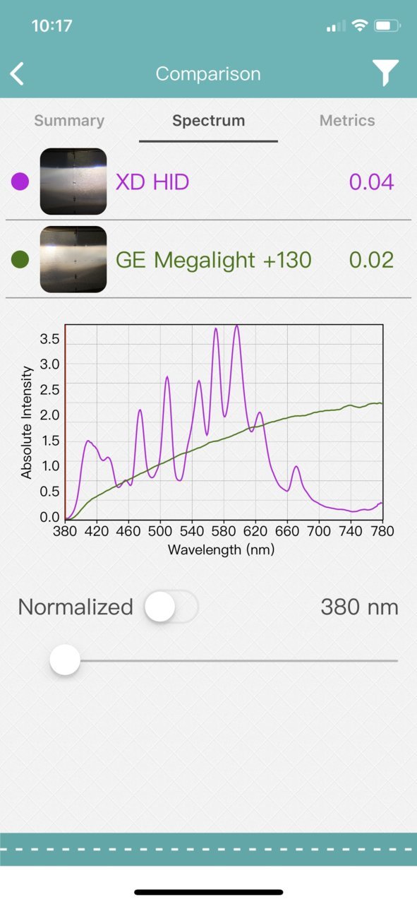

    I had the standard XD 4300k kit installed for a kit a week before I pulled it. I thought the light was too blue still and had lots of glare in blowing snow. I replaced it with the GE +130s and I feel like they have similar output and performance on the road. You’re not missing anything imo.

    HIDs still produce a good amount of short wavelength light, which is what causes the glare off rain/snow/fog in the air, though they are not nearly as bad as LED. Check out the charts below comparing the GE bulbs to the XD HIDs you previously ran. If you drive in snow a lot, it might be worth considering the Lunex H9 +80 Plasma Gold bulbs which further reduce short wavelength light for better poor weather performance while having almost the same output level as the GE +130s.

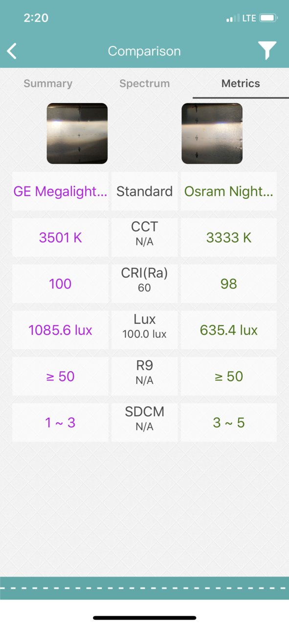

    I found the GE +130 on Amazon and also saw an osram +150 offered in h11. is the GE still superior or is the trade off lifespan?

    You would think the +150 would be better, but I think they went way overboard on the performance robbing blue coating. Their performance was disappointing.
    GE Megalight +130 vs Osram Nightbreaker +150

    Oh WOW! that difference in lux is far greater than I expected... and favoring the underdog (on paper). I really appreciate that you've already empirically measured and compared the two!

    The extent of the difference was a surprise to me as well. I have built a standardized test setup and all my results are saved in a database, so I can easily pull up and compare any 2 light sources that I have tested on the rack. It is exceptionally convineint.
