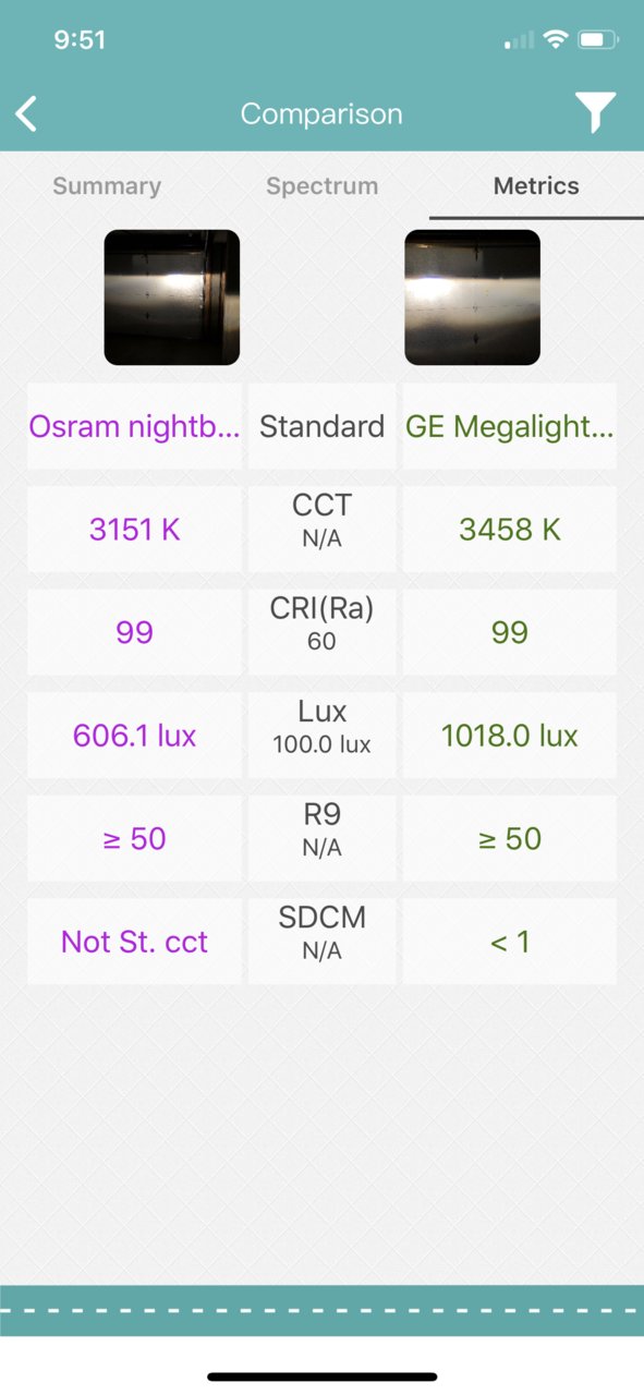

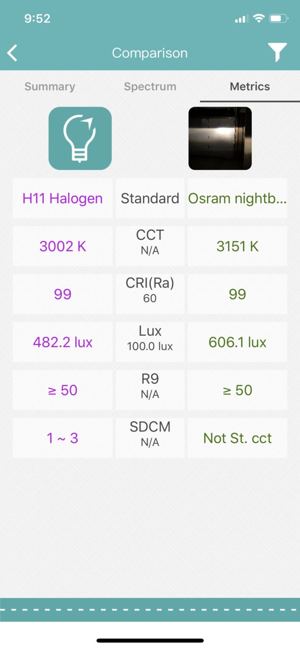

    The first page has the info you need in comparison to stock. BUT, since I'm feeling nice today, here ya go:
    Here is a comparison of stock vs the Osram +100.
    Here is a comparison between the same Osram +100 vs the GE +130.
    You can see the GEs do quiet a bit better than the +100s, although the +100s do better in bulb life.

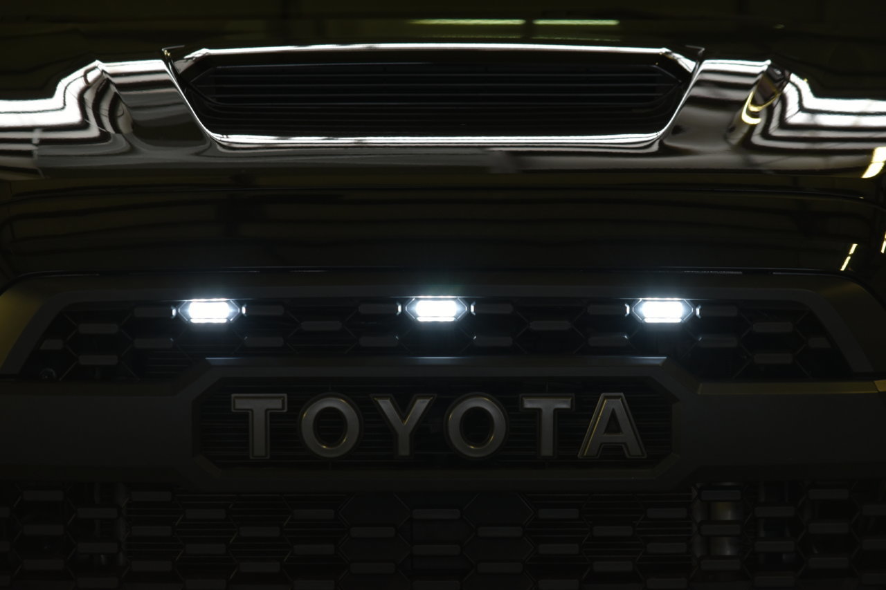

    Runnin 4 tacos raptor lights?
    darkfader[QUOTED] and r1200gs4ok like this.
  4. Mar 7, 2019 at 8:07 PM
    #584
    darkfader
    darkfader Will this fit without rubbing?
    Jul 29, 2014
    #134971
    663
    Josh
    West Virginia
    2018 DCSB6MTFTMFW
    Yes sir
