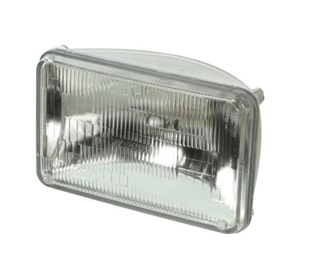

    All modern passenger vehicles have composite headlamps. Composite lamps are vehicle specific, molded plastic headlights designed to contour to the vehicle, often including low beam, high beam, blinker and running light in a newer vehicle, which utilize replaceable bulbs. Compared to a universal sealed beam headlamp, in a standardized sizes like 7" round or 7x6", which only serve the headlight function. When they burn out, you throw away the entire headlight and replace it. These started being phased out in the mid-90s.
    Sealed beam (non-composite)
    Composite
    The sealed beam is simplistic and standardized and will fit many vehicles, the composite is complex and will only fit the vehicle it is designed for. There are conversion lamps to switch from sealed beam use replaceable bulbs. But the reason why I qualified composite, was because companies like JW Speaker and others manufacture LED lamp conversions for sealed beam vehicles in the USA, but again they are the standard simple universal sizes and not the far more complex vehicle specific composite style lamp, which until DD recently started production, only OEM's had manufactured composite lamps domestically. Composites are far more expensive to manufacture, and due to only fitting very specific vehicles (unlike the somewhat universal sealed beams or sealed beam replacements) you end up with a more limited market for the lamp that is much more expensive to produce.

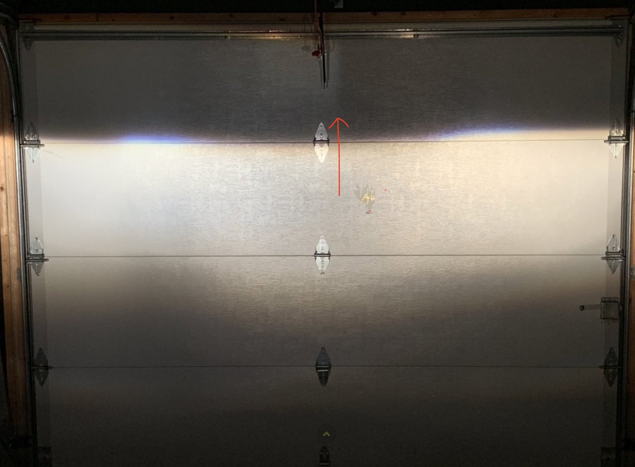

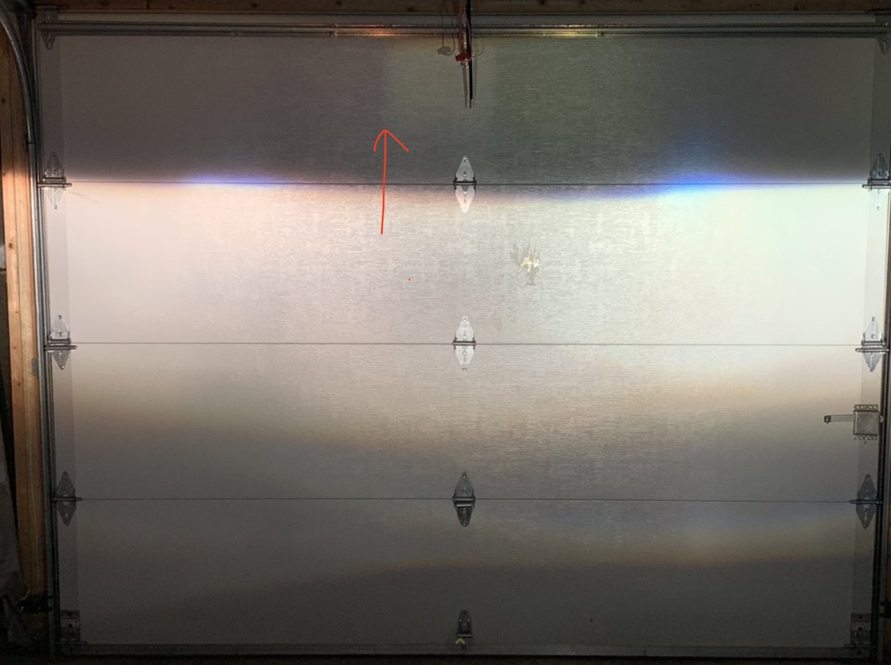

    HID Glare
    This is the GE/Tungsram +130 vs stock. The performance H11 is 74% brighter than stock, including increasing the uplight/glare. Look at where the arrow is pointing and the uplight/glare increase is easily noticeable on the GE/Tungsram side. Again, headlights are supposed to have some uplight/glare but it is to be a regulated controlled amount so that it doesn't blind other drivers. The pattern hasn't changed, it has just all become brighter.
    But that is a performance halogen vs stock halogen.
    Here is that performance halogen that has already increased light output 74% vs an HID in a halogen projector. The HID uplight is significantly brighter than the performance halogen, in fact over double the output intensity compared to the performance halogen, meaning it is 3.3x+ more glare than the designed stock allowance with a stock bulb. Even when compared to a significant halogen bulb upgrade, the HID uplight/glare easily overpowers the halogen uplight/glare. And this is the problem. The pattern did not change, it is brighter everywhere, including the uplight/glare. Add to that, that on coming drivers eyes are more sensitive to light containing short wavelength light (whiter/cooler) compared to long wavelength (warmer) and the effect is amplified to the on coming driver.
    An HID projector fixes the issue by increasing output below the cut off, without the excessive light output in uplight/glare, because it is designed for the HID light source, unlike the halogen projector that is designed for more uplight due to a lower intensity light source.
