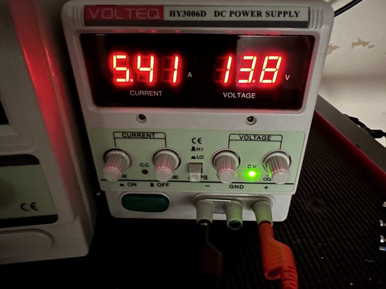

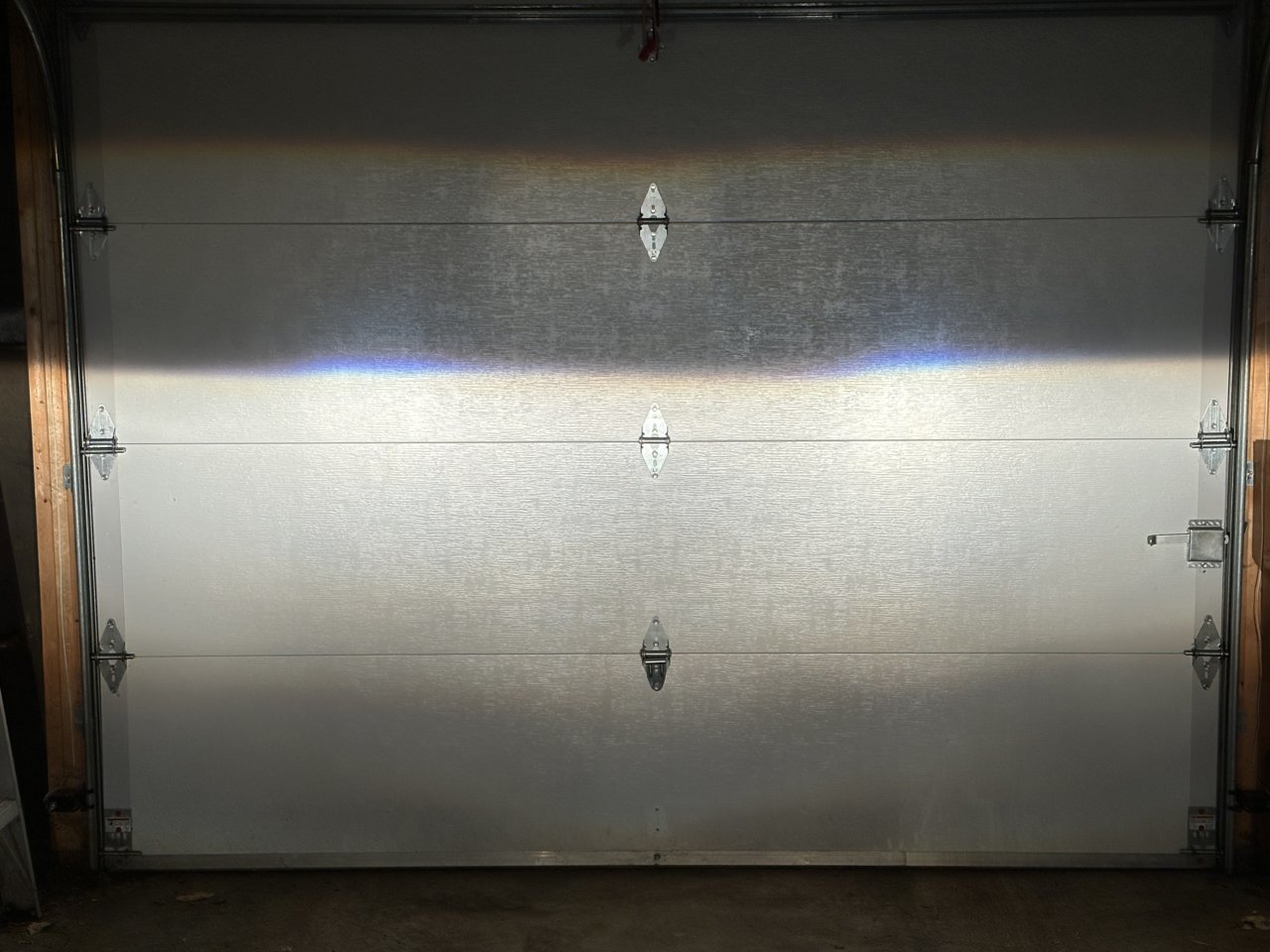

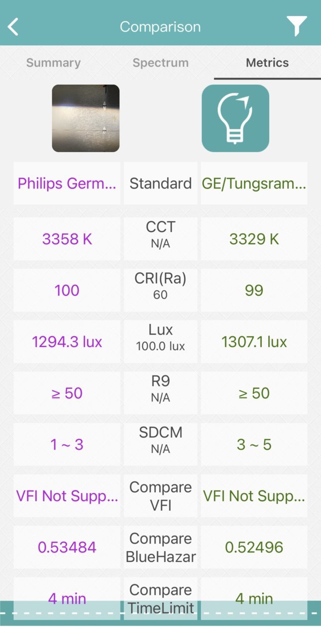

    As documented in this thread, GE/Tungsram H11 bulbs have continually proven to be the best performers in a projector. Of the top 3 performing H11 bulbs, GE/Tungsram owns them all, with the Platinums, Xenon +120 and Megalight +130. The precision of GE/Tungsrams filaments appears unmatched by the competition. This has always led to to be curious, if their H11s are so good, what about GE/Tungsram's H9s?
    GE/Tungsram H9
    GE sold its stake in automotive lighting to its partner Tungsram, who already co-produced bulbs in their shared Hungary factories. The GE branded products are the same as the Tungsram ones. Interestingly while Tungsram H11 bulbs are readily available in the US, the H9s are much less common. I picked up a domestically located GE branded H9 from ebay to test, otherwise it looked like ordering out of Europe for a Tungsram branded H9.
    Philips German H9 left vs GE Hungary H9
    The GE/Tungsram H9 just squeaks out the German Philips
    Impressive, but the intensity difference is also only about 1%, so it isn't going to be noticeable in the driver seat.
    While I have the Philips H9s documented at 74.75w the GEs draw 74.66w (5.41A x 13.8v).
    Having just slightly lower power draw and also slightly better output intensity would indicate slightly better filament precision in the GE bulb.
    However when you are down to a 1% output intensity difference it could realistically all be within the noise. I wouldn't place significant emphasis on getting GE/Tungsram H9s over Philips.
    GE/Tungsram has stated that their performance bulbs have an output loss of only 10% over their lifespan, which is an impressive feat. All halogens degrade over their lifespan. Philips H9s have an output loss of 25% over their lifespan as documented in post #2693. It is unclear on how much output loss the standard GE/Tungsram H9s may have by end of life, but interesting that GE/Tungsram payed attention to that performance metric.
    If someone wants to run a set of GEs/Tungsram H9s then send me the remaining bulb when the first one fails, that would be an interesting comparison point, as done with the Philips bulbs.
    Bulb America sells Tungsram H9s, they are a little more expensive than the Philips H9s. Although at this time they are out of stock. GE/Tungsram H9s are also available on Amazon for a premium and ebay.
    I was excited by these results, seeing something beat out the long standing best performing Philips H9 bulbs. But gains are so minor at 1% that it is all within the noise and I'd recommend getting whatever is convenient to purchase. Myself, being the crazed listing enthusiast I am, I'd probably pay the extra $2-3/bulb to go with the GEs even though I know I won't be able to tell the difference.
