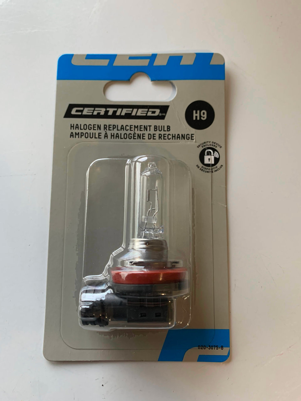

    I finally installed H9's in the low beams today. Even with my limited resources I was able to do this quite easily. I trimmed the metal tabs on both of the H9 bulbs and removed the green plastic inserts on the plugs.
    I brought along a socket to remove the windshield wiper reservoir. Didn't need it as it was easy to reach and swap to H9.
    Thanks @crashnburn80 and community for all the info!
    However, I went cheap. 2 choices available to me here in Canada. Possibly more but didn't look. The cheaper Canadian Tire H9's at $13.99
    or the Hamazon H9's at $21.12
    The Hamazon Philips H9's package says made in China but the back of the bulb says Germany.

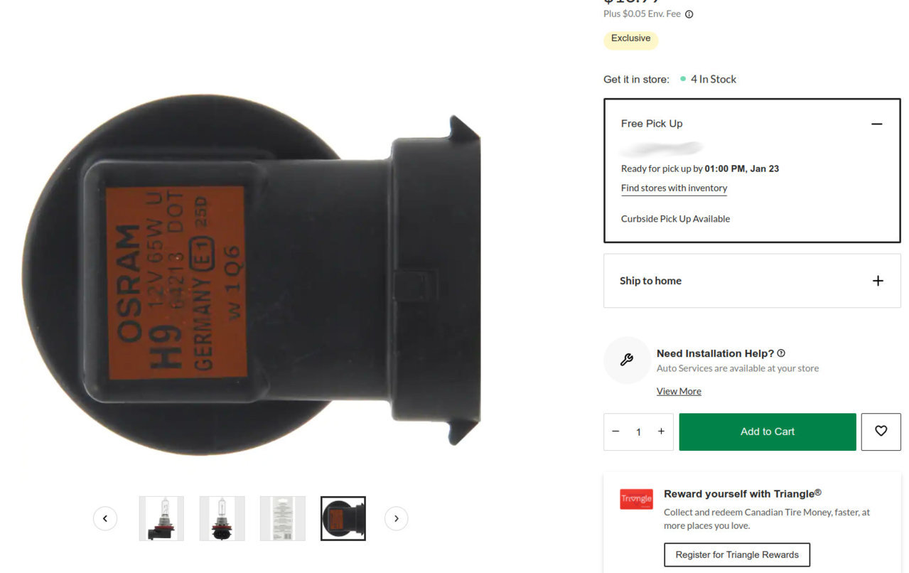

    The Canadian Tire web site has the H9's package listed as China on the back but Osram Germany on the bulb.

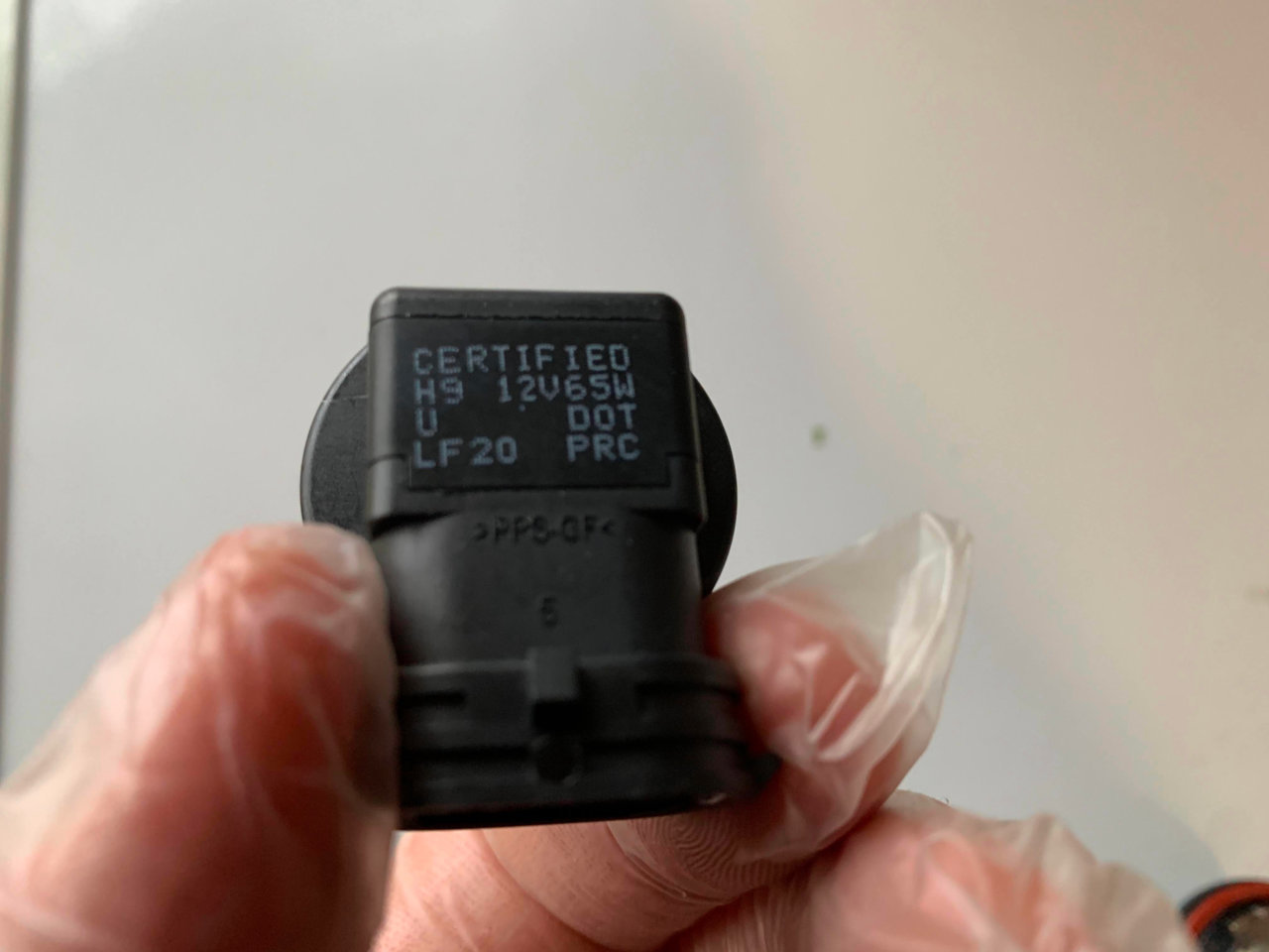

    Opening the Canadian Tire H9's package at home there is no country of origin on the back of the bulb. Does not say Germany. I suspect China.
    Without testing these, is it worth the approx $7 more to get the Hamazon Philips or will the cheaper Canadian Tire Osrams(?) H9's do? Or just the mere fact of replacing H11's with H9's worth it in itself as they are both 65W?

    Any decent clear H9 is going to be a substantial improvement over the stock H11s. You don't have to use the Philips bulbs, they are just what I have found to be the best widely available H9 bulb. Note that Philips does not specify or differentiate German/China bulbs. So the Amazon image could show German, and you could get China or visa-versa as they are not differentiated in the supply chain.
    That second bulb is stamped PRC. Aka Peoples Republic of China. The Philips bulbs out of China were quite good, but there is a pretty big quality range in manufacturing there.

    Okay good to know. I’ll just roll with the cheap Canadian Tire H9’s and see how they fair. If they die in 4 months I’ll give the Hamazon Phillips H9’s a go.
