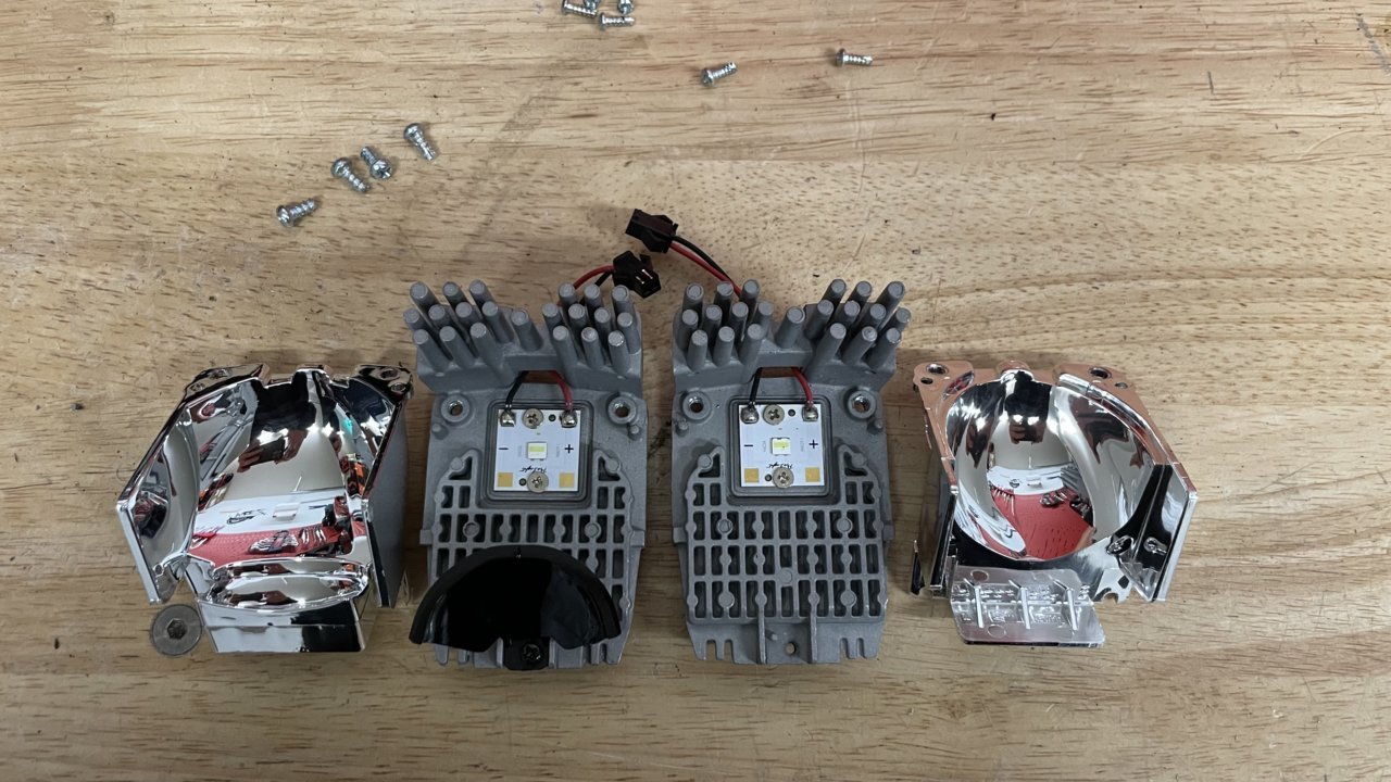

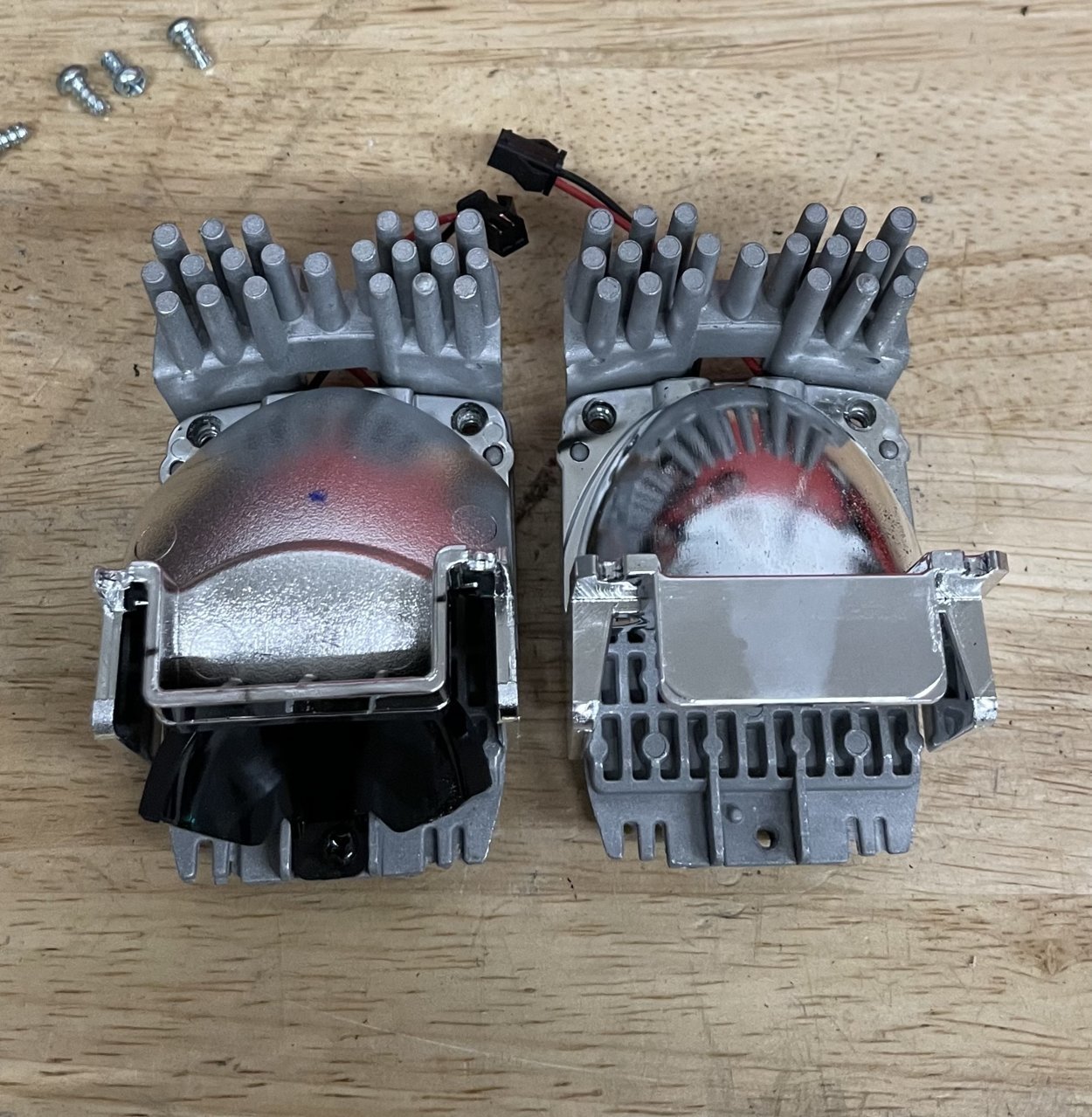

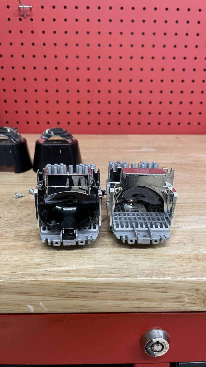

    Don’t know if anyone cares, but here’s what Morimoto XB headlights use as their projectors:
    21F2FA1B-F4F9-4981-8FD2-B5789E85D2C1.jpg 914B20B6-C3FD-4923-8FF5-E25F64054164.jpg B2BFD9C0-8A2C-48DB-B3E2-3CEBE032A2B8.jpg
    Left is low beam, right is high beam. They only do one or the other, no bi-LED projectors.
    These are the lightest and cheapest feeling projectors I have ever held. Nowhere near the quality or complexity of the Koitos.

    What are those from specifically? The Gen 2 XB Tacoma headlights are bi-LED.

    3" OME lift, heavy coils f/r 3/16" steel skids Modified Coastal Offroad diy bumper 5spd swap ('98 donor)
    Interesting. I would have assumed they would use a single reflectpr bowl design to minimize cost, and simply installed an appropriately designed cutoff shield to make the lowbeam. Would you mind taking some clear pictures, preferably from the same light and camera perspective (and Lock Your Camera Settings Please) with them pointed at a wall or garage door?

    4Runner. You are correct that the Gen 2 has bi-LED. My wife has Gen 2 on her 4Runner. I picked up this Gen 1 today with the intention of pulling it apart to plan out a retrofit because she will not let me install the higher performing OEM LEDs that are sitting on the shelf in the garage. Once that’s done though, I will have some of Morimotos Gen 2 XB bi-LED projectors

    I’ll try to do that this weekend. Used up all my garage time for the day today

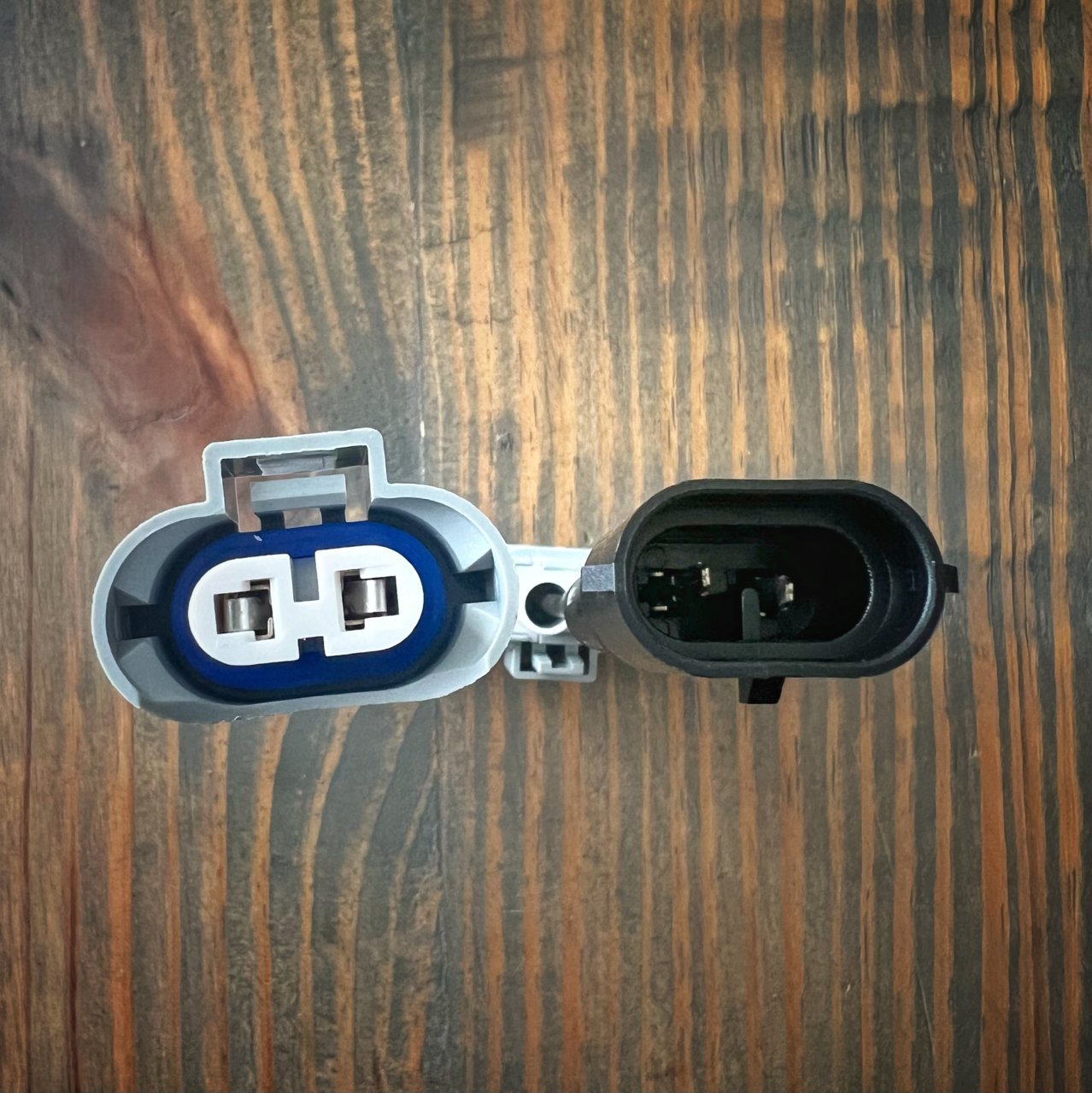

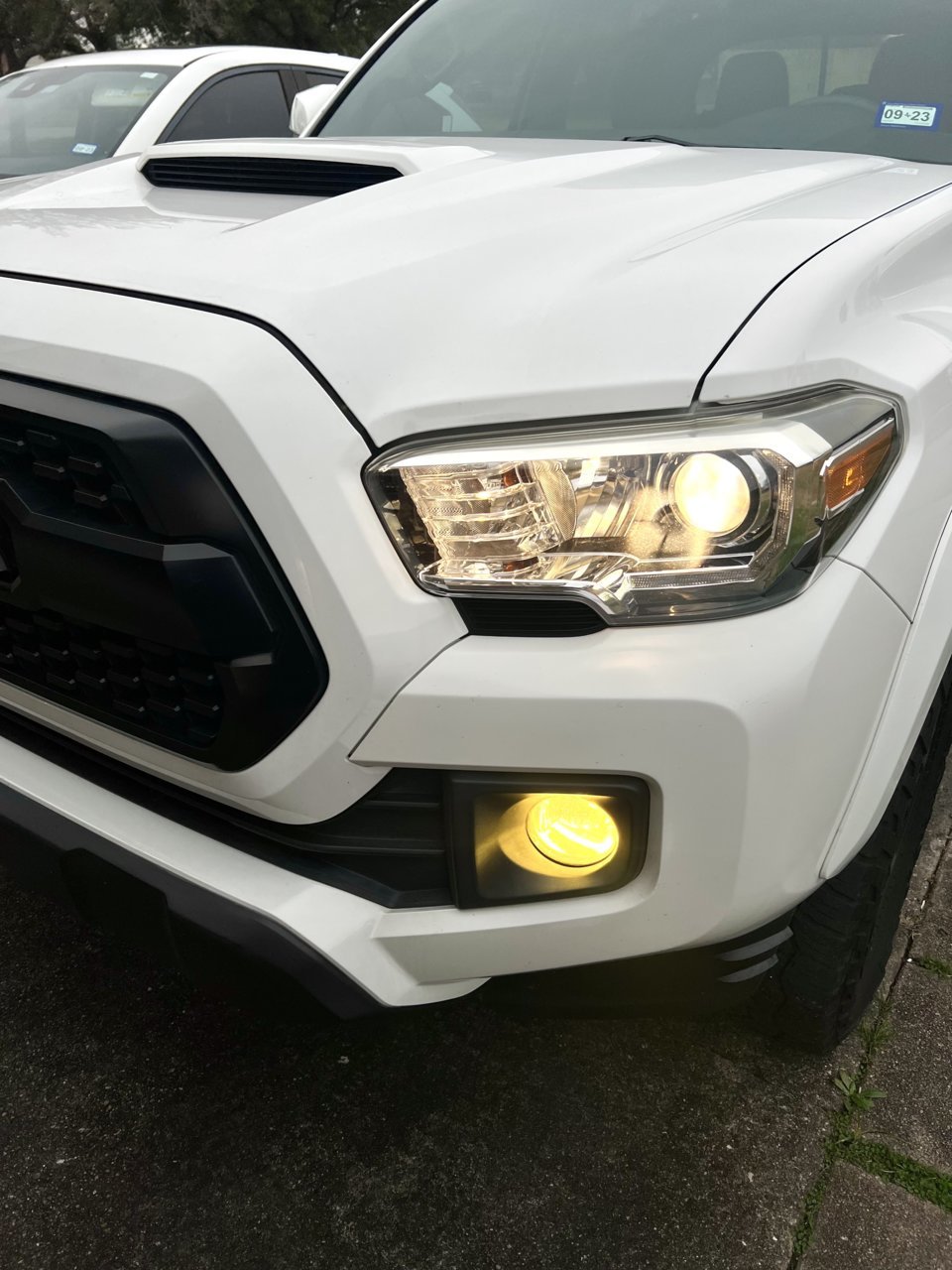

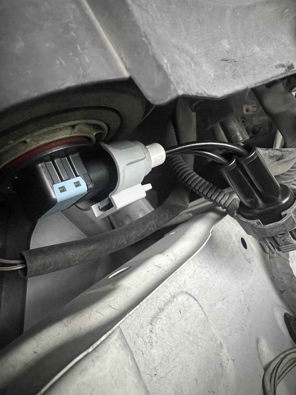

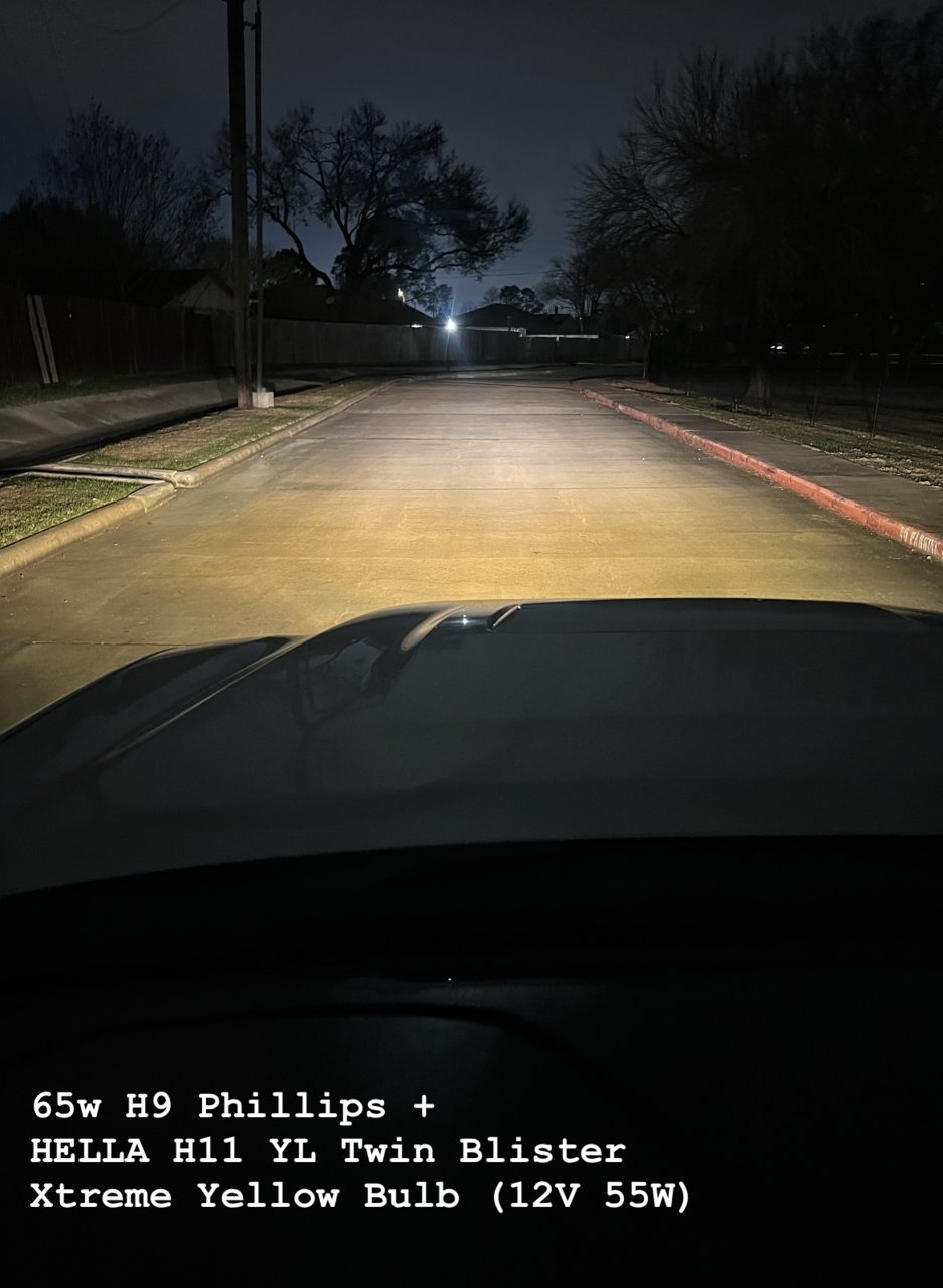

    Tried to get the best photos I could with out using iphones night mode.
    Harnesses were donated from a buddy whom upgraded to LED headlamps.
    Drove around the block and so far it is a very noticeable improvement. Highly recommended to those (like me) need better lighting til I can upgrade to OEM LED headlamps.
    (no trimming involved w bulbs)

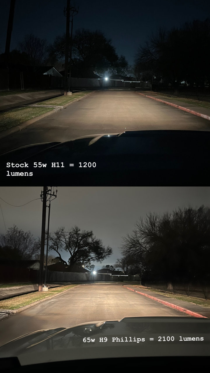

    As of sometime this week, my second Hella H9 finally went out. The first went in the summer. These were purchased Oct. 22, 2021, installed when received. Is this the typical life space of these bulbs? I ordered more, hard to fuss as $26 for the pair. (Also, hope I am legal with RDLs, and fogs alone.)

    Since H9s are a high-beam bulb, life expectancy will be less than the typical long-life H11 that comes from factory. And longevity will depend on how frequently you use your headlights. Still, the H9s are worthwhile given their low cost versus the Morimoto 2stroke.
