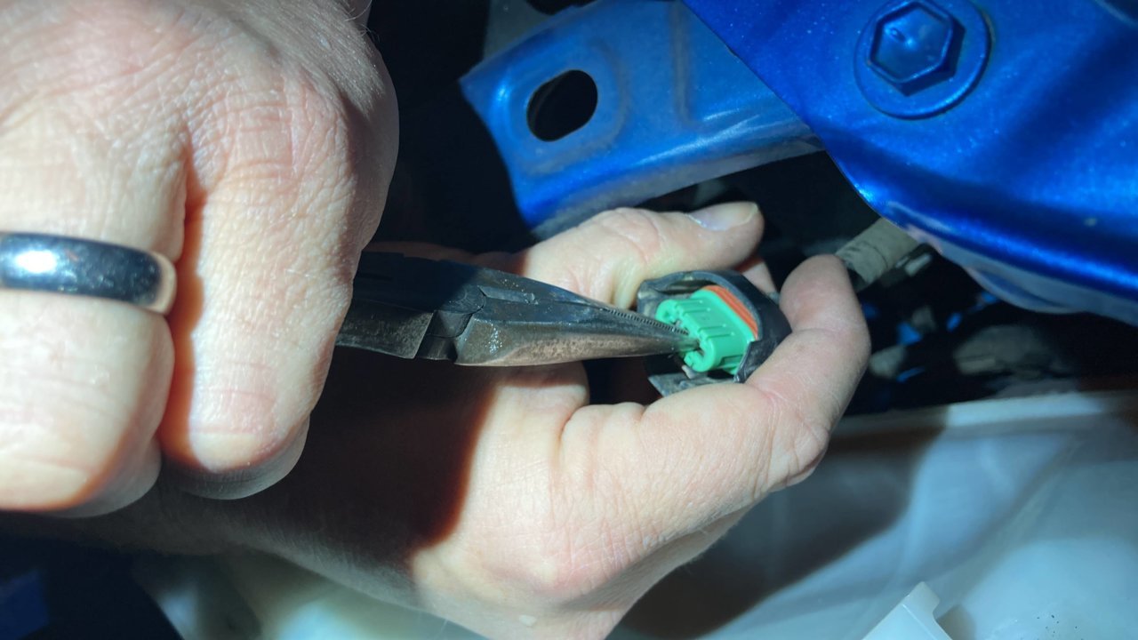

    Yes, I watched Crashes video before the installation. However, I was curious as to what it would take to trim the tab on the H9 bulbs so I opted for that method with a pair of small side cutters. Very easy. I just thought that the windshield washer reservoir may make it a little difficult to do crashes method. I might try crashes method next time.

    It wasn't too bad, Once I found the large tab on bulb/headlight I found a spot where my hand fit between the reservoir. No cutting but I may buy some small cutters and keep it as back up incase there was a slight emergency w replacing a bulb.

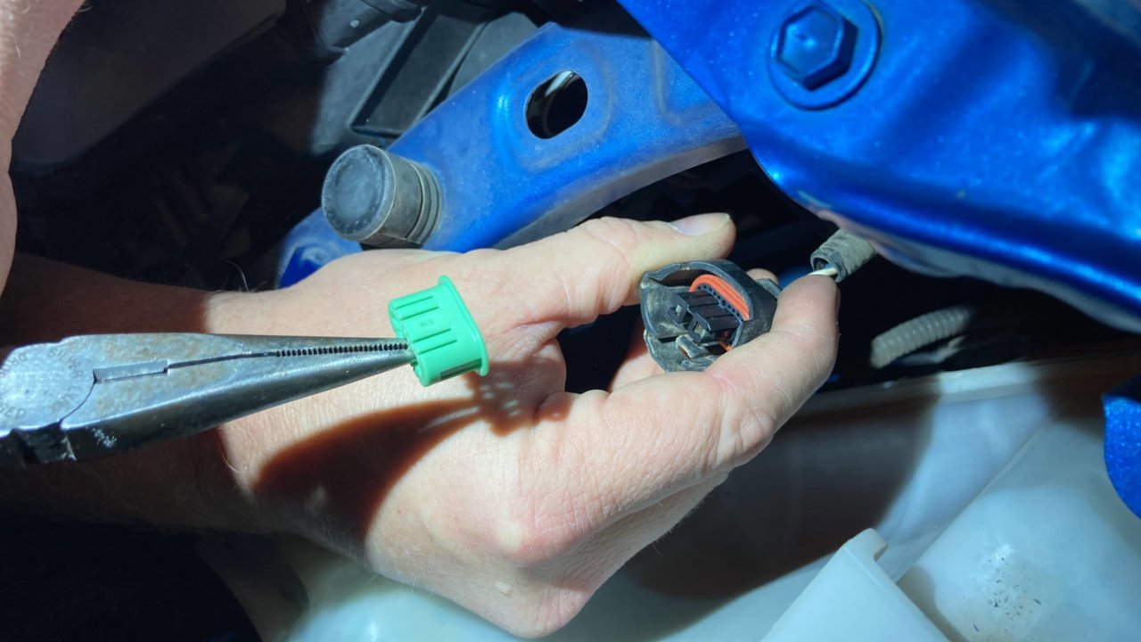

    If anyone is wondering like I was… this green piece just comes right out without any force and can easily be reused if you want to go back to h11 bulbs for any reason.

    Yes, this is what I did. I too found the green piece of plastic came right out with a very gentle pry of a screwdriver. Original H11's and the green insert packaged and put away if I ever wanted to go back to stock.

    I pulled the green adapter out which comes right out and can easily be reused and if you insert the H9 bulb tilted in at first so the larger metal tab fits in the socket first you do not need to modify the bulb at all.
