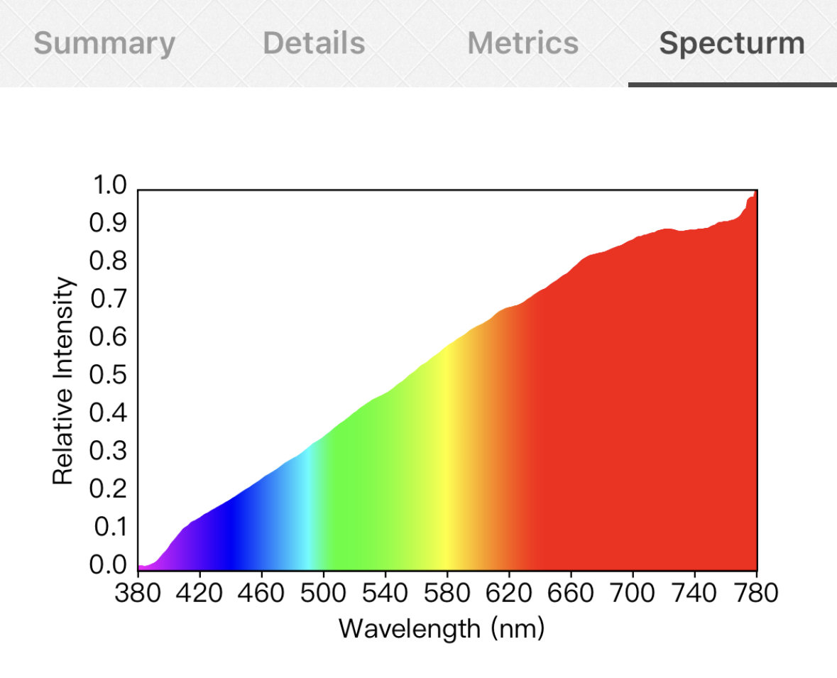

    Sylvania Silverstars are not typically a performance upgrade, they are a cosmetic one. Sylvania Silverstars focus on "whiter light", but the way you make whiter light with a halogen is to add a blue filter to remove warm color/yellow light. The bulk of halogen output is warm color/yellow light. Making halogen light whiter reduces output, and the whiter the light color by blue filtration the greater the output loss. Sylvanias tend to be in the 4000k+ color temps, as they are marketing whiter light, and at 4000k you really start to take noticeable losses in output.
    This is a halogen spectrum plot taken from a standard H9 bulb. Everything above 700nm is IR heat, not visible light, total amount of light output is essentially the colored area of the plot less anything past 700nm. Blue filters are reducing the red-yellow spectrums on the output so that the bluer colored light is more dominate and thus makes the light whiter. But you can see the bulk of the output is those warmer colors, so to significantly reduce those to make the light much whiter causes large losses in output. So whiter light typically means less bright, and brighter light means less white. Pretty difficult to have both. You can optimize the filaments for higher efficiency, by H9s already typically have all the optimizations. And you are now fighting to regain output you have lost, much less any true performance gain over stock. Coated bulbs run hotter and any further filament optimization will lead to even shorter bulb life. The Standard Sylvania H9 is rated at 240 hours, the Silverstar is likely half or less. I'd speculate 100-120 hours or good for about 6 months based on my usage. Sylvania Silverstars have had multiple class action lawsuits about misleading performance claims and short bulb life. That said, I've not personally tested those specific bulbs.

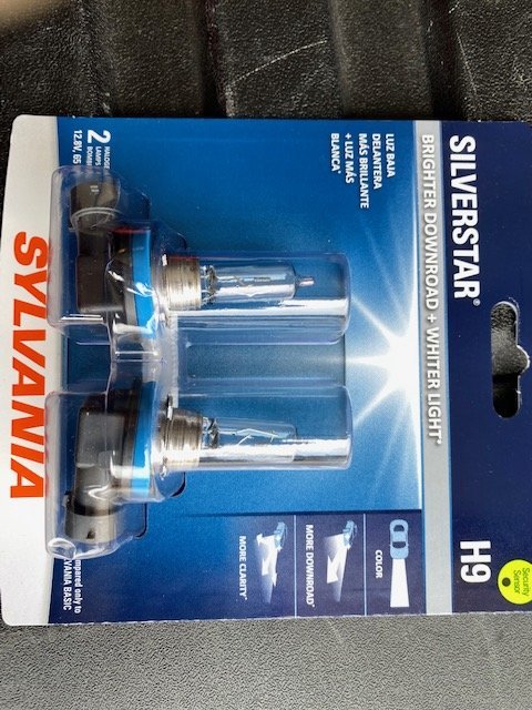

    Silverstar glass is all clear, Sliverstar Ultra has the blue tint.

    Are those H9s clear? They looked slightly blue in the photos. If they are truly clear maybe I'll try some.

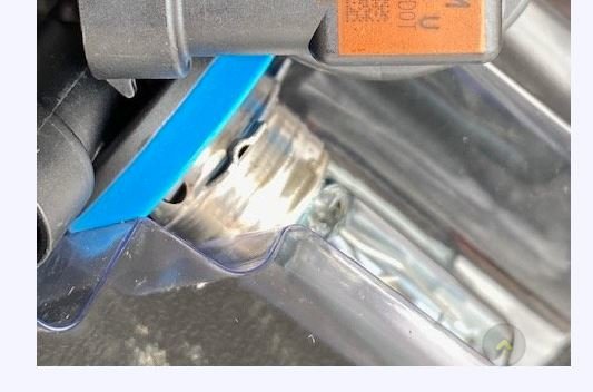

    Fwiw once removed you never need the green thing again and can go back and forth as you choose. It just prevents an H9 from working, once removed the plug works for h11 or h9

    The Silverstar website shows them as tinted
    However, @InThePlains bought them and presumably has them in hand; but the picture in their post looks like they are tinted
