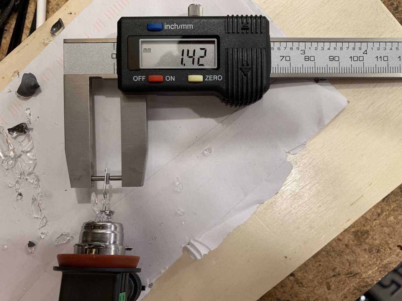

    Keep in mind, this is the target size for proper focus:
    Focus is the #1 most critical design component for a replacement LED in a halogen assembly. Even the very best opposing emitters on a blade style LEDs have not yet achieved this focus. Morimoto 2 stroke 3.0 is the closest. Any LEDs today using more than 2 sides will be massively larger than the target size, providing no focus at all and be a complete failure. Definitely not recommended.
