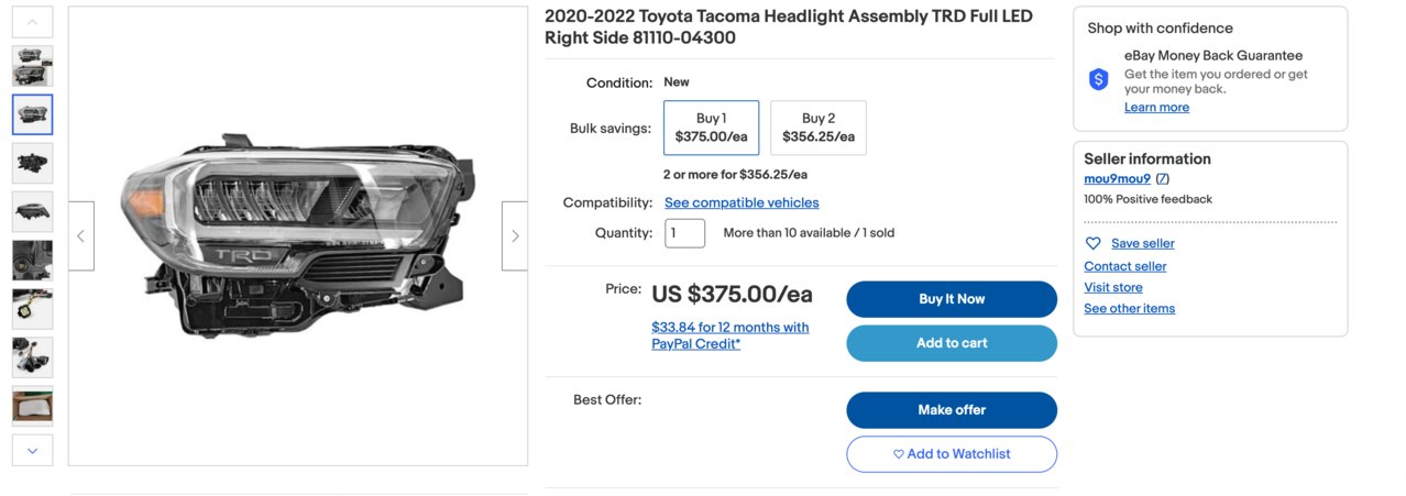

    Looks like to TODO knock offs are coming through now with the added "TRD" and "PRO" theres no way there even close to the same quality with that price-point though. At least they tried to do the same number of reflectors unlike some of the other knockoff replicas.

    Yeah, there is a lot more to headlight optics than looks. Many of these knock-off reflector LED headlights have irregular patters, dark spots, low output and in the end you throw away $750 on Chinese knock-offs that could have been put toward the real thing. Reflector LED optics are much more challenging than projector optics that can just use an off the shelf projector. Unfortunately those do not spell out aftermarket anywhere in the listing title and use the OEM part number, so I'm sure they will sell a ton, likely many will mistake them for a good deal on OEM when ordering.

    Agreed, I think there would be a bigger secondary market if there was a tab repair kit for the OEM leds because there are a lot for sale off of totaled tacomas.

    @6MTPro any chance of repairing them with a plastic welder?

    A smart design could employ replaceable breakaway tabs. Similar to how bicycle derailleur hangers are bolt on for many bikes due to how frequently they get bent.

    I mean if you put enough expoxy or anything it will stick, its more the rigidity, other ones in the past had tab repair kits that you could purchase.
