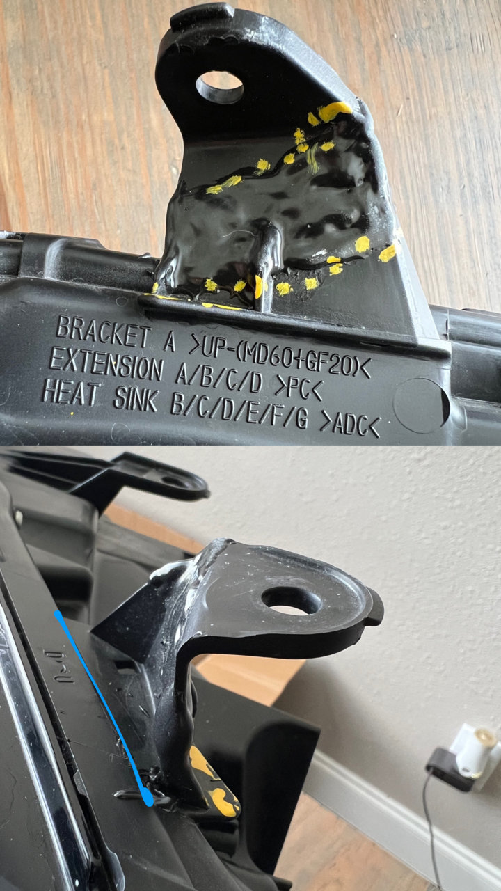

    I’ll snap a photo tomorrow when I get off shift for ya. Its the top short tab that almost looks 90 degrees.

    @Firn
    This tab, maybe with a bit of extra plastic incase any of us need to extend or shave a bit off…

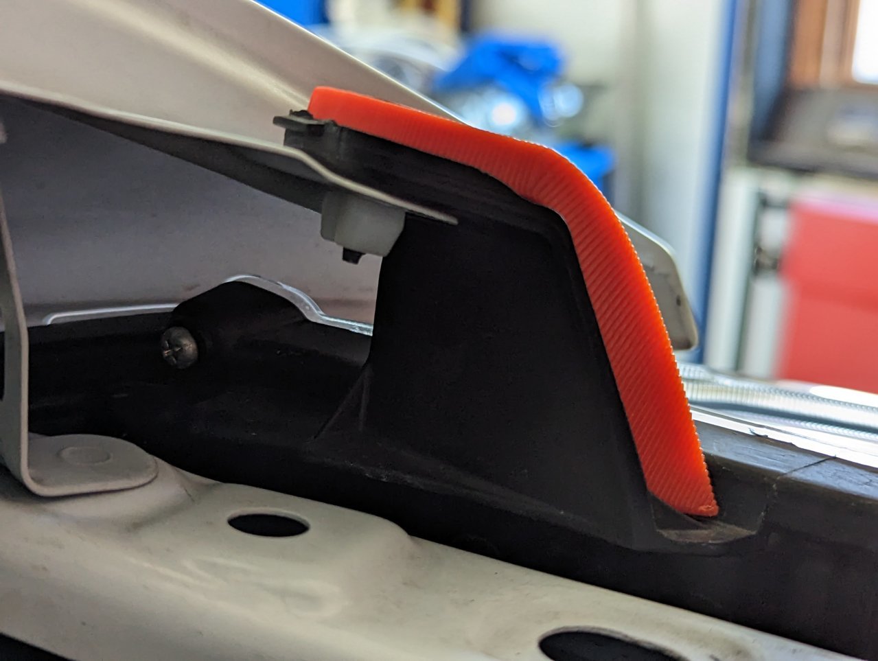

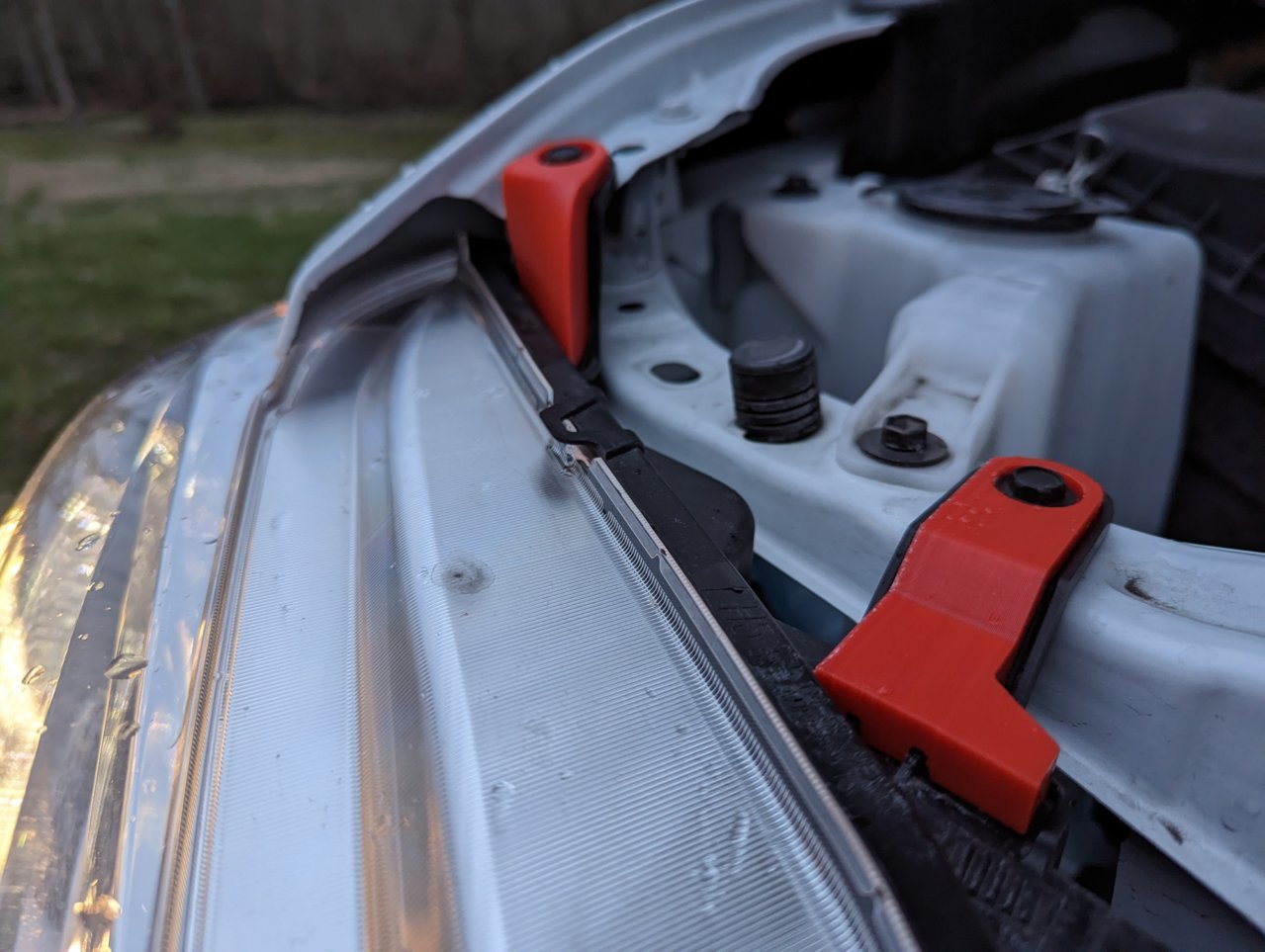

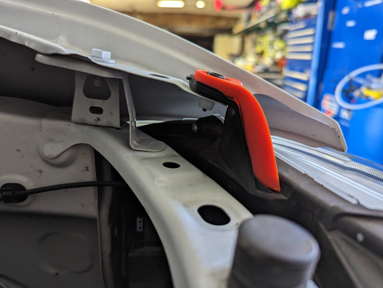

    Got you covered!
    You should be able to glue all the original pieces to the reinforcement tab and fully support that. If the pieces are missing it should work as well, provided there is enough at the base to bond to. The only concern I have right now is the missing thickness of the OEM tab, if the parts are missing, a simple washer would make up the space but I am considering printing some spacers as well
    What I am putting together would be four pieces, both upper tabs for both headlights. I am looking at doing the side tab and including that since I have seen a few of those broken as well.
    This is only for OEM HALOGEN lights however and possibly Morimotos, the OEM LEDs are different and these won't fit.

    Gotcha, the ones I sent are OEM LED’s
    I might just have to find a cheap broken one and dremel that piece out. Use my Amazon plastic “welder” kit and Macgyver something.
