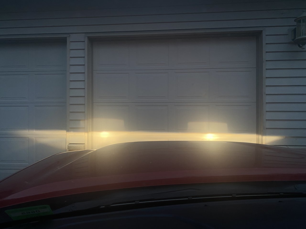

    Have you guys experienced this? I swapped out my LEDs for H9s and I don’t remember this cutoff pattern with the two notches.

    Looks normal. Are you talking about the "boxes?" That's uplight provided by the squirrel finders in the projector.

    The illuminated notches/boxes above your cut off line is your uplight, this is a critically designed OEM feature so you can see beyond your low beam cut off. The fact that you did not have this uplight with your LEDs indicates the LEDs were a major safety compromise reducing your ability to see beyond your low beam cut off (which has been extensively documented in this thread) resulting in a very hazardous headlight downgrade that reduces the safety of your vehicle, which was likely improperly advertised as an upgrade by the LED manufacture. Those uplight boxes are essential for safe headlight operation.

    Yes, noticed those too. We switched from H11 to H9 and the upper rectangles are more visible on the garage door.
    As CB80 notes, that is a feature, not a bug. Good call going to the H9s.
