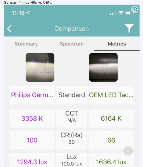

    That is not how it works. You fail to understand human perceived intensity vs instrumented measured intensity. Lux/Candela is purely instrumented intensity. High color temp, short wavelength, blue light scatters internally in the human eye which causes internal glare within the eye and blindness to the high color temperature, leading to substantially disproportionate ill effects from blue light vs yellow, causing short wavelength (blue) light to be far more harmful. This is well established medical fact. Lux/candela is just measured intensity and does not account for the interactions within the human vision system.

  11. May 29, 2023 at 11:11 PM
    #6371
    smikec
    smikec Well-Known Member
    Nov 11, 2018
    #272376
    393
    it's been done, but not a driving photo

    And you did it again, you said brightness in your last comment and intensity in this one. This is my point, the instrument you use is a Luxmeter, that already accounts for how the human eye responds to different wavelengths to normalize "brightness"/Intensity.
    The human perceived intensity is the SAME as the instrumented intensity when talking lux. Lux accounts for how the eye responds to different wavelengths. Lux accounts for perceived brightness.
    I already mentioned that blue light can be more aggravating, but that is different from intensity/brightness.
    You seem to be using the difference in RADIOMETRIC values and applying it again to Lux, but lux already accounts for that.
    To quote wiki since it has the most concise definition.
    The lux (symbol: lx) is the unit of illuminance, or luminous flux per unit area, in the International System of Units (SI).[1][2] It is equal to one lumen per square metre. In photometry, this is used as a measure of the intensity, as perceived by the human eye, of light that hits or passes through a surface. It is analogous to the radiometric unit watt per square metre, but with the power at each wavelength weighted according to the luminosity function, a model of human visual brightness perception, standardized by the CIE and ISO.[3]
    and
    A luminous efficiency function or luminosity function represents the average spectral sensitivity of human visual perception of light. It is based on subjective judgements of which of a pair of different-colored lights is brighter, to describe relative sensitivity to light of different wavelengths. It is not an absolute reference to any particular individual, but is a standard observer representation of visual sensitivity of theoretical human eye.
    and Lumen as well
    The lumen (symbol: lm) is the unit of luminous flux, a measure of the total quantity of visible light emitted by a source per unit of time, in the International System of Units (SI). Luminous flux differs from power (radiant flux) in that radiant flux includes all electromagnetic waves emitted, while luminous flux is weighted according to a model (a "luminosity function") of the human eye's sensitivity to various wavelengths, this weighting is standardized by the CIE and ISO.[2] One lux is one lumen per square metre.

    Given 2 light sources of equal intensity, one at 3200k and one at 6000k. If an observer stands behind the light sources with them pointed at a wall, the observer seeing the output on the wall would rate their output nearly the same. The lux readings for peak intensity are identical.
    If the observer stands in front of the light source with the light source shining directly into their eyes, the observer will rate the 6000k light source as brighter/higher intensity/more aggravating. The lux readings and intensity between the light sources is the same. The 6000k light source pointed into the observers eyes scatters light within the eye and causes glare making it difficult to see, hence the observers perception that the light source pointed into their eyes is brighter/higher intensity than it actually is.

    Oh I assure you I understand the technical terminology. Quoting Wikipedia here isn't doing you any favors.
    Look at the scientific NHSTA reports on low color temp/short wavelength headlight glare to oncoming drivers:
    "Spectral power distribution also affected discomfort (even though it did not affect visual performance) with the high intensity discharge headlamps eliciting ratings of greater discomfort than the halogen and blue filtered halogen headlamps, when the glare illuminance was held constant."
    https://www.nhtsa.gov/sites/nhtsa.gov/files/final-report_rpi_glare_spectrum.pdf
    While this is older and for HID, the conclusion that spectral power distribution (aka increases in short wavelength light distribution) cause greater "discomfort" to oncoming drivers vs their long wavelength counterparts typical of halogens. This would be significantly increased for LED compared to HID due to LEDs spectral power distribution in short wavelength high amplitude frequency of LED, leading to significantly worse effects. Note that the study held illuminance constant between light sources, yet the higher color temp HID was rated as worse/greater discomfort.
    AKA even though the light source is equal intensity, subjects rate it as causing greater discomfort. If you have experience in this field, you'd know that these subjects would describe the greater discomfort/blinding qualities of the high color temp light source as "brighter" or "higher intensity". Even though those are not technically accurate descriptions that represent the light source qualities but that is how many describe the blinding effects of the higher color temp light due to the aggravation/discomfort, hence why I called them "perceived".
    Regardless of how you want to split hairs, the leading Govt agency on headlight safety specifically states that headlight spectral composition can cause greater negative effects despite the luminescence being held constant. Which is exactly what I have been saying all along and you seem to keep rebutting.
    But to come full circle you asked how to not blind those that fall below your cut offs on hilly roads. Your question was answered and you didn't seem to care for the answer. I can assure you this course isn't going to end any better.
