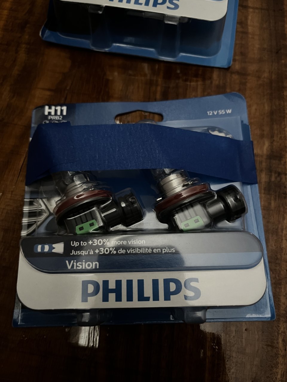

    I installed the 30% brighter Philips the other day. Unfortunately, I couldn’t swap out the fogs. The top plate( for lack of the correct term) was longer, and I couldn’t get it into the slot, so I could then turn it clockwise. But a dremel and a diamond wheel will take care of that.

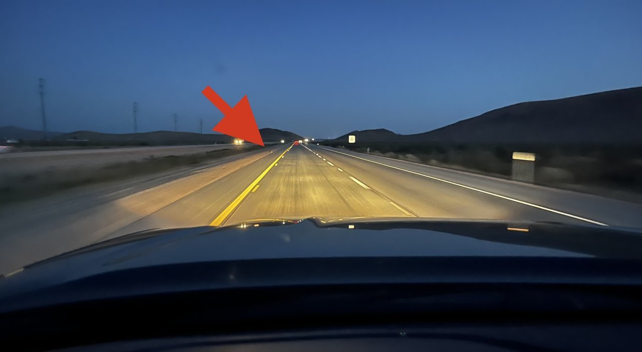

    So…We were coming back from the Mojave Desert on the 14 just as it was turning dark. I turned on the lights anxiously and began to observe attentively. I could see the pattern and output. I thought it looked a little better than stock. I waited till the car in front of me went over the crest and I put the high beams on. Oddly enough, it looked almost the same. So it was that desert ambiance at dusk doing its thing. It then got difficult to observe as it seemed almost every vehicle had blinding LEDS. It made it hard to see the full output. So I waited patiently (Fugazi style) and when we got into the city, it was still hard to truly tell what was the verdict. The picture was taken as we left the desert. One thing I could tell, it projected further down the road(arrow shows where it stops).
    It wasn’t until I got to the 27 to head back into the canyons and home that we were pleasantly surprised. I COULD SEE THE ROAD AHEAD OF ME WELL!!!!! No, not very bright, but damn, I could finally see the edges more and well established. The P’s beam the lights further down the road. Stockers sucked for that as we all know.
    Going up the hill, it’s going to obviously hit the oncoming eyes 30% brighter, but for this cool cat, 150 LED wrongs don’t make a right. (Don’t worry haters, no one that I know are running H9’s :p
    EDIT: Just saw the fogs are H16, much lower wattage

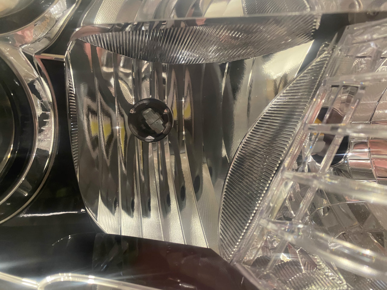

    Not sure if this has been posted before.... I bought a couple of Phillips H9s to replace my low beams and found that there were Phillips H9s installed from the factory. They were even bulbs manufactured in Germany. My truck was built on Jan. 9, 2017 and there were no headlight upgrades.

    That might the high beam position you felt. Low beams should be closer to the fender.

    As mentioned above those are the high beam bulbs. Common mistake. Factory low beams are H11.

    Yup, you are correct. I was looking at the high beams. I was able to trim the tab and install the H-9s in the low beam sockets OK. Thanks, Tim

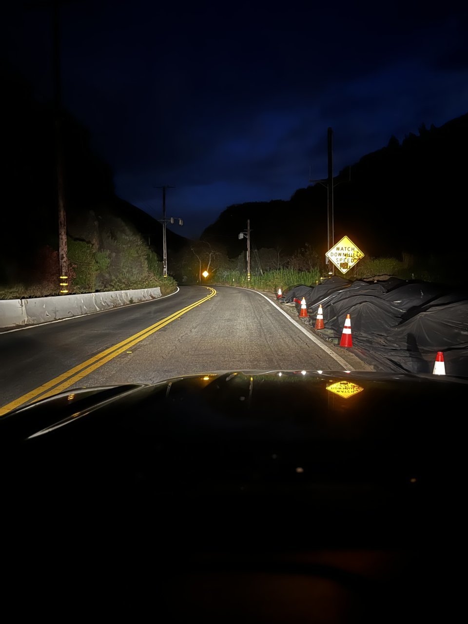

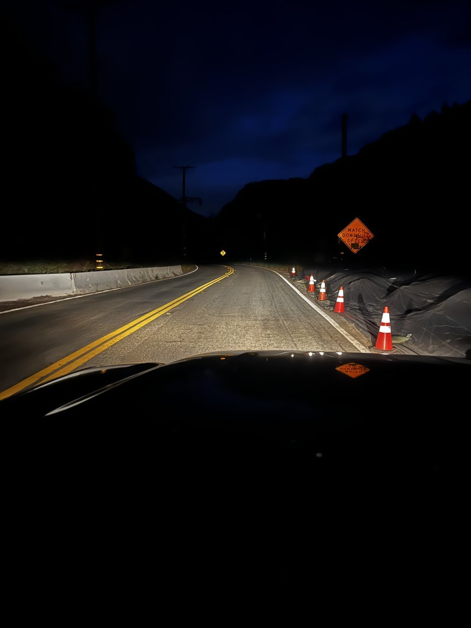

    Thank you @crashnburn80 for your hard work. You also pushed me off the nest and have taken that step to better lighting. Not quite the H9’s, but a whole lot better. H11 30%+ Philips.
    Unfortunately I moved a bit, so I didn’t get the exact same picture, but interestingly, the high beams changed the sign color to yellow.
    On a side note, digging the reverse lights mod more and more.
    Both of these mods give better situational awareness overall.

    The H11 Philips +30 will be an improvement over stock, but you can get substantially better improvements from higher efficiency and more performant H11 options. At minimum I’d suggest the Philips H11 +100s over the +30s, more preferably the Tungsram Platinum H11s.
