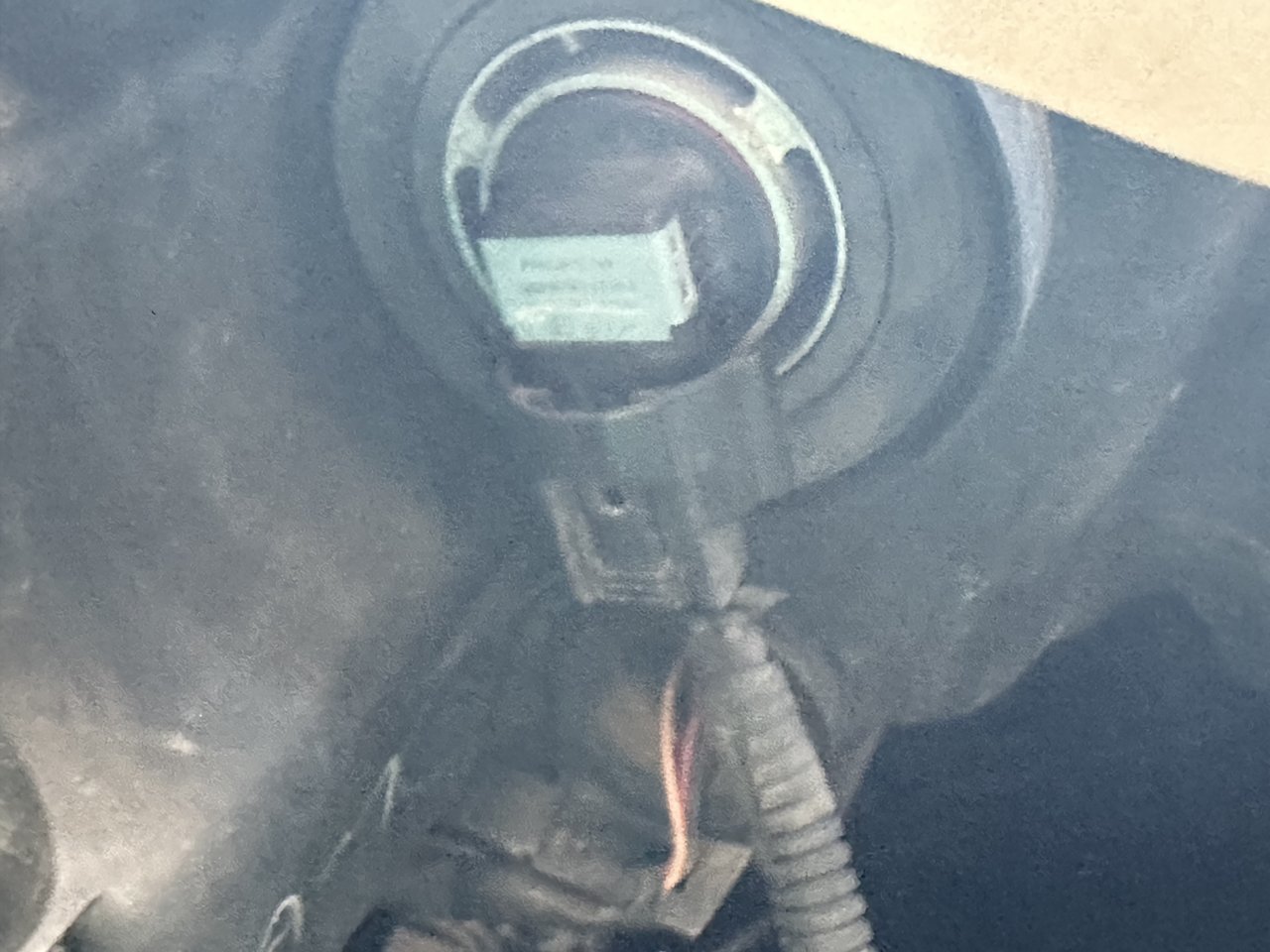

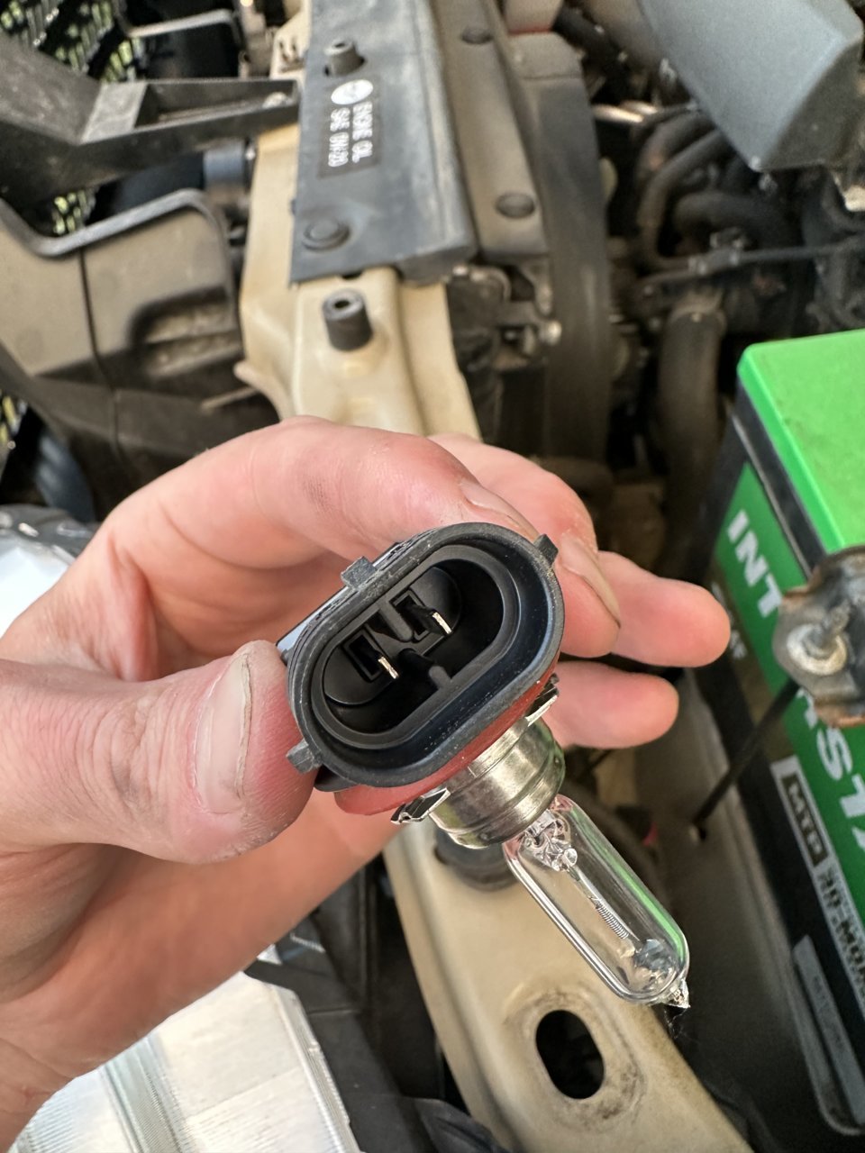

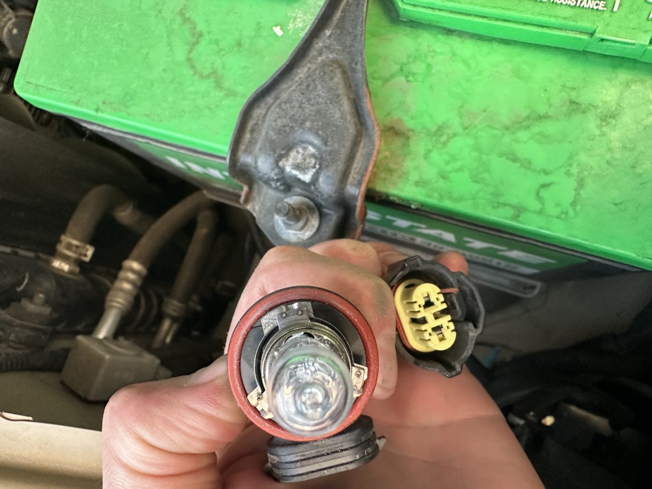

    IMG_3046.jpg Apparently my truck came with H9 bulbs already. I bought some new ones and went to swap them out and an H9 was already in there who woulda thought? Anybody else experienced this? I guess I’ve got backups now.
    What it came with on left, purchased bulb on right.

    High beams should of come stock with h9, you sure you pulled out the right bulbs? Otherwise the last owner upgraded for you!

    I’m the original owner, so that rules that one out. 99% sure I pulled the right bulb as it appears to be the only one it’d be able plug in to. Attached you’ll see the tabs aren’t cut to modify the bulb to fit either. I’m confused, although I guess it’s cool! Other than the fact my headlights won’t be getting the marginal upgrade I was hoping for as it’s already there.

    That looks like the high beam... there should be another bulb further to the side by the fender, on the passenger side its covered by the washer bottle and the driver side its a little tucked back.

    That yellow insert in the connector is green for your low beams. You grabbed the high beam bulb.

    Ahhh yup, you guys are correct. Thanks again to Tacomaworld for pointing out my unintelligent over sites. Appreciate it fellas!

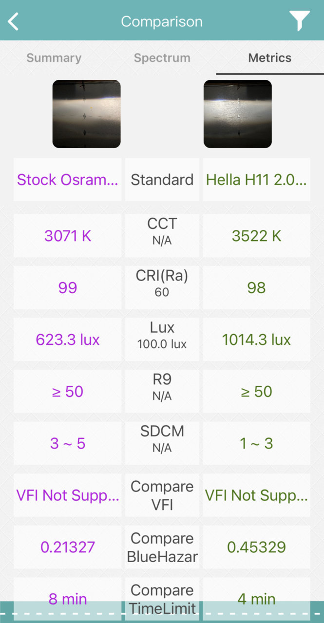

    Hella Performance 2.0 H11s
    The 2.0 Performance H11s claim +100% light output. The bulbs are made in Korea, which seems to have better bulbs from Hella than Hella's China factories.
    Like the Hella Performance 2.0 H9s, the performance 2.0 H11s also have a light blue coating. The coating is spec'd at 3700k. Darker coatings to achieve higher color temps incur larger output losses. 3700k is on the very light end of the coating spectrum, meaning less output loss. But the coating does still incur a loss over a non-coated bulb.
    Hella Performance 2.0 H11 (left) vs stock Osram H11 (right)
    Stock Osram H11 vs Hella H11 Performance 2.0
    By my numbers the Hella H11s have about a 63% output intensity improvement over stock, while having a whiter ~3500k color temp. The color temp is very similar to the Hella H9 Performance 2.0s.
    The Hella Performance 2.0 H11s pull ~63.8w.
    Hella H11 Performance 2.0 (left) vs Tungsram Platinum H11 (right)
    Hella H11 Performance 2.0 vs Tungsram Platinum H11
    Pics don't do it justice, but the H11 Tungsram platinums have +24% output intensity over the Hella Performance 2.0 bulbs, while simultaneously achieving very similar output color temperature. While Hella achieves whiter light through filtration which incurs output losses, Tungsram achieves it through exotic gas fill in the bulb, which costs more but does not incur the filtration losses, resulting in higher output.
    The Tungsram Platinum, Tungsram Xenon +120, Tungsram Megalight +130, Osram Laser +150 are all H11s that perform better than the Hella Performance 2.0s, as well as the H9 options like the Hella 2.0 Performance H9s and the best Philips H9 coming in far higher. These Hella H11s were interesting to evaluate, but as a fully coated bulb they don't compete well against true high performance H11s.
    Special thanks to @Umpqua79 for donating these bulbs for testing.

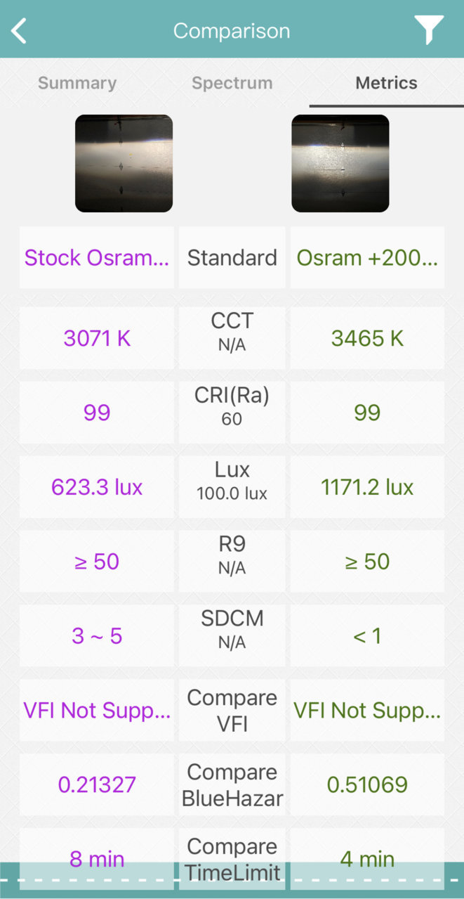

    Osram Night Breaker +200

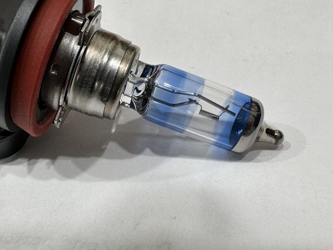

    The Osram Night Breaker +200 H11s are the first +200 efficiency bulb in the H11 base. The Night Breaker +200s performed very well in the 2nd Gen reflector housings, though they were outperformed by the Philips Racing Visions in those assemblies. Philips Racing Vision are not available in the H11s as of this review.
    The Night Breaker +200s have blue coatings both ahead and behind the filament. The dual stage light to dark coating on the rear of the bulb is interesting. In a projector much of the light intensity is going to come off the rear of the projector bowl, so reducing the filtering loss to the rear of the bulb and therefore bowl will result in better performance. It would appear Osram is looking to minimize the loss with the lighter filter closer to the filament.

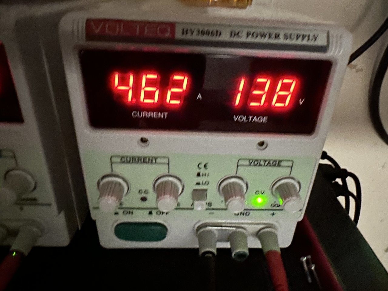

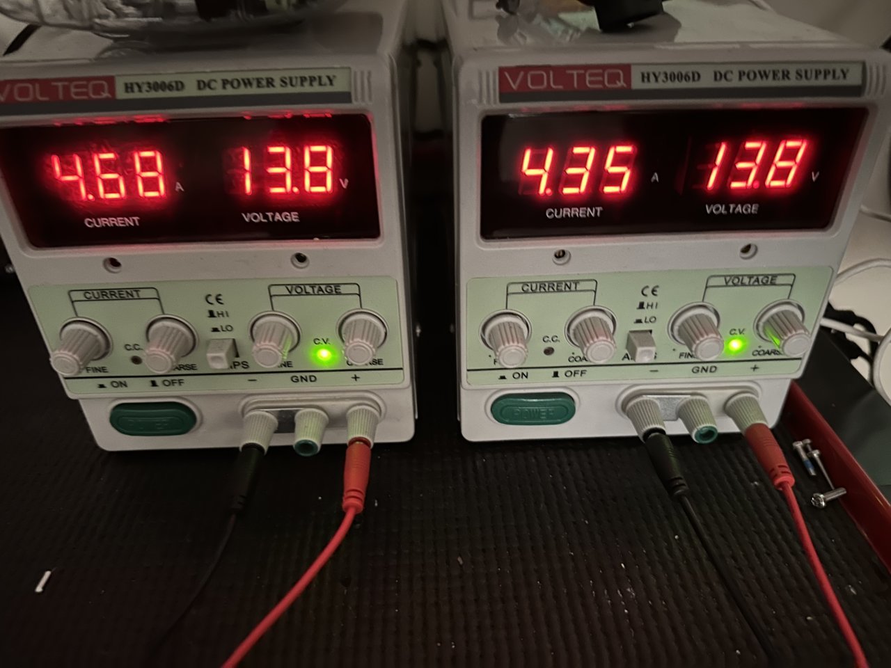

    Osram Night Breaker +200 power draw at 60.0w

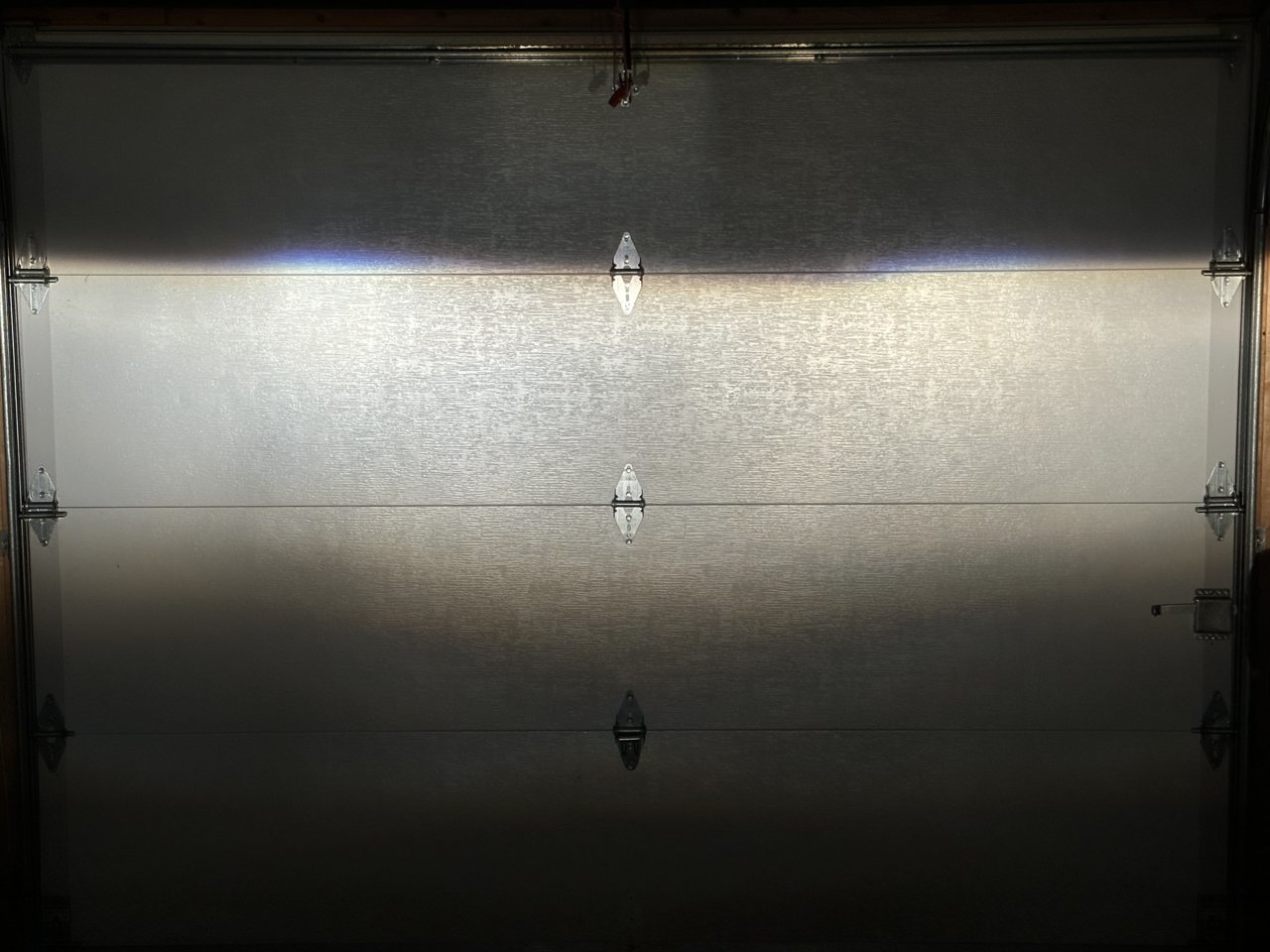

    Osram Night Breaker +200 (left) vs stock Osram standard (right)
    Stock Osram Standard vs Osram Night Breaker +200
    88% improvement over stock. Very solid gains.

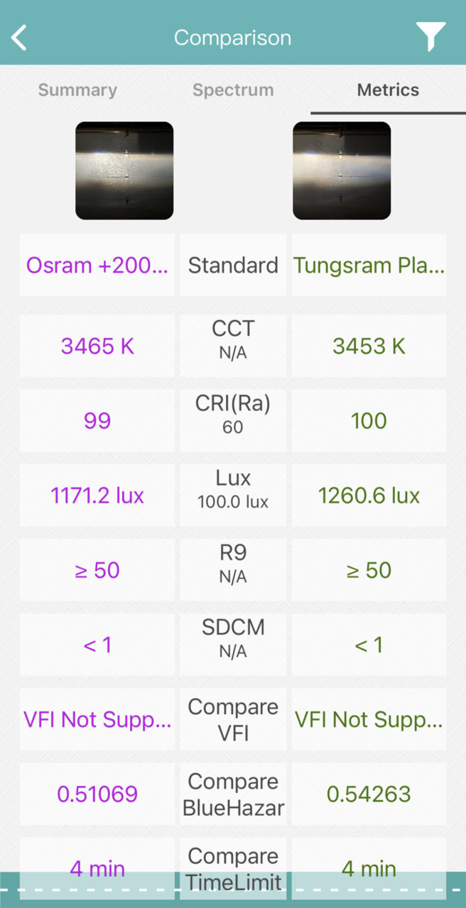

    How do the Osram +200s compare to the leading Tungsram Platinums?

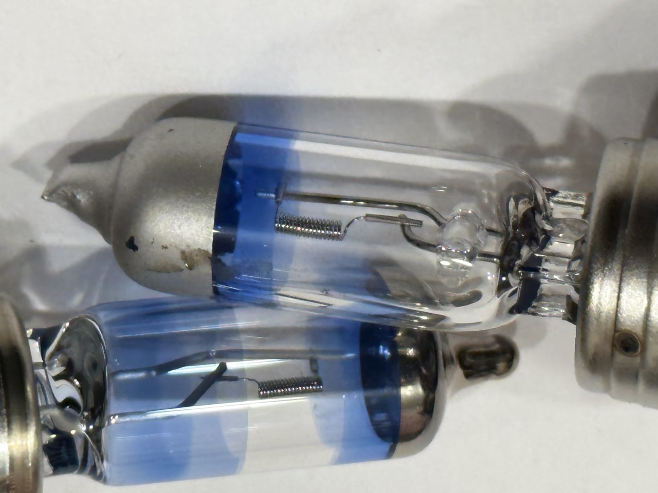

    Tungsram top vs Osram +200 bottom
    This is really hard to tell in the photo, but the Tungsrams appear to have a finer filament winding. The Osram filament is more compressed into almost a solid block, while the Tunsram has the slightest spacing between the winding coils. The Tungsram units have a deeper glare cap like all Tungsram bulbs, but also do not coat the rear of the bulb with light reducing blue coatings, allowing for greater output to strike the rear of the projector/reflector.

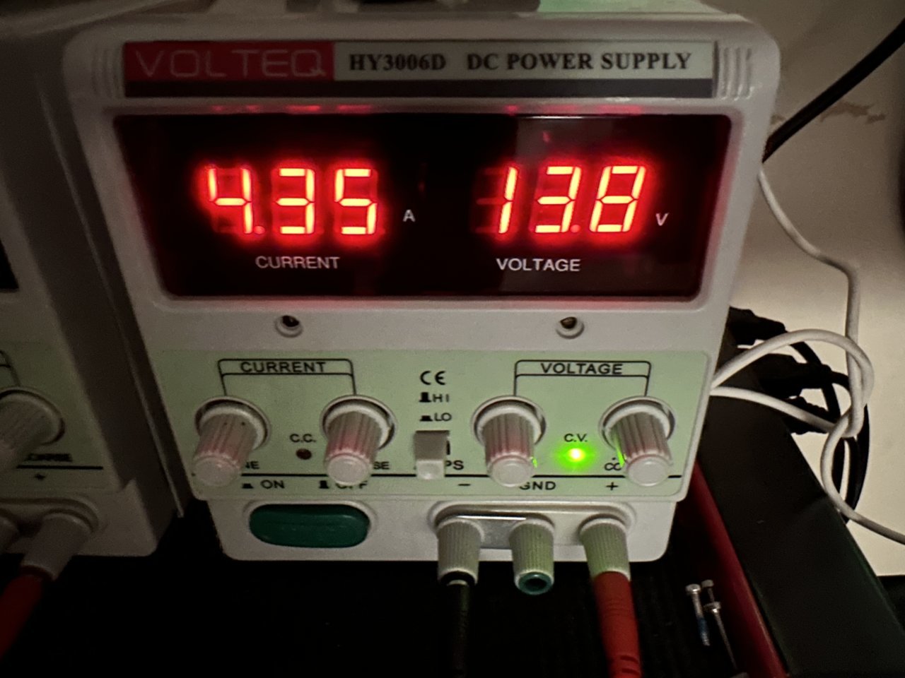

    Power: Tungsram Platinum at 64.6w (left) vs Osram +200 at 60.0w (right).

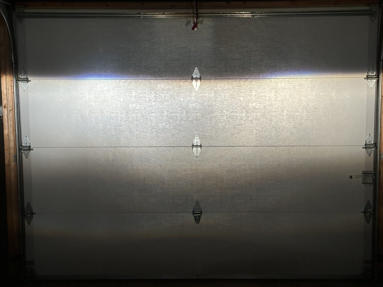

    Osram +200 (left) vs Tungsram Platinum (right)
    The Osrams are very solid performers, though the highest performing H11s for 3rd Gen Tungsram Platinums beat them out by approx 7.6% in peak intensity at a nearly identical color temp. However the Osram +200s beat out all other H11s tested to date with the exception of the Tungsram Platinums, in the absence of the Tungsram available for purchase, these are a great option for 3rd Gen for those that do not want to run an H9 in the low beam.
    The Philips H9 low beam swap is still the best performing option available for the 3rd Gen halogen projectors.

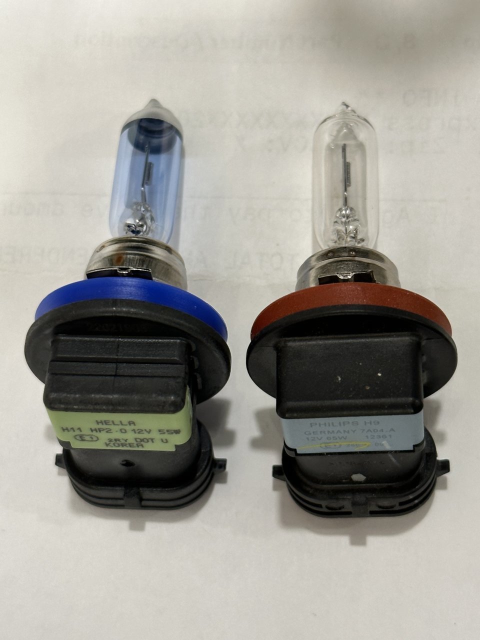

    Osram +200 (left) vs Philips German H9 swap (right)
    The Philips H9s put down 10.5% higher peak intensity while also costing a fraction of the price, though the color temp is more traditional halogen vs the slightly whiter performance H11s.

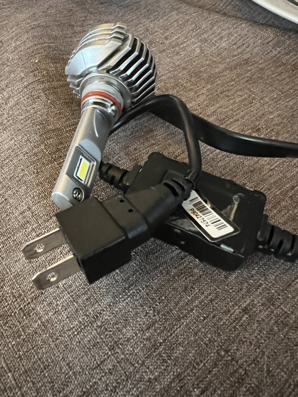

    Hey guys, can someone help me figure out what bulb this is? Been trying to find it on this thread, but I’m not a smart man.
