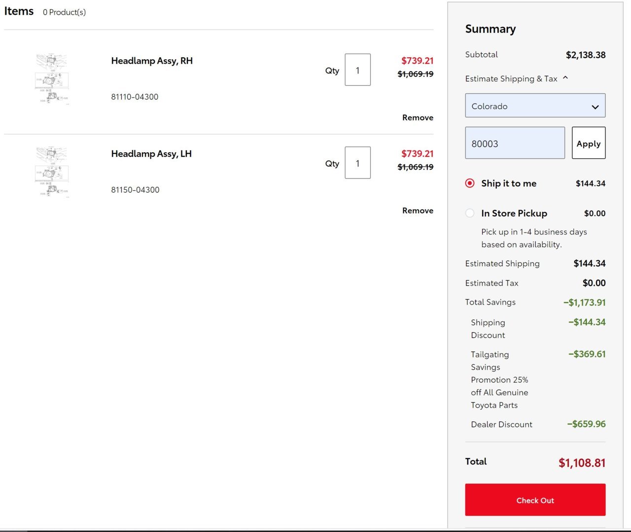

    Best I've seen since Presidents day 2022? Maybe 21? Of course that is pre-tax, but still a smoking deal

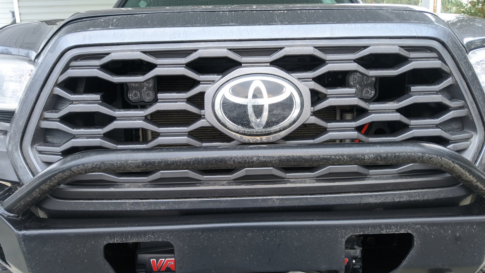

    The most useful mod on my truck are the Diode Dynamic SSc3 4K Pros with clear driving lens mounted as aux highbeams. They are behind the grill on a BAMF rack and I cut out windows in the grill for the lights.

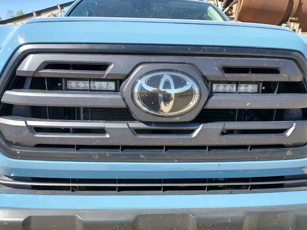

    I went a slightly different but similar route with mine. Twin Diode Dynamics 6 inch Stage series light bars. Like yours, in a driving pattern,hung using a BAMF mount and tied into the high beams. No cutting required and man do they light up the road. Should give me a better chance at spotting those deer getting ready to jump out in front of me.
