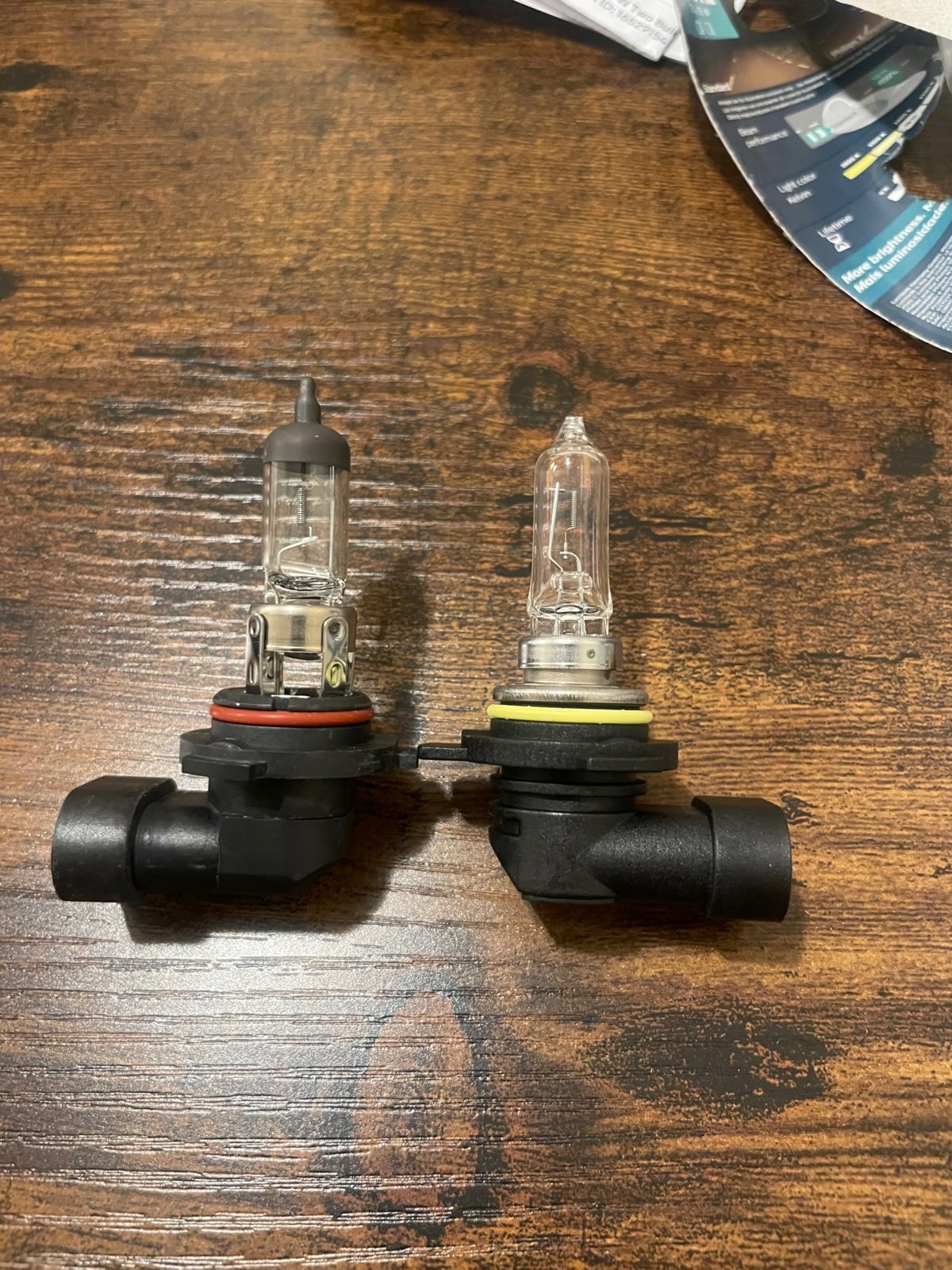

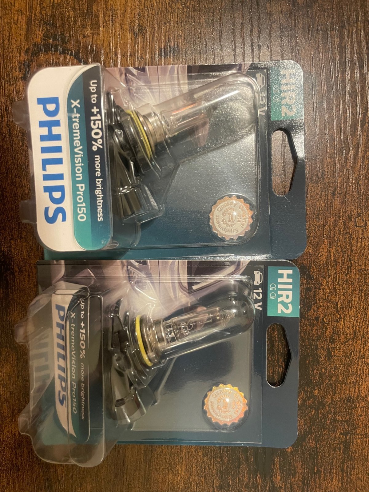

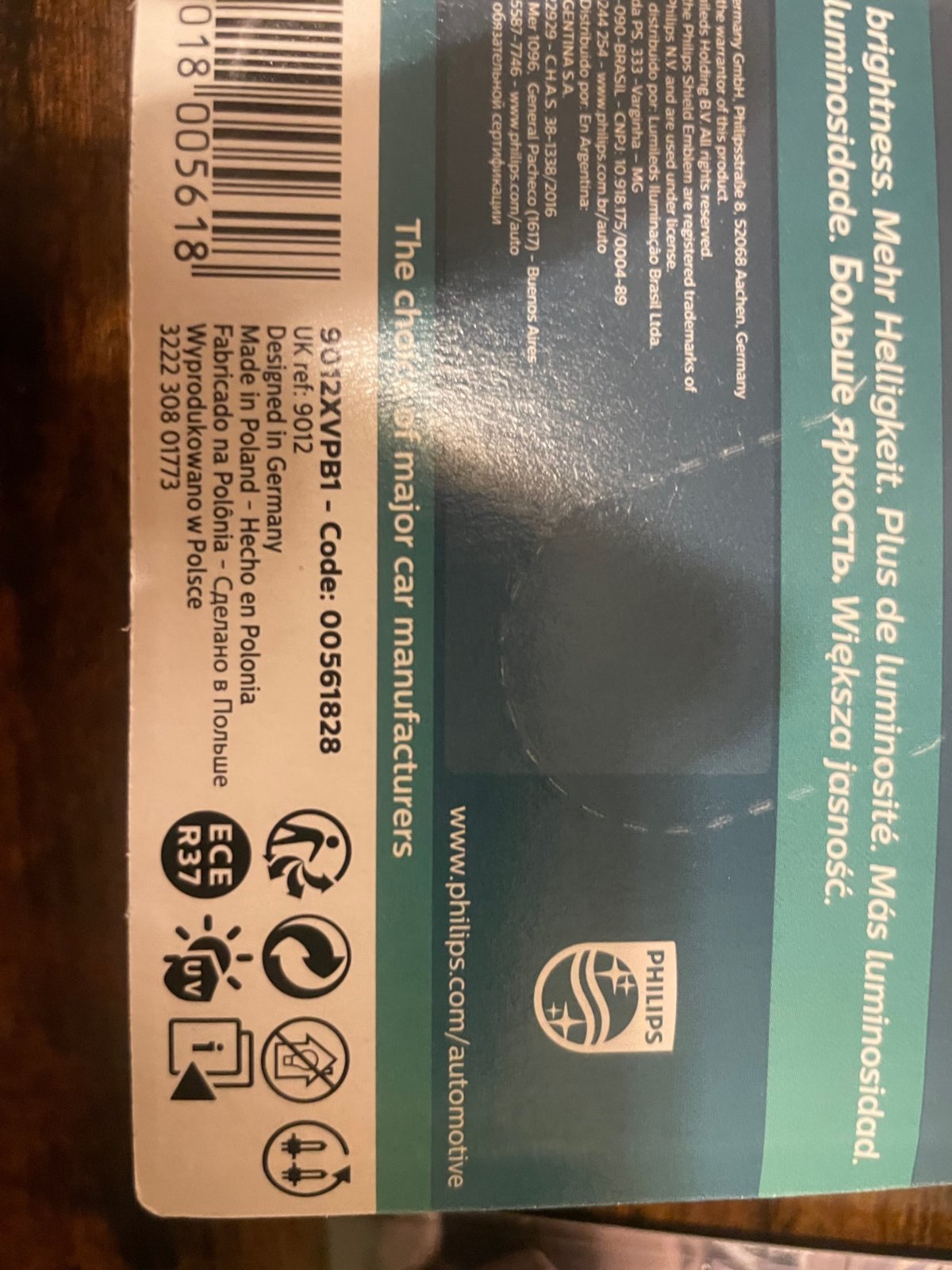

    I appreciate the offer but I would have to buy a new Volsa bulb too in order for it to be a fair comparison with both being new for output. I installed the Philips HIR2's over the weekend and anecdotally the light output seems better and a touch whiter than the Volsas. Packaging says designed in Germany, but made in Poland. I compared it to an old 9006 I had too when doing the tab modification. Impressed with them so far, may get a light meter to compare the two HIR2s just so I know from an analytical point since that's how my brain likes to work.
