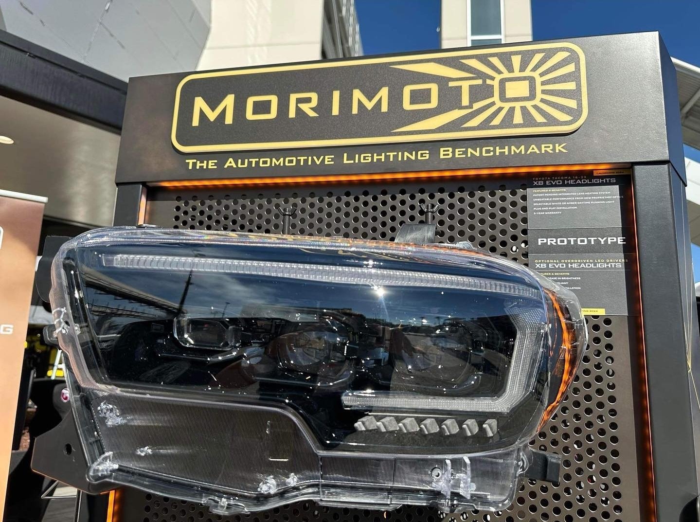

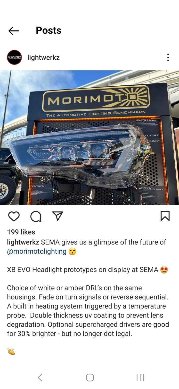

    I can't comment on factory Toyota, but Morimoto showcased a new set of assemblies with a heating element at this year's SEMA show.

    Toyota OEM LEDs will suffer the same outcome, no forward heat and failure to clear snow. The only one I am aware of is the one mentioned.
    Pretty excited to see these. TBD on heating performance. All other manufacture heated headlights and tails apply heating elements directly to the lens, the Morimotos as you can see do not. This means better optical transparency for more efficient light output, but also less efficient heat transfer which reduces heating efficiency and effectiveness for clearing snow.
