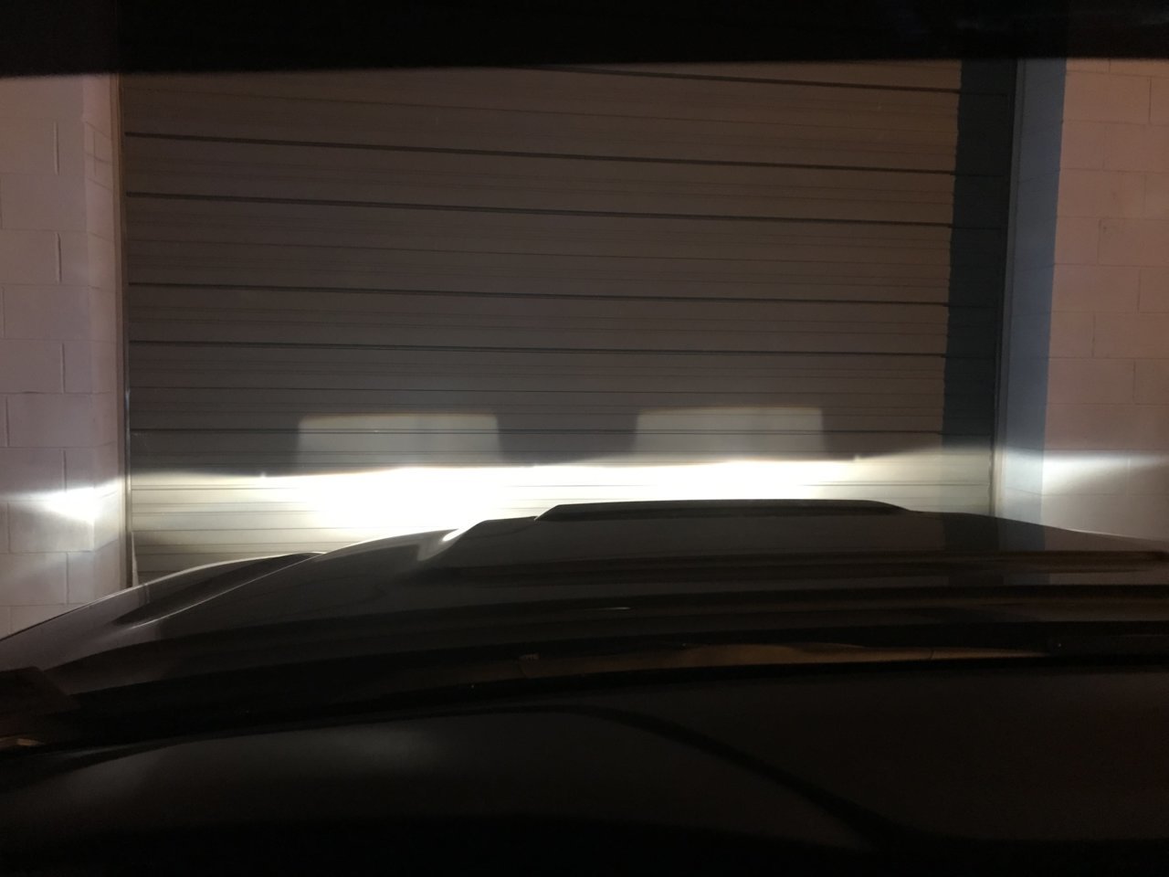

    Ummmmmm. Did I do something wrong? What’s with the blocks of light above the cutoff?

    Hahahahaha. Seriously? I did not know that

    Yeah well that’s how dim the stock headlight bulbs are by comparison!

    Yep, as mentioned the squirrel spotters were always there. The Hellas are just that much brighter that it is now much more noticeable. If you are further back from a wall it is far more diluted. Take it out on a dark road without ambient urban light and let us know what you think!

    Wow, thanks guys. I’m already impressed. About to take a drive on a deserted road and check them out.

    And yes, I couldn’t be more pleased with the Hella’s and Vosla’s. Huge improvement. When the lows are on, it felt like the stock highs. Lol. For the money, this is definitely the route to go. I’m stoked!
