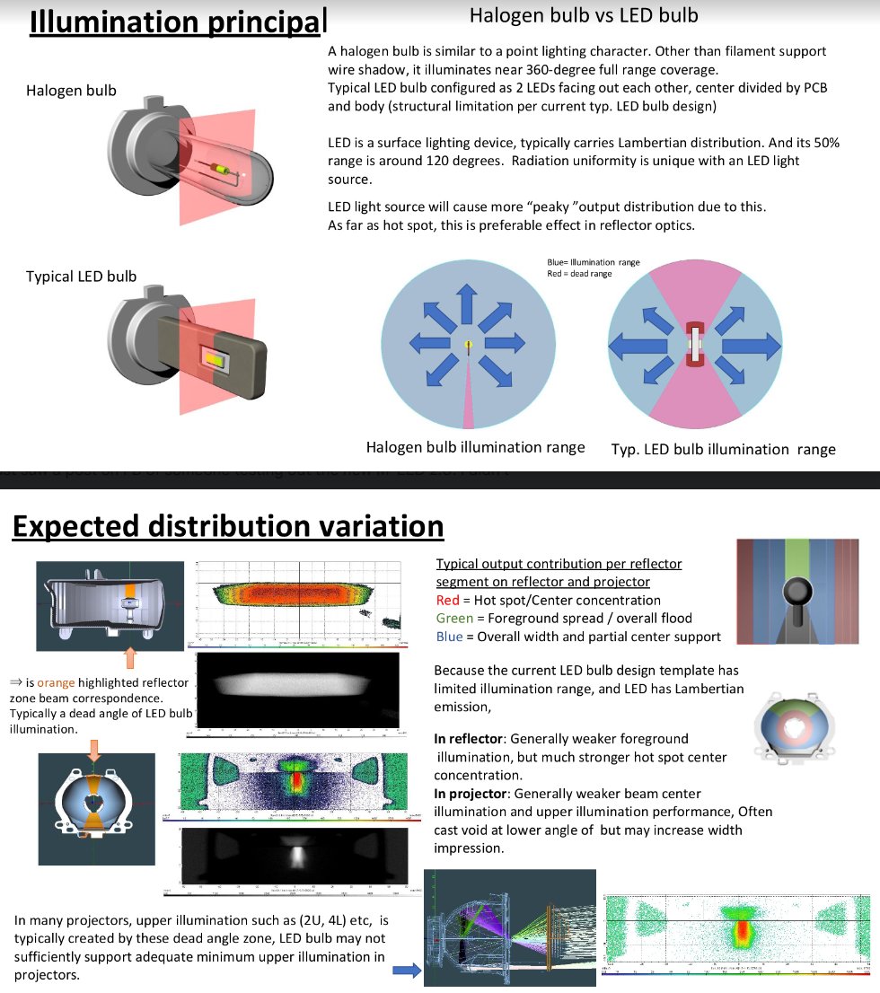

    Power rating 18~22.5W is because it starts at around 18W and stable at around 22.5W (1.3A @13.8V start up = 17.94W) that's the reason for wide power rating range in spec.
    One important message from me is,
    No, in Koito H11 projector being used in Tacoma, really not compatible. And do not recommend for projector use. it's just not beneficial, not taking advantage of its design.
    I gave explanation and Crash stated above. In projector optical design principals, hotspots are generally created at rear end of near bulb insert area. 12 o'clock zone is responsible for beam center intensity ( includes foreground center zone)
    Because chip size and position is so tightly configured, there will be no unintentional beam spread that can mask off nature of bi-directional LED
    Due to design principal difference between projector and reflector, there really isn't way to make projector user happy. Bi-directional LED configuration never can gain proper efficiency in projector. Some less refined larger chip bulb will show much smoother and higher volume output in projector, but this is because there is lot of unintentional accidental beam spread conveniently cover missing illuminance area.
    4.0 has least amount of unintentional beam spread = as a result, in projector, it become too lean not be able to mask missing illuminance zone.
    Since projector optical principal is not compatible with bi-directional LED config to begin with, my focus was spent for as proper as possible in reflector housing.
    When paired with reflectors, 4.0 will show strongly tight hotspot with least amount of glare. In some low beam reflector shows near compliance level of glare control, and not adding excessive foreground while substantially increase hotspot intensity
    Could I make LED bulb that works well in both projector and reflector? No, not to my standard. To give volume and smoothness in projector, it require intentional over sized chip, outside of designed optical beam spread. But doing so result in huge glare issue and weaker hotspot in reflector housing.
    reflector has much more positive compatibility with 4.0. Then my decision was to focus on optics that can take advantage of tech and design principal.
    Therefore,, It must be odd message from designer, but since I am with most information about 4.0 bulb, I am advising all here, 4.0 is not recommended in Projector usage. It's just not beneficial, type of optics isn't taking advantage of design.
    But do enjoy in high beam reflector. I have been using it in high beam nearly a year, very enjoyable high beam performance.
    I am checking reply time to time, feel free to ask me any questions, concerns

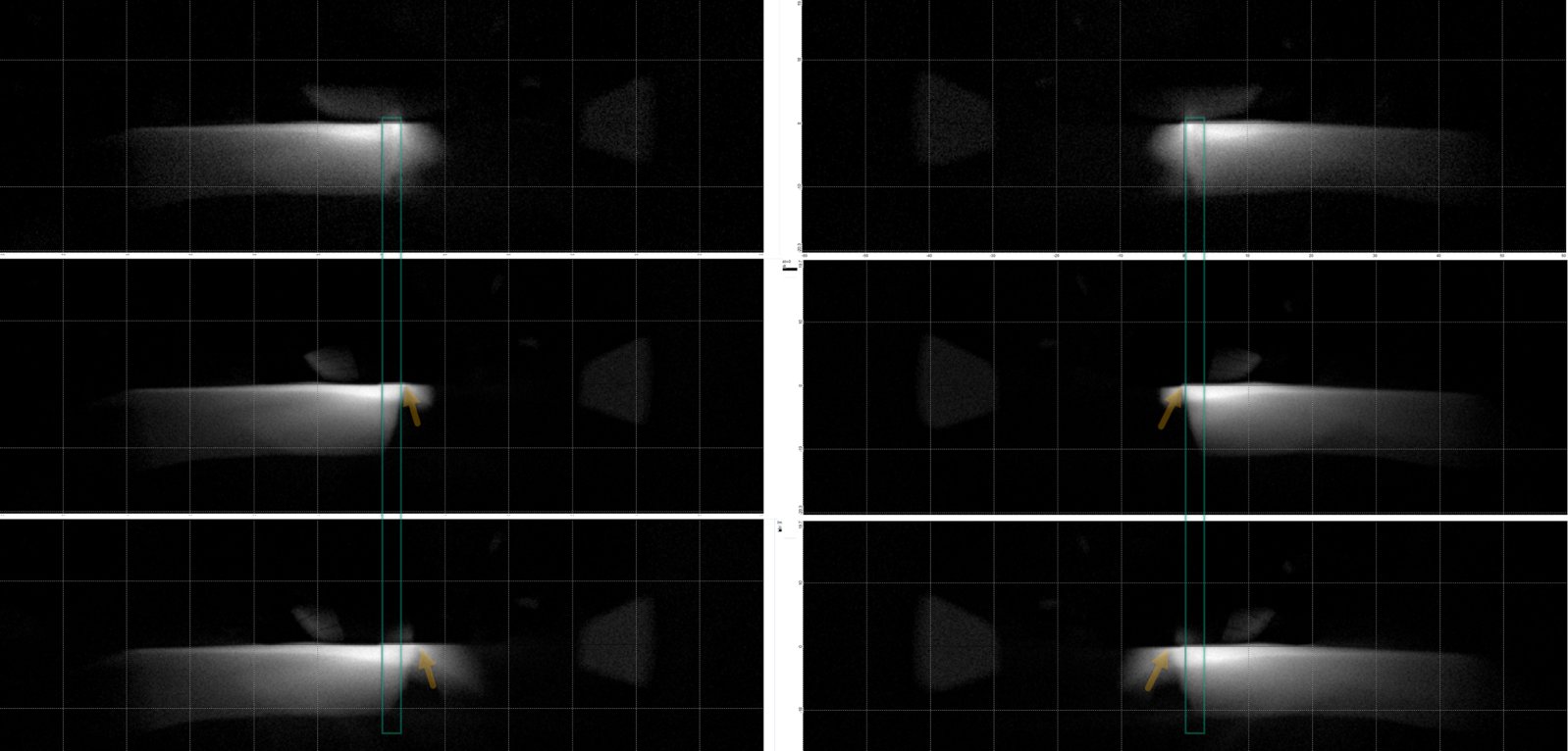

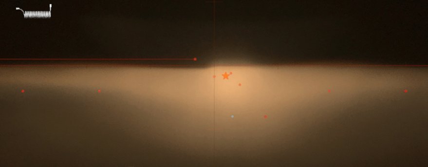

    No, it won't create better beam pattern. But it coincidentally may mask of unintentional beam distribution unintentionally Very hard to explain..
    @crashnburn80 If this type of optical study subject have better thread, feel free to redirect this.
    I don't have exact Koito H11 projector model, but I got Stanley H11, principal is similar, so let me use it to explain.
    In long story short, larger chip LED, and larger interval between emission surfaces bulb in projector create "loose" less focused beam split in right half and left half. Since it is loose and scatter some, it accidentally overlap in the middle. Result in higher center intensity by some of outside of intentional beam to be overlapped.
    From top, H11 halogen - 2st4.0 and SV4 as example. SV4 has bigger chip + also emission interval is much wider than 2st4.0
    What's happening here is
    Green box width shows filament diameter (1.4mm) projection region.
    Yellow arrow shows where each side of LED emission surface image starts.
    2st4.0 start beam pattern nearly just very slightly outside of 1.4mm filament edge zone, and triangle shade is "missing illuminance" 12 o'clock zone.
    Then look at SV4 ( bottom images), each side of beam pattern is offset ( this is due to LED interval is too wide) not creating intentional beam, starting much further out compare to H11 halogen or 2st4.0
    But, this conveniently going to cover "missing" triangle accidentally. Larger chip size also aid beam to be loose=larger, help incidental overlap amount
    So for the goal of having less missing triangle ( typically seen void at beam center bottom in many LED bulb used in projector), it is "convenient" for bulb to have NOT too tight intervals in between emission surface. This help make it look like beam is filled better.
    But never been intentionally and correctly filling.
    Here is right half and left half contrasting color assigned view.
    Therefore, more accidental overlap is conveniently covering each side of beam pattern's missing zone.
    And often, overlap also aid beam to have higher chance of gaining higher intensity stack at beam center, or larger/wider hotspot in projector.
    However!!!! The problem is chip size any bigger, or interval any larger than filament 100% result on glare in reflector application, and unintentional foreground intensity increase in projector housing.
    Make incidentally obtained higher peak useless by also adding foreground value.
    In here, this was my past study 2st3 vs SV4 vs Halogen Look at bottom image, that is actual photo record of Stanley H11 behavior
    peak intensity point also move way far down, adds foreground
    SV4 uses pretty tight sized LED, is 4.6mm x 1.49mm Even that size, it still shift hotspot this much, add foreground this much due to interval of emission also much larger than 2st
    Hope this explained why tighter tolerance LED configuration result in much lean, not filling beam in projector. It simply is nature of optical principal.

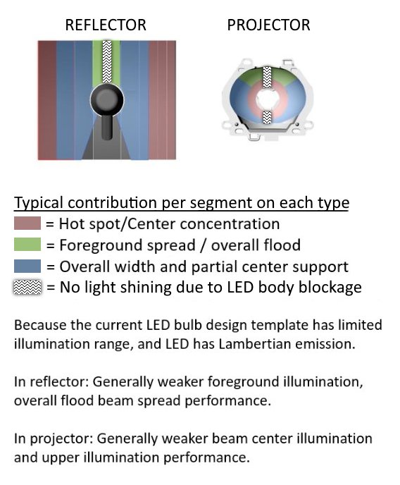

    To me, not much motive to create LED bulb do well in projector, because it still can't gain meaningful intensity boost ( the reason I said meaningful is because it also will add foreground)
    reflector has much more compatibility and design principal that can take advantage of tight tolerance emission.
    for LED bulb to avoid glare in reflector low beam, then it is absolutely critical to have as accurate and tight as possible emission config.
    Reflector uses far outer segment to create hotspot, direct above segments for foreground.
    LED bulb naturally has lambertian peak strength assigned to far segment = stronger hot spot ( it can be stronger than halogen, because unlike filament, LED has directional power distribution curve difference)
    Basically, selectively focusing available lumen into hotspot creating surface. Higher the lumen density chip has, exponentially higher hotspot intensity in general
    then, 12 and 6 oclock is not available in LED projector, which is responsible for foreground, tend to shoot less volume to foreground and this can be convenient for some application.
    However, once again, any emission size bigger than filament directly result in severe glare issue in reflector low beam.
    This is the exact reason LED bulb had been told, never use PnP in reflector, because it never had emission size as tight as filament, simple physics.

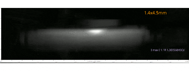

    Here is reflector optics and LED bulb study topic.
    This is generic low beam reflector sample I am using here, does not always validate all aspects identical way, but you can grab good amount of generalized behavior character.
    Hope this help many to make wise judgement what to try!

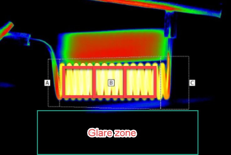

    First of all, halogen filament is very compact 1.4mm diameter, length about 4.5mm~5.0mm ish cylindrical point light source. Once of the reason LED never can replicate filament emission behavior is because LED is directional surface light source.
    To make LED work as close as possible to replicate filament, a lot of effort had made to make "identical" size chip, place at " identical position.
    However, this still does NOT mimic halogen emission character. Closer, but some pro and cons in different balance.

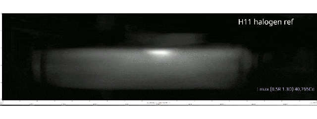

    In this study, I am using H11 halogen reflector low beam sample to simulate how each LED bulb character affects beam in what way.

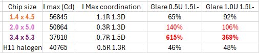

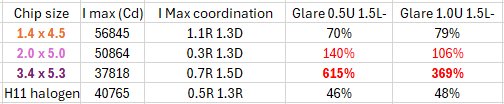

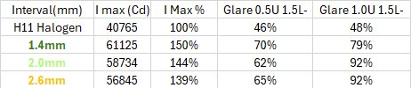

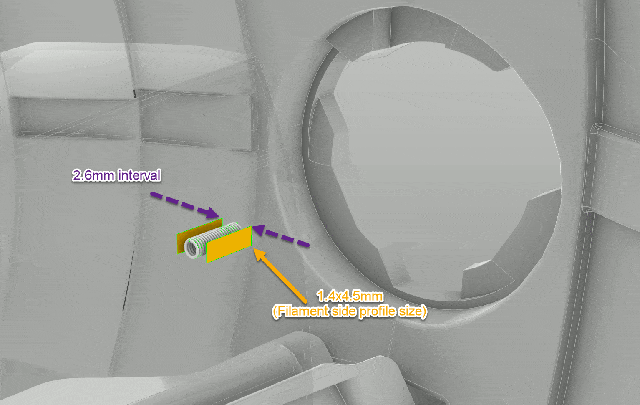

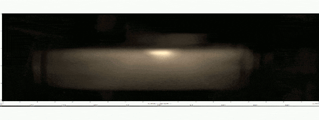

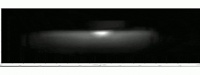

    1. How chip size affect beam quality
    LED chip size is CRITICAL parameter how well LED bulb regulate glare level. In short, larger the chips, exponentially higher probability of causing severe glare.

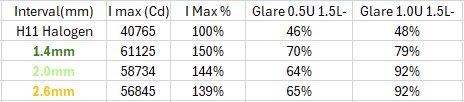

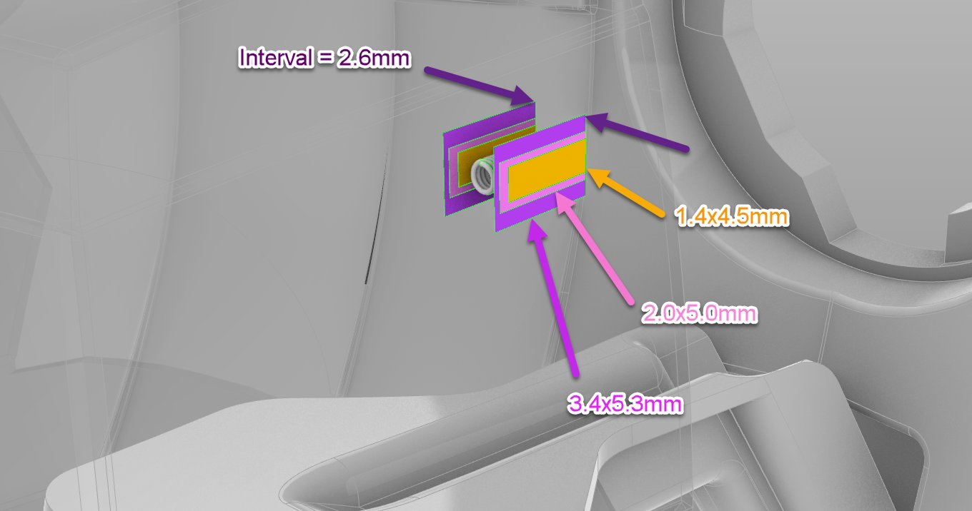

    Base LED bulb design for this study : 1.0mm PCB
    LED thickness 0.8mm each
    Total interval 1.0+0.8 x 2 = 2.6mm
    This is pretty common emission surface intervals for standard range of LED bulbs nowadays. Some are tighter, some are thicker, but this help to focus on chip size based behavior difference.
    3 samples are prepped
    1.4mm x 4.5mm ( identical to H11 halogen filament's side profile size)
    2.0mm x 5.0mm ( larger chip, some higher power LED bulb uses this range of emission size chip)
    3.4mm x 5.3mm ( out of question type, something like 6-die chip, 12,000lm!!!! type of chip)
    All 3 are se tot have 700lm per emission surface (total 1400lm) output
    base reference, H11 bulb also simulated at 1400lm
    Results were probably easily guessed.
    Larger the chip, more glare, less focused hot spot. Blurry cutoff, is our educated logical guess.

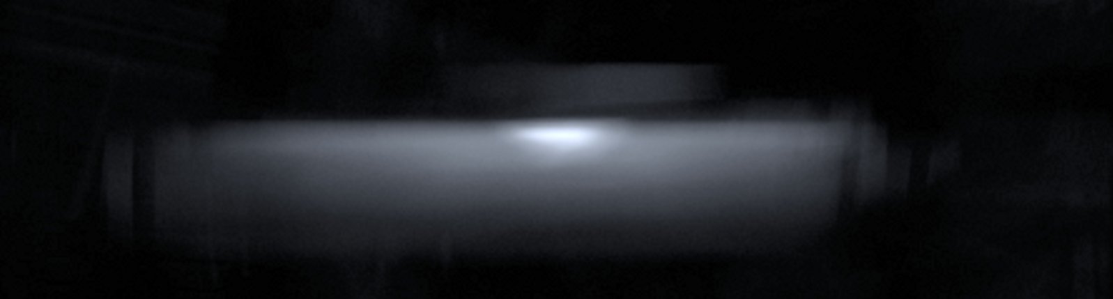

    Below are typical photo being posted online of " before after of LED bulb upgrade!!"
    Did LED bulb retain cutoff ? replicated beam reasonably ?
    This is huge beam quality discrepancy. Seeing visible brighter and dark edge does not define " cutoff" Some larger efficient reflector may shows rather distinct illuminance border, but do not mistake this as "compatible with LED bulb"
    This is image of "out of question" type super large chip LED model in comparison. 3.4mm x 5.3mm ( out of question type, something like 6-die chip, 12,000lm!!!! type of chip)
    Some may say, you can aim down, it still has cutoff. No that is not acceptable.
    By doing so, it will cause massive foreground value increase, making low beam output absolutely useless.
    Here is how chip size affected cutoff and beam proportion
    https://imgur.com/CQYgXZN
    Large the chip, more glare, and also less output focus. Loosing intensity while adding glare is most stupid configuration. Of course, they can add more lumen to advertise flashy numbers but that only makes glare far worse.
    This is explained by lumen density below.
    1.4x4.5x2=12.6mm^2 1400lm (111lm/mm^2)
    2.0x5.0x2=20.0mm^2 1400lm (70 lm/mm^2)
    3.4x5.3x2=36.0mm^2 1400lm (39 lm/mm^2
    This case is showing, even moderately smaller size chip at 2.0mm x 5.0mm is already showing glare.
    At filament side profile chip size, while it still within glare limit allowance, value is elevating. On the positive aspect, without hitting glare allowance limit, it increased hotpot intensity considerably higher than halogen.
    This is one of reflector optics and LED bulb's unique relationship. This indicate, when LED bulb is designed with strongly tight tolerance, even at identical total available flux.
    2. How intervals of emission surfaces affects?
    Now, we learned (or just re-confirmed) how critical is to have emission size as close as possible to filament. Next we observe using "identical to filament's side profile view size" chip
    1.4mm x 4.5mm model, but at different intervals
    First, we will look at How well it replicate if chip size is same as filament profile and, interval at filament thickness
    Pretty close? As I explained above, LED bulb in reflector tend to show less foreground with higher hot spot intensity
    https://imgur.com/AjDlqnl
    In this particular reflector, from identical total flux of 1400lm, LED bulb that has interval of 1.4mm demonstrated about 150% of peak intensity at hotspot, in exchange of reduction of foreground flood volume.
    https://imgur.com/9scoB5X
    This difference maybe difficult to observe in low res gif image, please go download link and see in full screen suggested.
    All of sample did NOT exceed glare allowance limit on two test points while gaining higher peak hotspot intensity.
    Main difference is focus efficiency, and some affect on glare region value. It is not glare issue at 1400lm config, but this data also is showing if bulb has more than 1772lm total flux, even at 1.4mm interval, it will start showing glare.
    3. Emission surface position accuracy influence
    So far, we learned it is critical to have chip size as close as filament, interval as close as filament diameter is the key to take advantage of reflector optics unique pro and cons relationship with LED bulb.
    However, one another aspect we can't forget is
    There always will be manufacturing tolerance, installation tolerance. especially many LED bulb now has "clock-able" rotating bulb base, this can give undesired emission position misalignment.
    Soldering emitters to PCB also will have reflow solder position tolerance.
    Such tolerance stack can be easily added up to +/-0.2mm
    And lower section is defined as "glare zone"
    Emission must be contained within tolerance box, high intensity zone must be well contained within B This is very important because any emission expand into glare zone(right below tolerance box lower line)
    In this case study, filament equivalent sized chip, but intentionally misalign lower by 0.2mm to see how badly it affects to glare
    Interval is set at commonly found 2.6mm in this case to highlight misalignment influence.
    https://imgur.com/iyhCKEd
    https://imgur.com/brWwA3g
    If emission surface is NOT accurately contained within tolerance box, and especially misaligned to lower than box, 0.2mm Y axis discrepancy was enough to start glare in this optics.
    Conclusion of study
    * Chip interval mainly affect focus efficiency, large the interval, lose hotspot. While it is desired to have minimum intervals, since reflector optics are generally larger, it is more forgiving to emission surface intervals.
    • Chip position accuracy is critical. 0.2mm to lower position caused glare even with chip size equivalent to filament side profile size of 1.4x4.5mm. 0.2mm tolerance can be very much possible with standard soldering position tolerance, bulb base to bulb shaft coordination accuracy, bulb base centering accuracy
    • Chip size had even larger influence to glare handing. Chip size at 2.0mm x 5.0mm already showing above maximum allowance of glare limit at 0.5U 1.5L-L and 1.0U 1.5L-L ( those two test points are evaluation point for oncoming traffic driver eye input)
    • Considering tolerance stack of soldering accuracy, bulb base centering accuracy/limitations, even at chip size of 1.4mm x4.5mm( equivalent to filament side view profile size) chip still carry certain amount of glare risk.
    To take advantage of reflector optics without raising risk of glare, LED bulb ideally shall have chip size further compact within tolerance box B
    This red 3 boxes are highest luminosity image of filament emission. This shall be target chip size and better glare control tolerance box.
