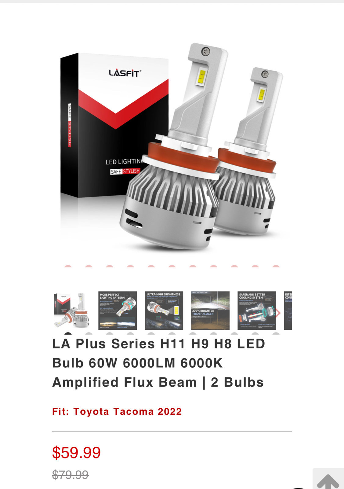

    These bulbs have work great for me. I see a big difference when riding beside a stock Tacoma with halogen lights. Even the LED pro headlights. That was one of the things I did to my truck when I first got it. Still have the same bulbs.

    And everyone in the opposite lane hates you for blinding them.

    In all the Facebook groups, everybody recommends those Lastfit bulbs…I’d really love to see some comparison and testing with them to show people how bad they are :rofl:

    don’t see how that would be. If the headlights are projectors and have a cutoff line.

    Go back two pages and read over Yoshi's posts.
    Then, rem9ve the led bulbs and install an H9.

    And the 300+ pages explaining why LEDs just don't cut it in projector housings.

    Yoshi just happen to be an auto ligjtning engineer. I trust his opinion more than a Facebook group.
    https://www.tacomaworld.com/posts/29733394
    From the link:
    "So far, no PnP LED bulbs ever achieved beneficial output in halogen/HID projector. Don't mistake marketer's 200% lux kind of non-sense. Showing random point of beam lux increase compare to halogen means absolutely zero value.
    Only meaningful if such intensity increase is found at identical coordination point as original light source (Halogen) and the rest of the beam also retain same proportion WITHIN acceptable glare limit."

    The first thing that you see is that given the design of these LED emitters that there is no physical way they can even come close to the design parameters of the halogen filament so they cannot possibly work correctly in a projector designed for a halogen bulb. Secondly, it's likely your eyes and perception are being fooled into thinking that overlighting the are immediately in front of the vehicle, where it's also easiest to see, is the same as actually putting usable effective illumination where it needs to be in order to actually drive safely at night. Third, just by looking at the output from your driver's seat, it's impossible for you to know just how bad these are going to be (and just how unsafe) in terms of stray light and glare light that tends to blind and distract opposing drivers. Do you really want to be one of "those" assholes on the road, and we've all seen them every time we drive - who thinks that having the brightest and most glare producing lights some equates with best? The best thing you can do is to toss those pieces of crap and put in either high performance H11 halogen's or a modified plug H9 halogen or better yet, spend the $1500 (cheap for the actual performance and safety they provide) factory OEM LED assemblies that really are some of the best and most effective lights you can get anywhere.

    im not here telling people what to do. I’m simply sharing what works for me. I’ve driven in front of my truck in a low car and I’m not blinded nor get any glare. That being said have blessed day.

    LED bulb usage in Projector is bit more forgiving to glare aspect, but depend on emitter size and position, it can result in glare above allowance max mostly at 0.5U 1.5L-L ( this is glare evaluation point for oncoming traffic at 50m distance.) Seeing cutoff looking bright and dark border does not define there is no glare. glare is only defined by measurement at specified test point. Most do not understand where is actual glare test point is and how glare is evaluated. Main issue of LED bulb usage in projector is terrible balance of distance illumination point and foreground point balance. It focus less at distance point, and create excessive amount of foreground. Combine of those two are worst combination to kill distance view balance. Most of opinion, or review praising LED bulb usage in projector is based on false impression of enhanced foreground illuminance, and lack of understanding of how badly excessive foreground value can affect distance vision balance. Let me give some extreme forcefully simplified example, just to explain how dominance area brightness impression affects the target illuminance impression. Probably many can guess already, chess piece of image top and bottom is exactly same grey level, only back ground is different. Think chess pieces are target(distance view focus area), and surroundings are foreground. If we consider our field of view as 2D image, then foreground zone really dominate most of the illuminated area impression, however what we naturally want to focus is way beyond that range. To do so, regulation limit foreground illuminance. Very hard explain,, because it's not like driver can't see distance at all, driver will still be able to see IF massively focus singular distance point. many LED bulb user fell for this confusion, basically impressed by how bright/ample the foreground illuminance impression is( because foreground zone is dominating visual field volume) and process it as I got lots of light now. But problem is forgetting about where driver supposed to naturally focus on. Or not understanding how severely affect subconscious level view focus comfort balance.

    As others have mentioned, the reason you see a big difference when you are sitting next to a Tacoma with the LED headlights is not good. The difference you see is excessive foreground light caused by lack of focus of the pnp LEDs in a halogen projector, causing a loss of distance light, which while it looks brighter from the driver seat it is not brighter in the right location. It is more harmful than helpful and shifting to short range foreground light looks brighter on the ground, but at speed that is easy to outdrive your headlights. And the increase in foreground light makes it harder to see distance at night, compounded by the fact you have less distance light due to the loss of focus. So while it seems you have made an improvement since people judge light by what is closest too them as it has a bigger visual impact, you have actually made it worse.
    Lasfit is an IP theft company. I reviewed one product and it was comically poor. On principle I will not review companies products that engage in IP theft. You can read more details and the review in post #370 of the SAE J581 thread.

    And yet, their influence is unbelievable, almost inescapable. I can't count how many times Lasfit is recommended when someone asks for bulb recommendations. No matter how many times I reference this thread, I can't convince them to backtrack. In the an 11th Gen Civic forum, some said they were disappointed with their factory reflector LEDs (which are rated "Good" by the IIHS), compared to their 10th-gen fitted with Lasfit bulbs.

    They sell really big on Amazon, which tends to be the dumpster fire of automotive LED lighting products. People wanting to believe that cheap $30-50 PnP LEDs will give them OEM LED headlight performance or better, perpetuated by misguided Amazon product reviews by people that have no idea what they are talking about and reinforced by non-reputable companies falsely advertising product performance. Unfortunately consumer confirmation bias is very real, so rather than seeking to actually understand they just perpetuate the cycle of pushing garbage.
