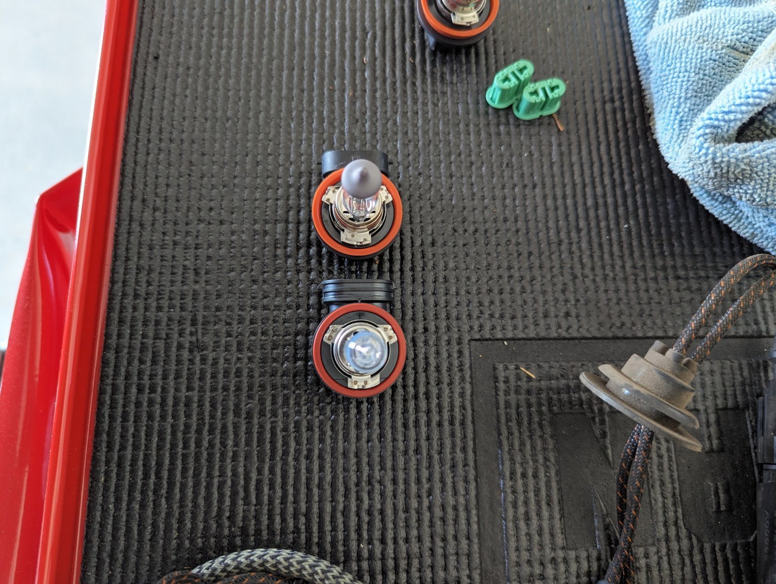

  5. May 20, 2024 at 7:59 AM
    #6665
    Yoshi I
    Yoshi I Well-Known Member
    May 10, 2022
    #396897
    119
    Yoshi
    it's not Philips H9 is out of spec, H9 is different from H11. Top is H11 ( with ceramic paint shade at bulb top) and bottom is H9 without paint. Main top base tab need to be trimmed to match H11, and also input socket, connector locator ribs need trimming to fit.
  6. May 20, 2024 at 8:27 AM
    #6666
    daveeasa
    daveeasa FBC Harness Solutions
    May 14, 2020
    #328079
    7,479
    David
    PNW
    2016 Tacoma OR DCSB 6MT, 2005 RC 5MT PreRunner, 2002 Tundra SR5 RCLB 4x4
    It’s worth reiterating that for 3rd gen Tacoma, no base plastic tab trimming is needed. Simply remove the green insert and it plugs right in.
    The metal rib / tab / fin is the one which I trim to match h11 as it makes insertion much easier. Not 100% mandatory but worth the 30s effort. Flush cutters make quick work of the job and it’s pretty obvious where to cut. I usually score more than cut and then flex to snap, makes for a slightly cleaner edge than pure cutting does, at least for me. Also ideal to avoid multiple snips as that’s what can lead to thin shards which might then separate, potentially inside the housing.
    Lots of mods look easier than they are. This one is even easier than it looks and very satisfying.

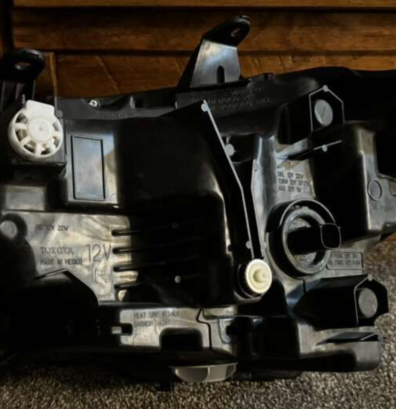

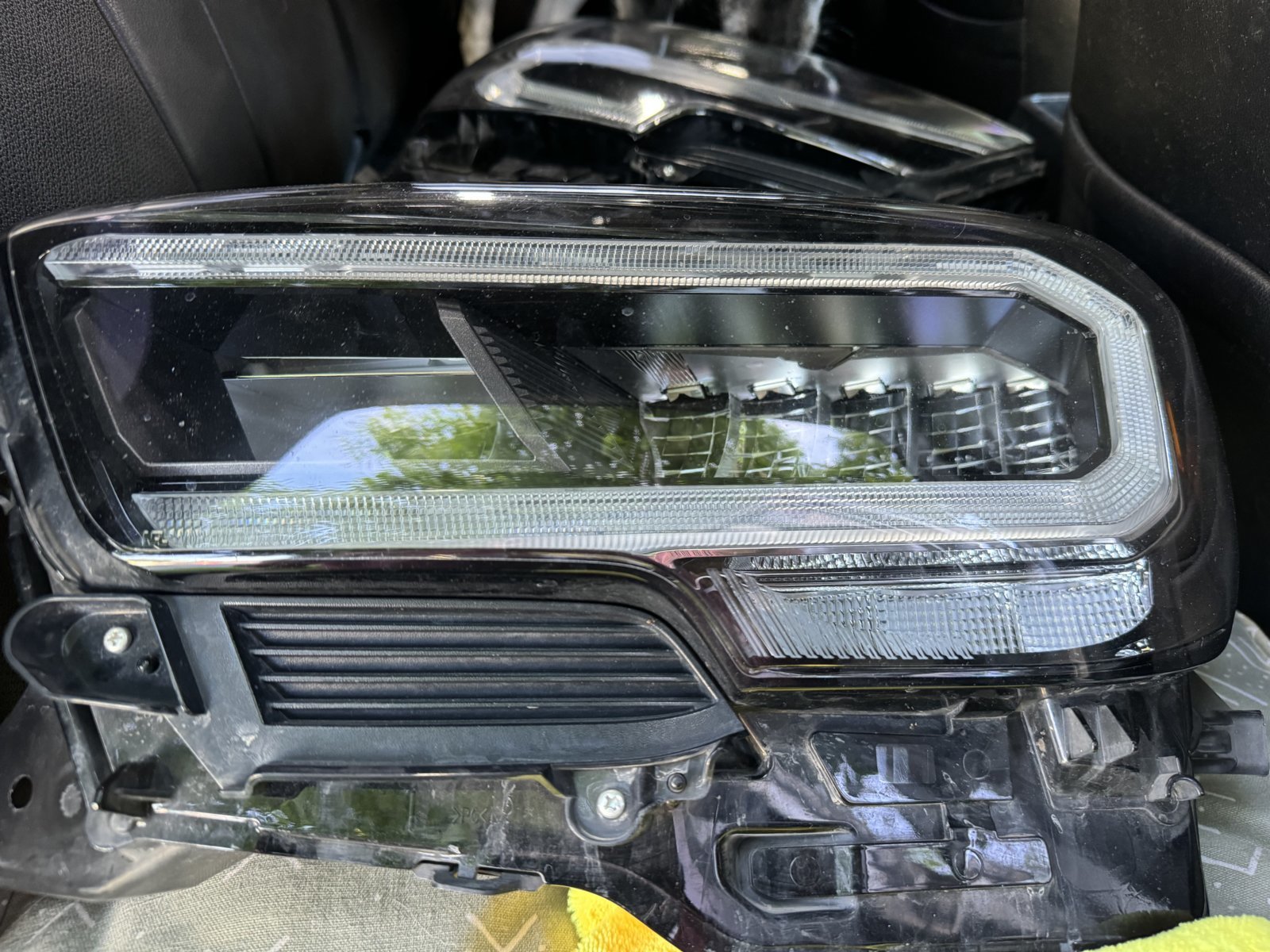

  7. May 21, 2024 at 6:57 AM
    #6667
    Technique
    Technique Well-Known Member
    Nov 4, 2017
    #235046
    2,927
    Alex
    Utah
    2017 Silver Offroad DCSB
    -285/70/17 Toyo AT3 -Tuned
    Is there a surefire way to identify an OEM LED headlight? I found a pair locally for $500 total...but I need to verify they are legit OEM lol. I could toss my H9s out!
    from the pictures it looks like they might be actual OEM…idk though.
    PapaRee likes this.
  8. May 21, 2024 at 10:33 AM
    #6668
    McPickle
    McPickle IG: @ThatTopoTaco
    May 7, 2022
    #396669
    463
    Dillon
    East Valley, AZ
    2019 TRD OR DCSB in MGM
    I think you can count the reflectors. I remember seeing the copy cats have more reflectors than OEM. Not sure where I saw that info specifically but I'm sure Crash knows
    Technique likes this.
  9. May 21, 2024 at 6:23 PM
    #6669
    Technique
    Nov 4, 2017
    #235046
    2,927
    Alex
    Utah
    Well, they looked legit enough to me and I bought them! Going to order the harness from @daveeasa now and hope that the lights actually work lol.
    stoked to have hopefully the best performing led housing out there!
    daveeasa likes this.
  10. May 21, 2024 at 6:24 PM
    #6670
    daveeasa
    May 14, 2020
    #328079
    7,479
    David
    PNW
    Photos looked legit to me. Some people don’t realize what they cost.
    musicisevil likes this.

  15. May 21, 2024 at 9:34 PM
    #6675
    crashnburn80
    crashnburn80 [OP] Vehicle Design Engineer
    Jun 6, 2015
    #156893
    14,772
    Kirkland, WA
    2003 DCSB TRD OR
    The copycats used to have less reflector buckets than OEM, meaning less emitters. However there are now some that use the same amount, though their output is significantly worse and doesn’t compare in the slightest, even though at first glance they look the same.
    Those units look to say Toyota and made in Mexico on the back. All copycats are going to be made in China and not stamped with Toyota branding.
  16. May 21, 2024 at 9:35 PM

  20. May 24, 2024 at 12:49 PM
    #6680
    Technique
    Nov 4, 2017
    #235046
    2,927
    Alex
    Utah
    I no longer have to wait for a “good” LED for the halogen housing. My $500 OEM headlights work great! Stoked to test them out tonight in the dark.
